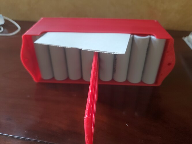

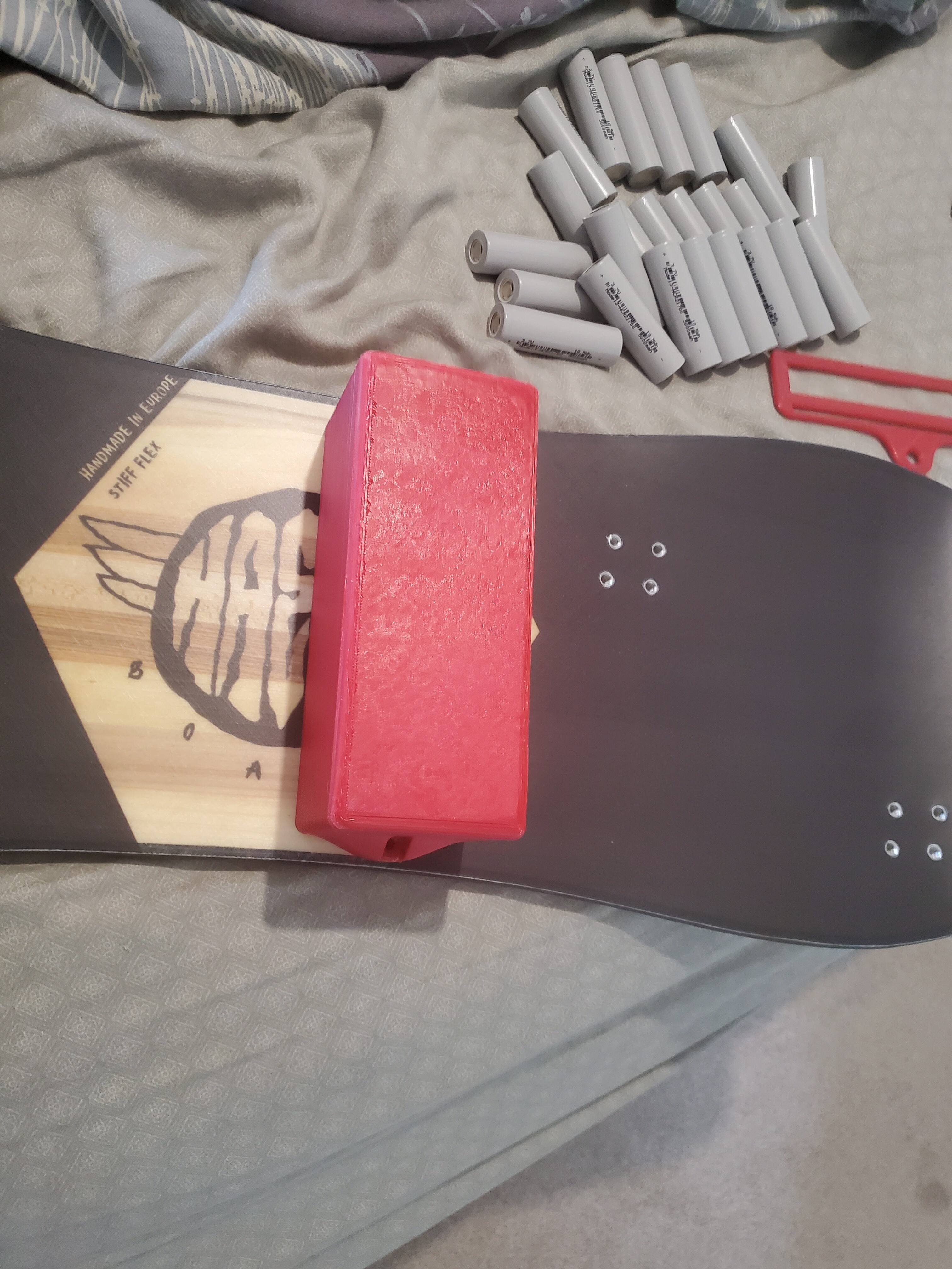

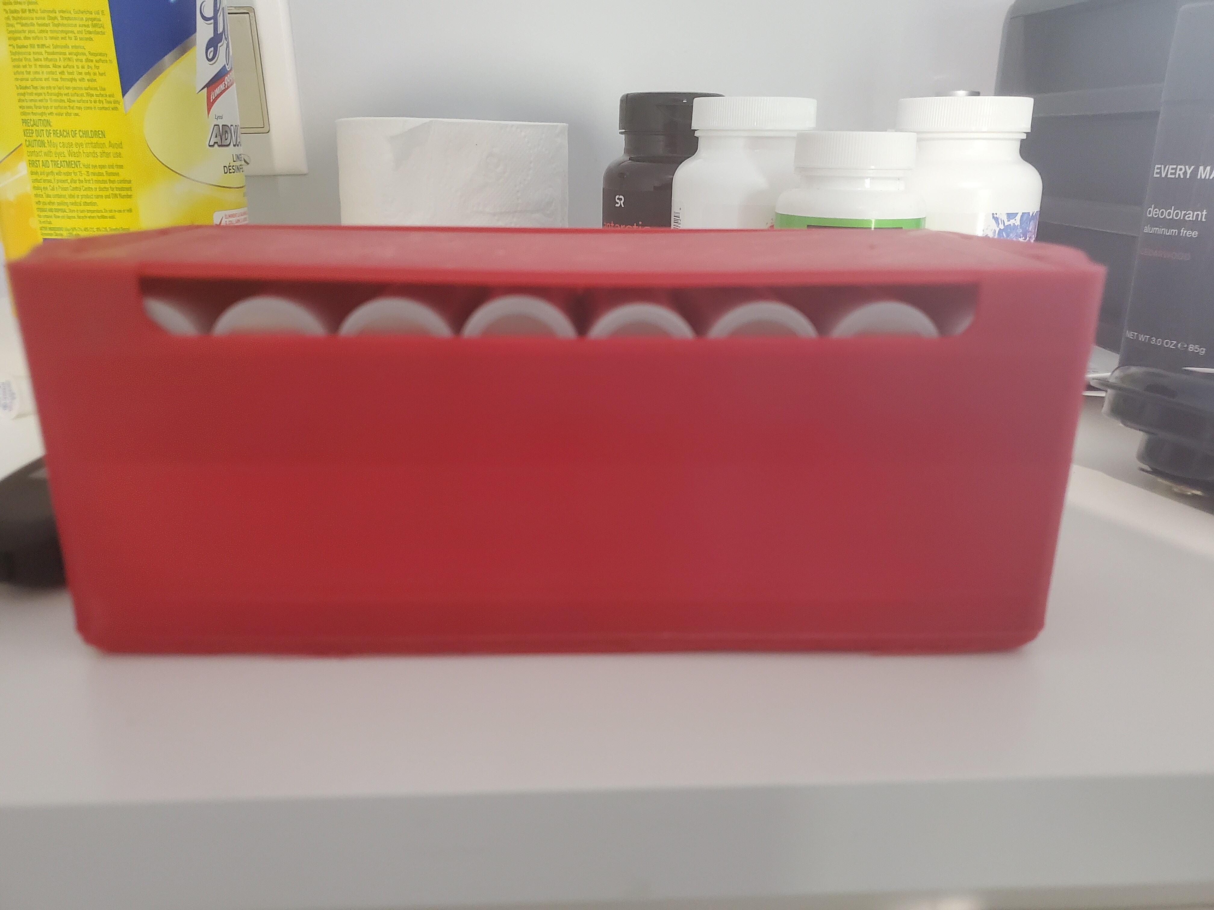

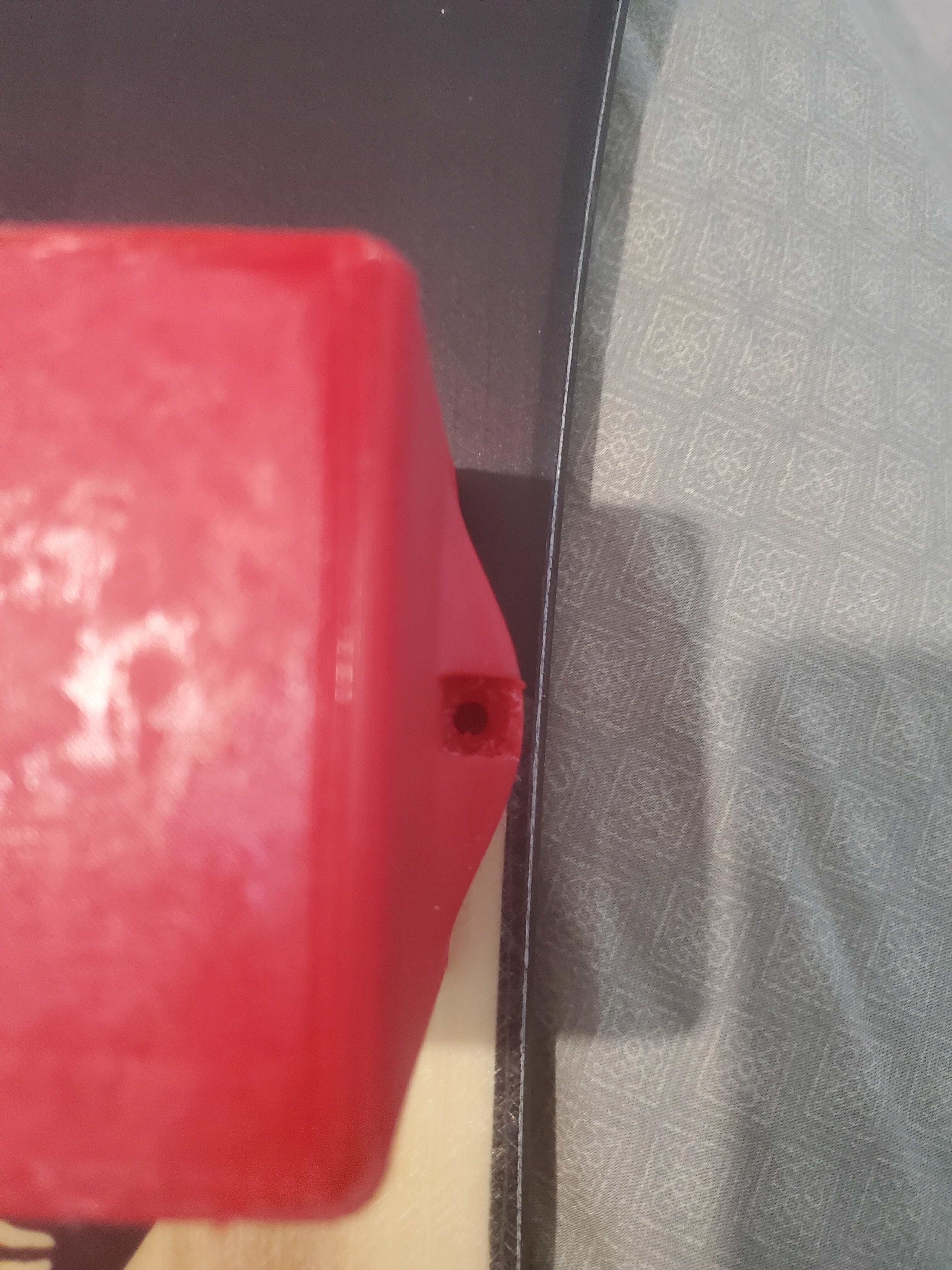

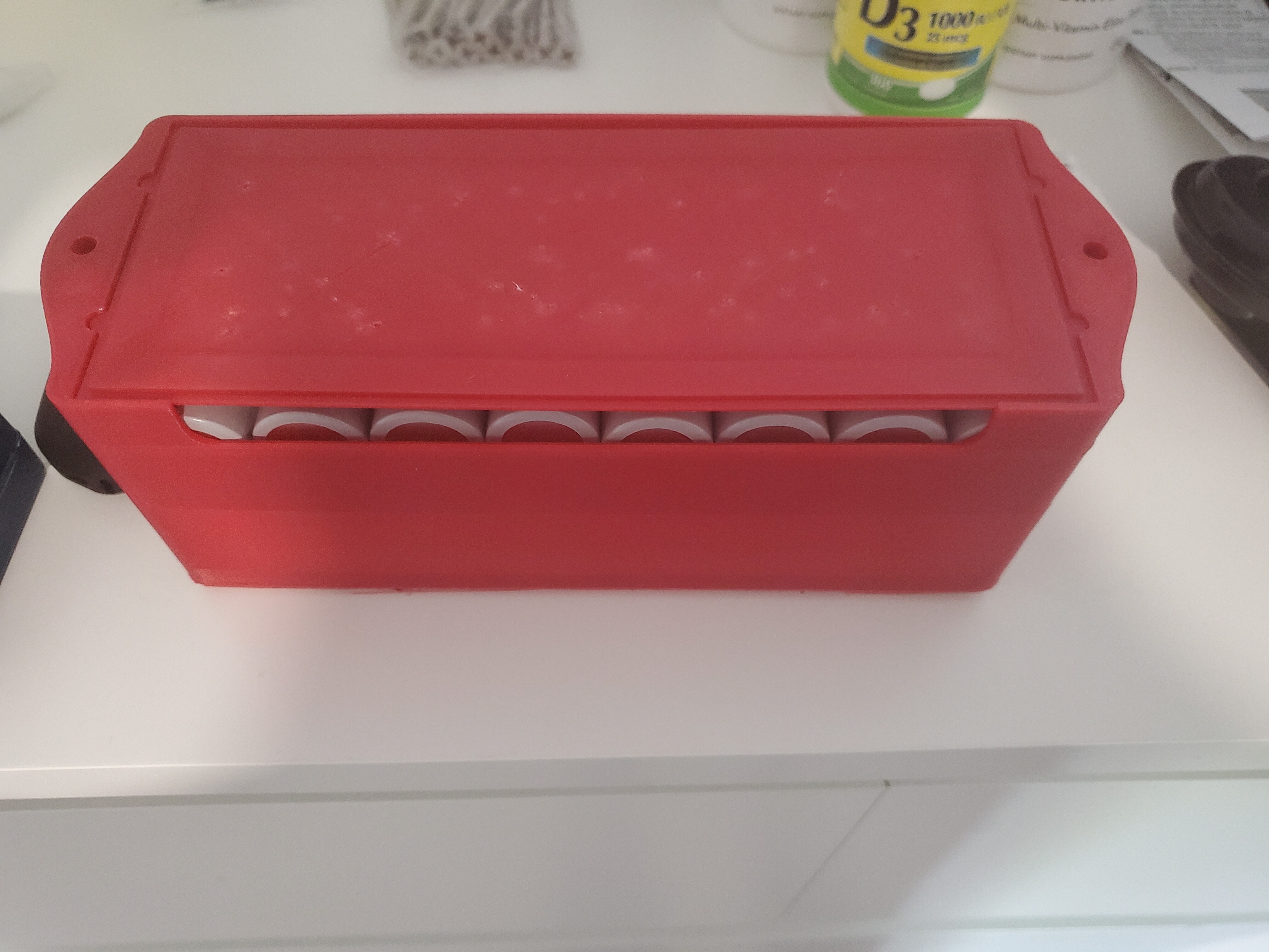

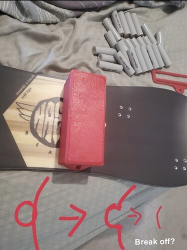

Here is my enclosure. The middle of the deck is the narrowest. It it okay that there is only 5mm of room on the edge of the hole or would it ruin the integrity of the deck with it being so close to the edge? I have very little room but maybe I can make the holes more inward.
How are you planning to weld nickel and solder series connections on those boys when they’re in there so tight?
I think you may be underestimating how thick nickel ends up being
I have 2mm of room. I estimate the double stack 0.2mm will take up 0.5mm each side so 1mm and a little extra tolerance → 2mm. Is that enough?
Where are your balance wires and series wires going to go?
There will be a fold of nickel that goes on top of the cells. I will adjust the height of the enclosure if more room is needed. I added a cover that I will add caulking to seal the battery (indented lip around the cover). The gap in front is where a connector will go in between these segments for the series and balance wires
I dont think you are going to have enough room for the nickel fold and solder connections, but I could be wrong.
Just make sure that your folded nickel is not being pressed into the cells when it’s all sealed up, otherwise you are creating a point that may cut/wear through your insulation and short against the cell.
Thank you for the warning. If I feel there is too much pressure when adding the cover then I will remake the segment with more vertical room. My question was with the holes going into my deck. Will it ruin the deck because it’s too close (5mm) to the edge?
I think it’ll be fine, most forces will be downwards, not to the side. But what material are you making your enclosure out of? Gotta be pretty strong to hold that many cells.
If grabbing your enclosure by both ends and shaking it with the cells inside is enough for it to snap, then it will 100% snap while riding.
I concur with rusins. two screws for that many cells in that shape, in a 3d printed enclosure, seems like a recipe for disaster.

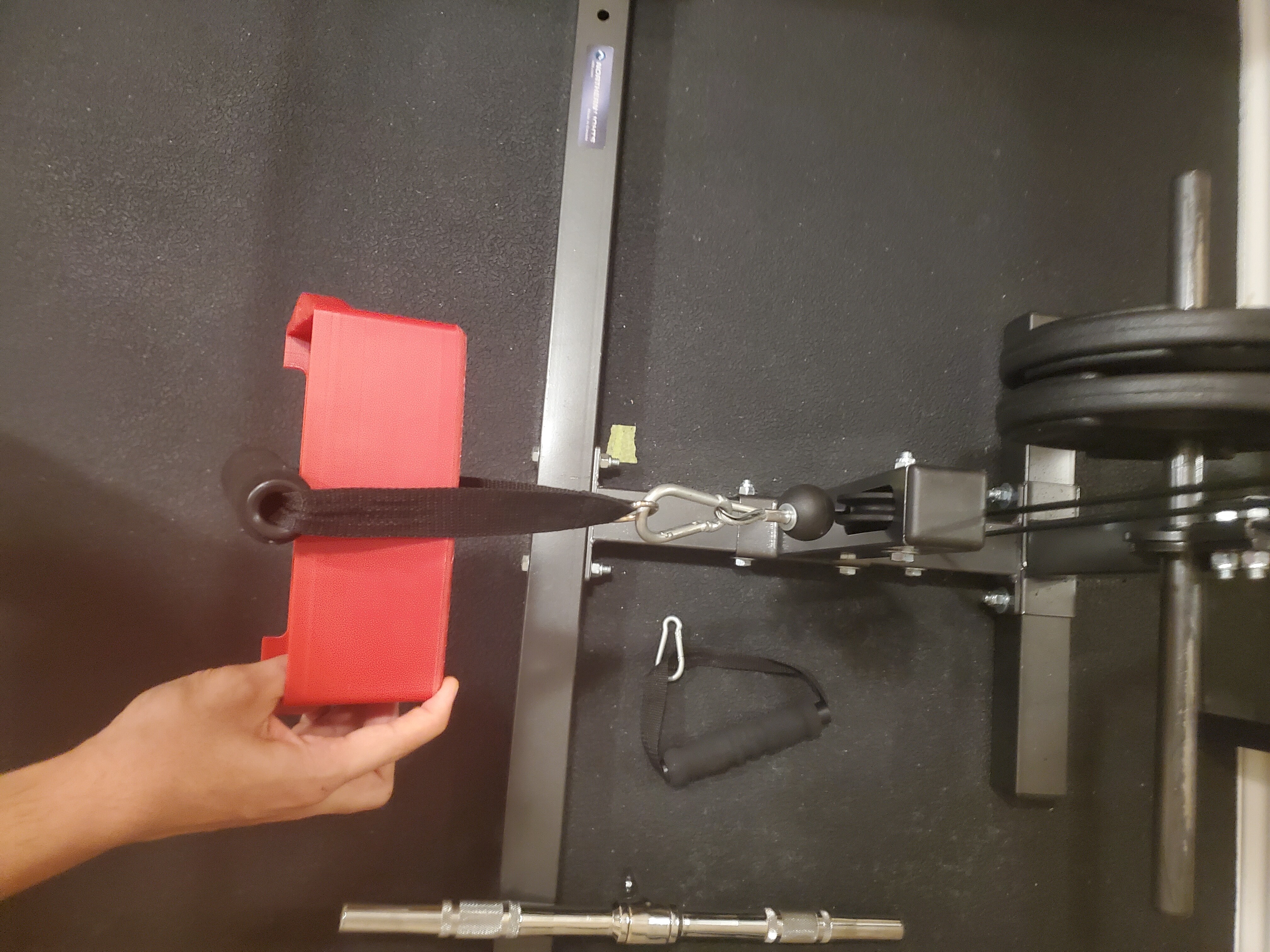

Our enclosures have to be able to withstand the equivalent of picking up the board and repeatedly bashing it enthusiastically on the ground (wheels down), with nothing breaking.
The G-forces from vibrations and bumps are ridiculous. 10G is commonplace, and 100G+ is not hard either.
It’s not enough

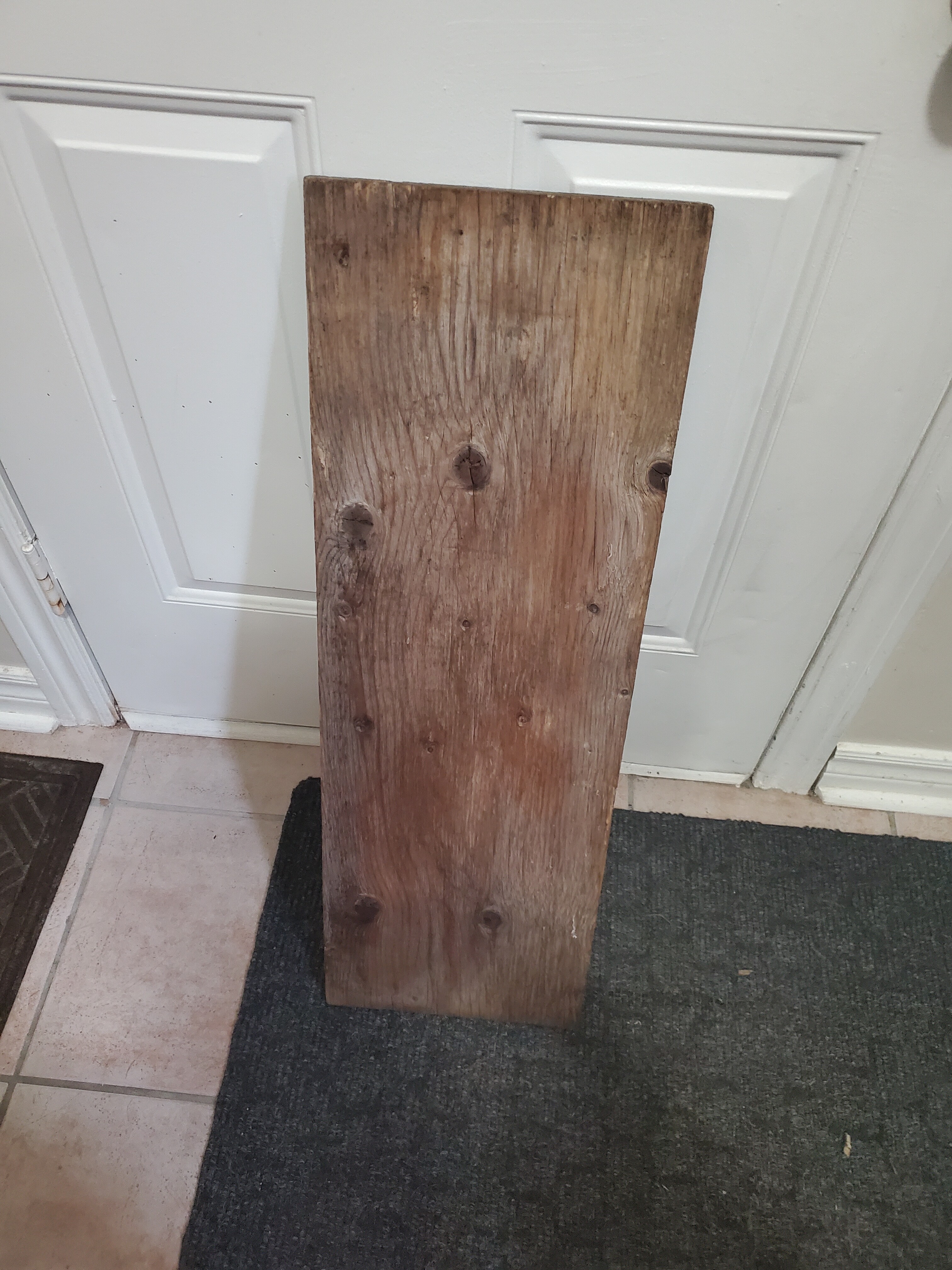

I tried it. Does nothing. Tried braking the other prototype by hand with empty (squeezing the walls together) and I cannot break it. It is able to withstand 20lbs with me swinging the enclosure back and forth while holding onto the screw holes. While the cells are 4.5lbs
Still not enough IMO. Load one up with dummy weights equal to that of your cells, mount it to a wooden plank, stick a pair of trucks on one end of that plank and make like you’re trying to use the trucks to pound a railroad spike.
If the enclosure doesn’t fail after ten hits, then I’d sign off on it.
I have this plank. It’s okay? I don’t have trucks yet (matrix ii out of stock atm) but I will make something so I can bang the ends of the board simultaneously. Like a gap between two level platforms
