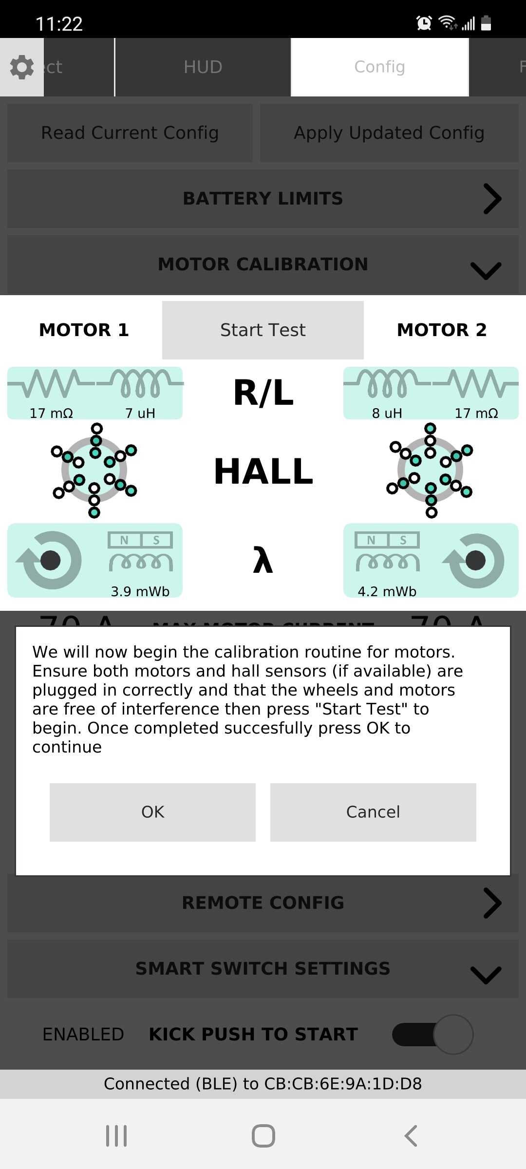

i reuploaded the firmware… still 5.02.
first time, detection failed.
second time. ran detection, both came up sensored.
the direction step worke.
the remote step worked.
and then nothing.
remote would not spin the motors.
after it turned off, and I just went and turned it on again, the remote works, both motors spin in the right direction. and sound normal.
sooooo yeah. i feel great about this.
i also discored the downside of not using a power button… it is not great for trouble shooting cause i can;t just turn it on and off.
so, now i want to figure out how to get 5.01 back through the app…
have you sorted that out? i don;t want to break out the PC… not wanting to open the enclosure today.

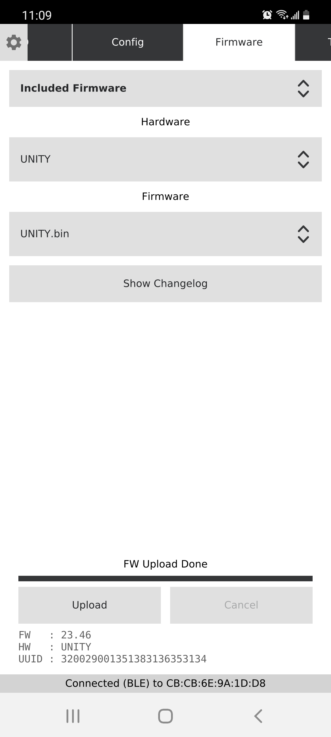

Finding FW 5.01 for the phone was too much for my short patience today…
So I opened up the Enertion app.
Uploaded the firmware.
And voila…
Shit seems fine
Ran the set up 3 times and all times it ran fine.
Sounds fine…
Felt fine going up and down the garage.
So. Throwback Tuesday…

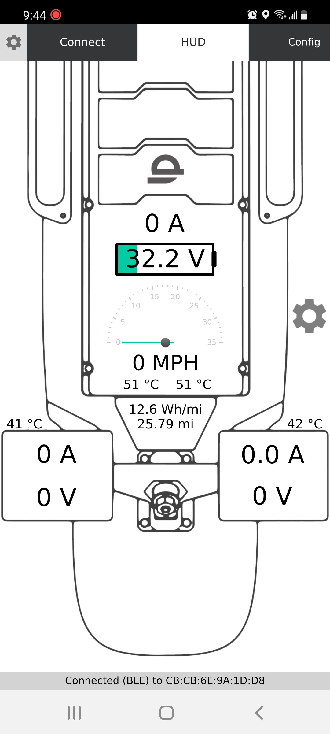

Honestly 23.46 has been the most solid firmware for me by far
Are you running it now on any boards?
I have not had any beef with vesc… So I had converted all my Unities over…
I do like to see the wh/mile…
And on a couple boards I’m running smart reverse.

On the driveway the remote works. But then stutters…
So I grabbed the Demonseed and went in it.
Came back and ran detection on the Flux.
And failed detection…
What in the actual fuck…
It was fine the other day nothing has been done to it.
Tried running detection a few times and sometimes it said -11 for the reason and sometimes not.
The Flux has a Unity on 5.01 firmware…
So I decided to do the same I did with the Omakase.
Broke out the enertion app.
Installed the software.
Ran the set up…
And everything seems fine.
So what the actual fuck vesc tool…

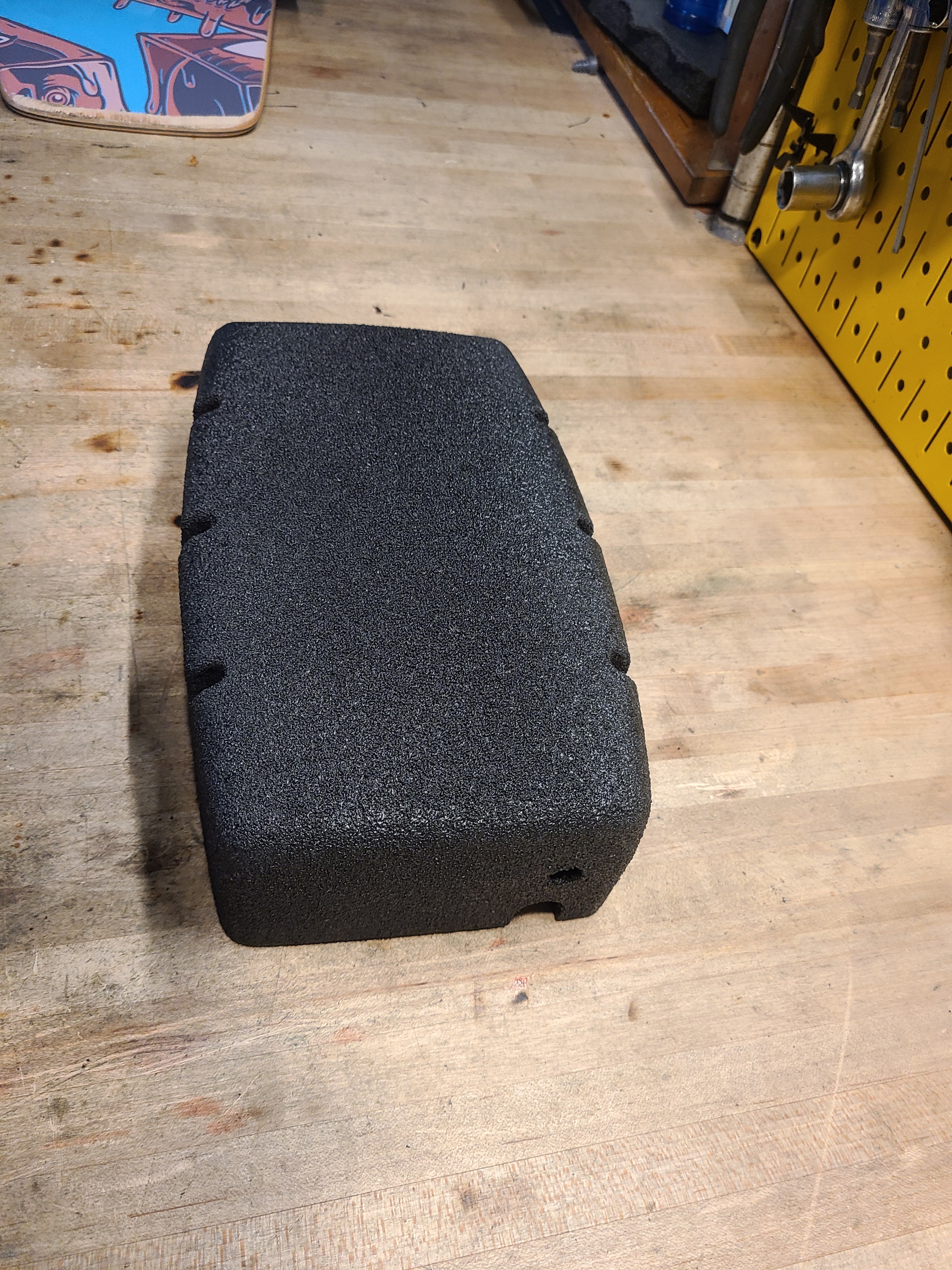

Can you tell me what made this gorgeous texture on the print ? Looks great
thanks dude.
it is truck bed liner spray.
I love that stuff.
the one that I like best, is the Krylon.
i have used it on a ton of my enclosures, and on a couple deck bottoms…
