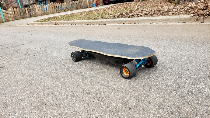

So next up to scratch the itch I wanted to jazz up the Spud.
So the Spud which was supposed to be all old parts ended up getting a Flipsky a new 6374 and the Fsesc 6.6 plus. And a sweet 3d printed enclosure I’m super proud of.
Orange paint job looks good on pictures but is actually a huge fuck up…

Here is the other board I rode yesterday and just got done building a couple days ago. This one is just going to be for towing the kids. It has the crappy Diyeboards 10s5p. Dual Maytech 6374s with one bad sensor… And a Unity that was doing weird shit so I’m scared to really use. It actually managed to move with me at 230 lbs and the kids plus wagon at 90 lbs.
Thanks for turning in.
Go ride now!FB_IMG_1568854973751
