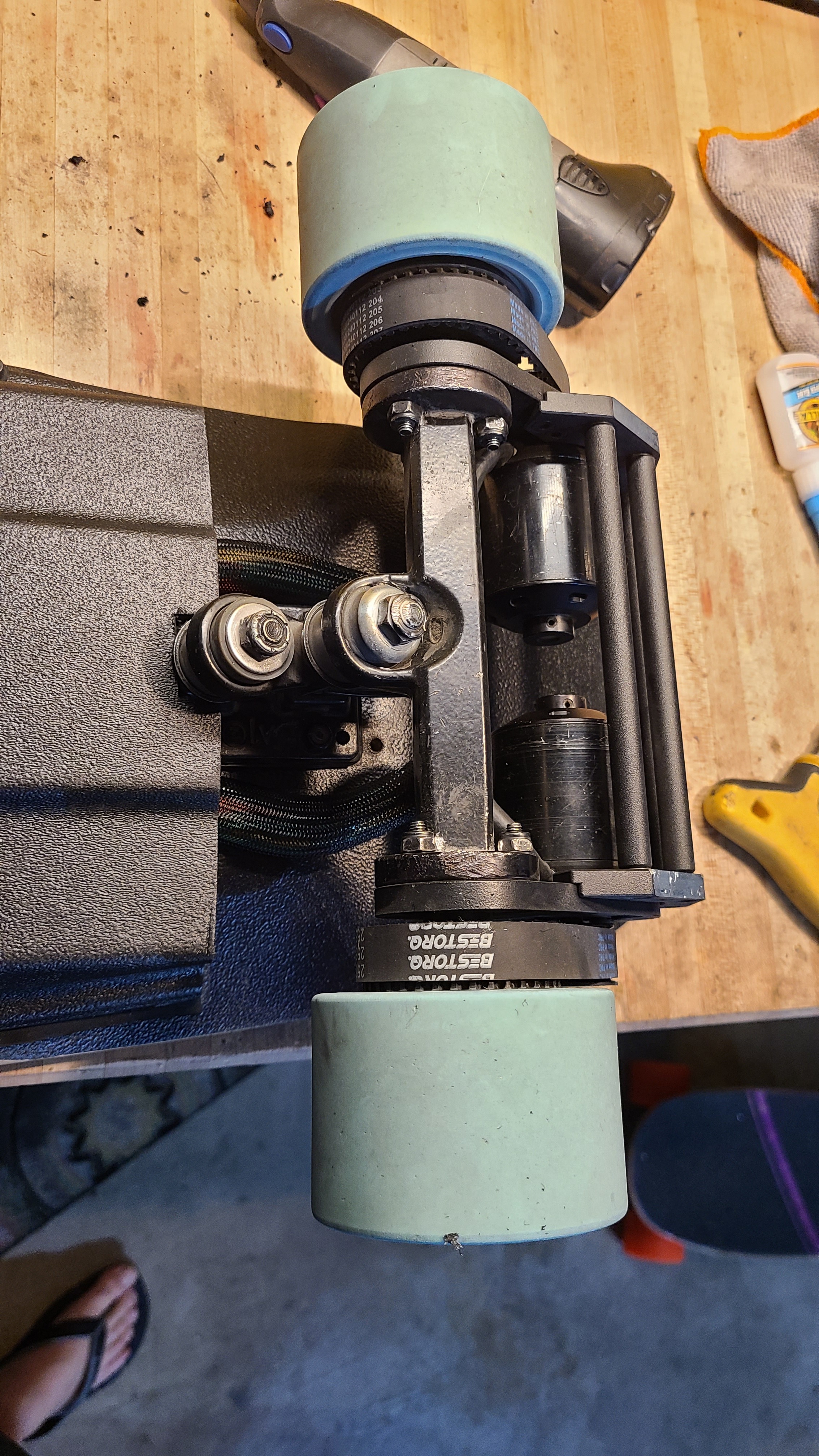

All I was going to do was put on the BN 184s.
That is reasonable. Get a bit more space. Get the nicer machine axle on there.
The motors used to be crooked on the caliber mounts which always bugged me.
So I switch axles using the bkb mounts shimmed with a couple of washers…
Pretty straight now.

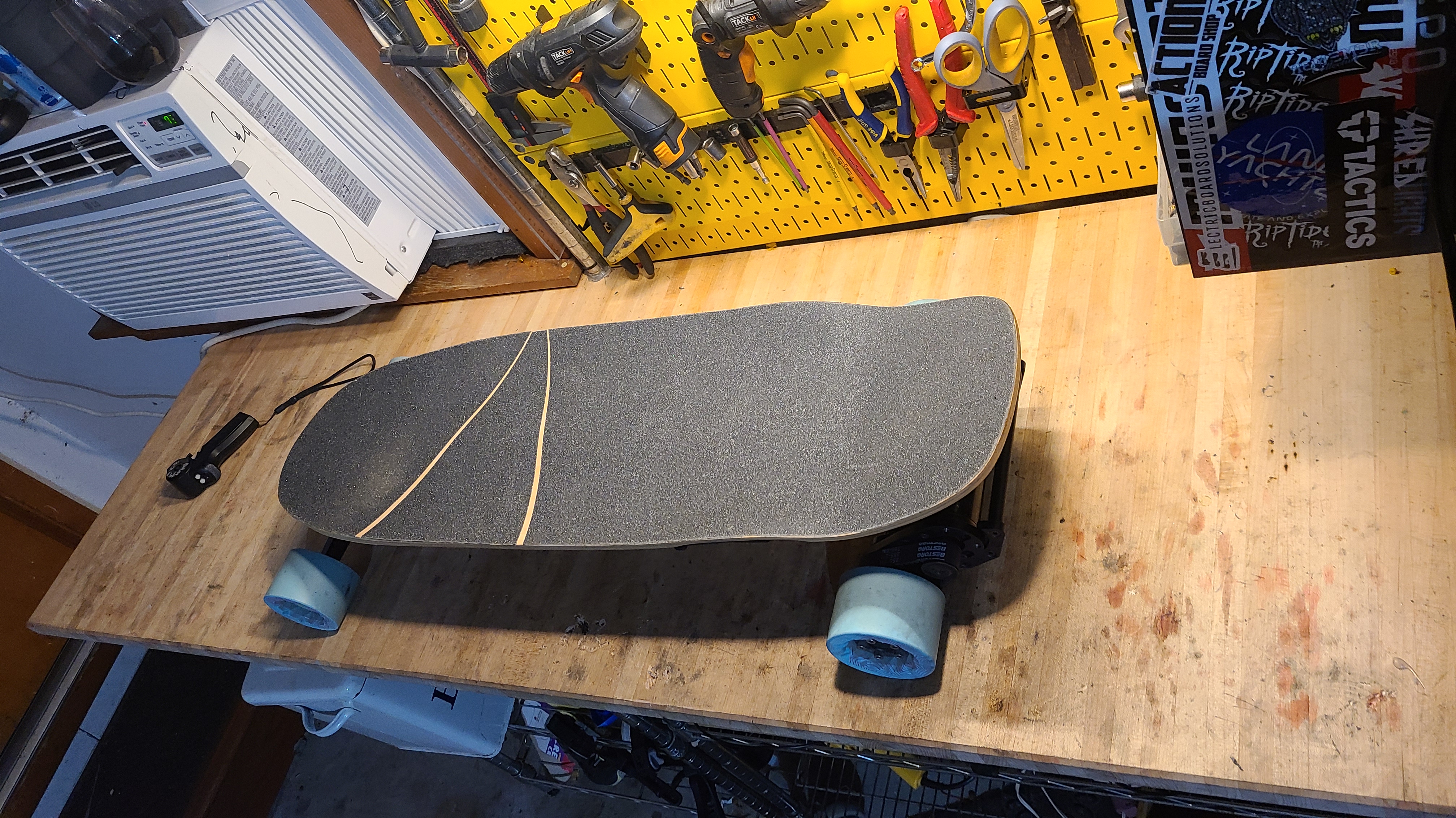

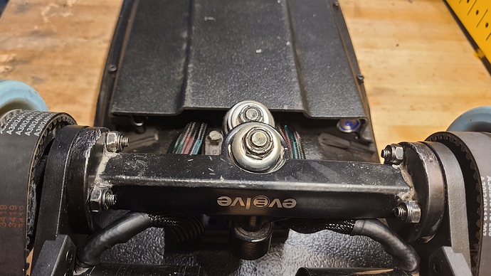

This is yet another refresh on the Evolve.
All there is here from the evolve is the deck.
So. I made my 4th battery pack.
A 10s4p 30q pack.
I took the old Flipksky 190kV 6374s.
The Hexls trucks.
A Flipksky 4.20 dual plus ( the one from the Omakase…)
Cooked up another set of blacked out blue Caguamas.
And slapped it all together.
Since I like to get high off or rattle cans I painted the enclosure again and the cans on the Flipksky motors.

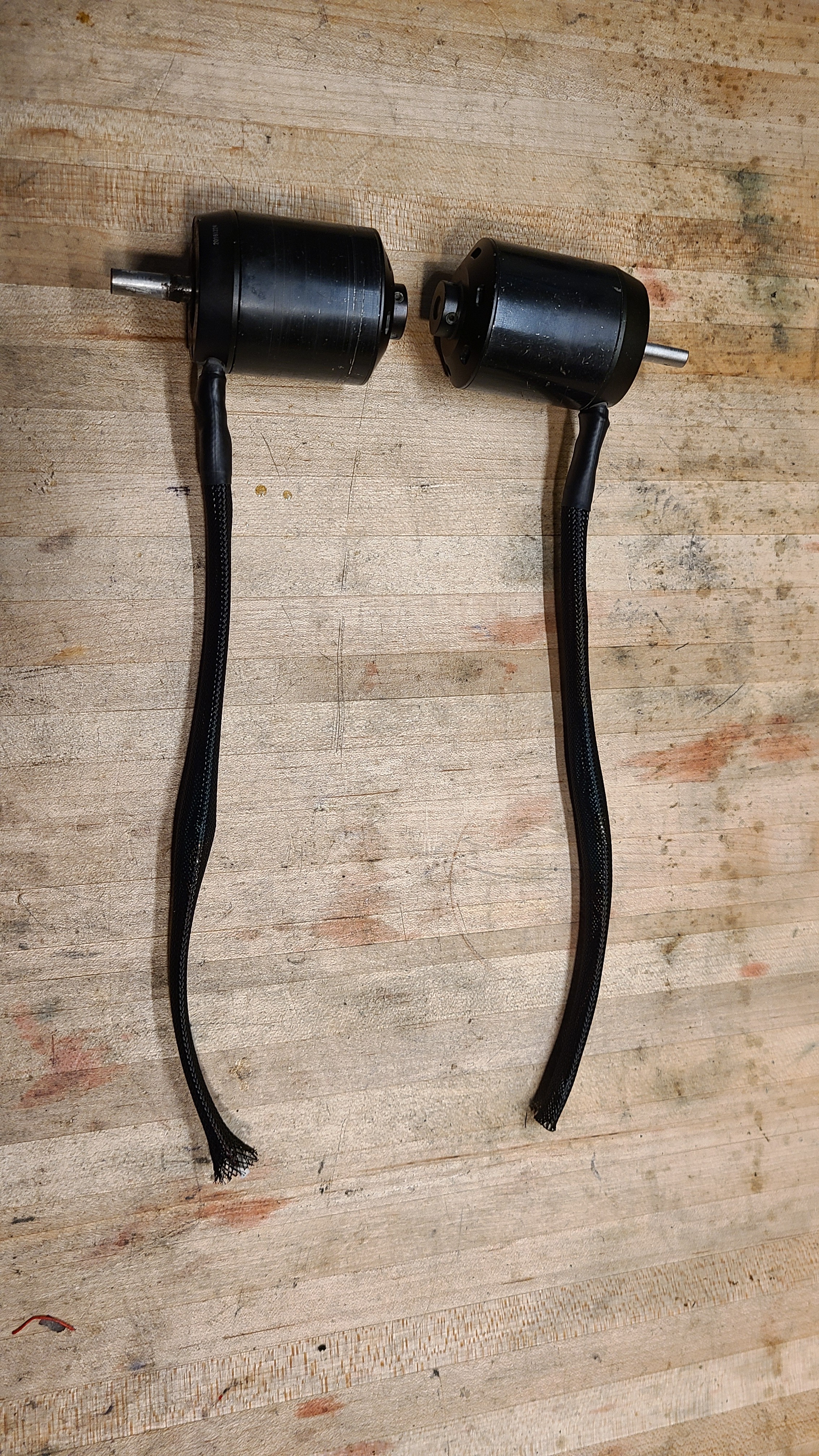

It used to have Flipksky 6354 motors and I’m putting in my old Evolve Bamboo GT motors… 5065 150kvs I believe. Still going…

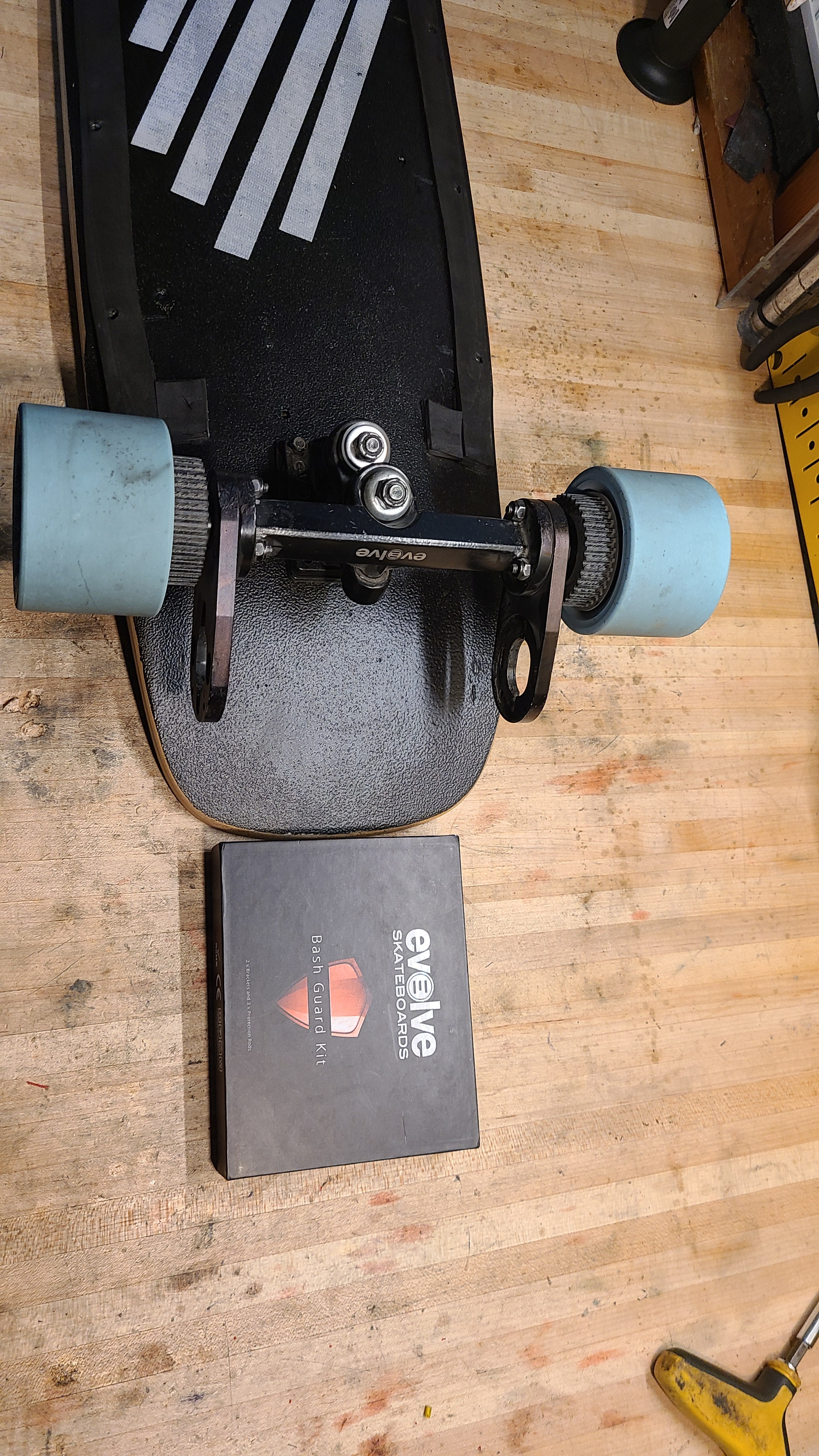

Main reason I wanted to use the Evolve motors is so I could put in their bash guard kit.

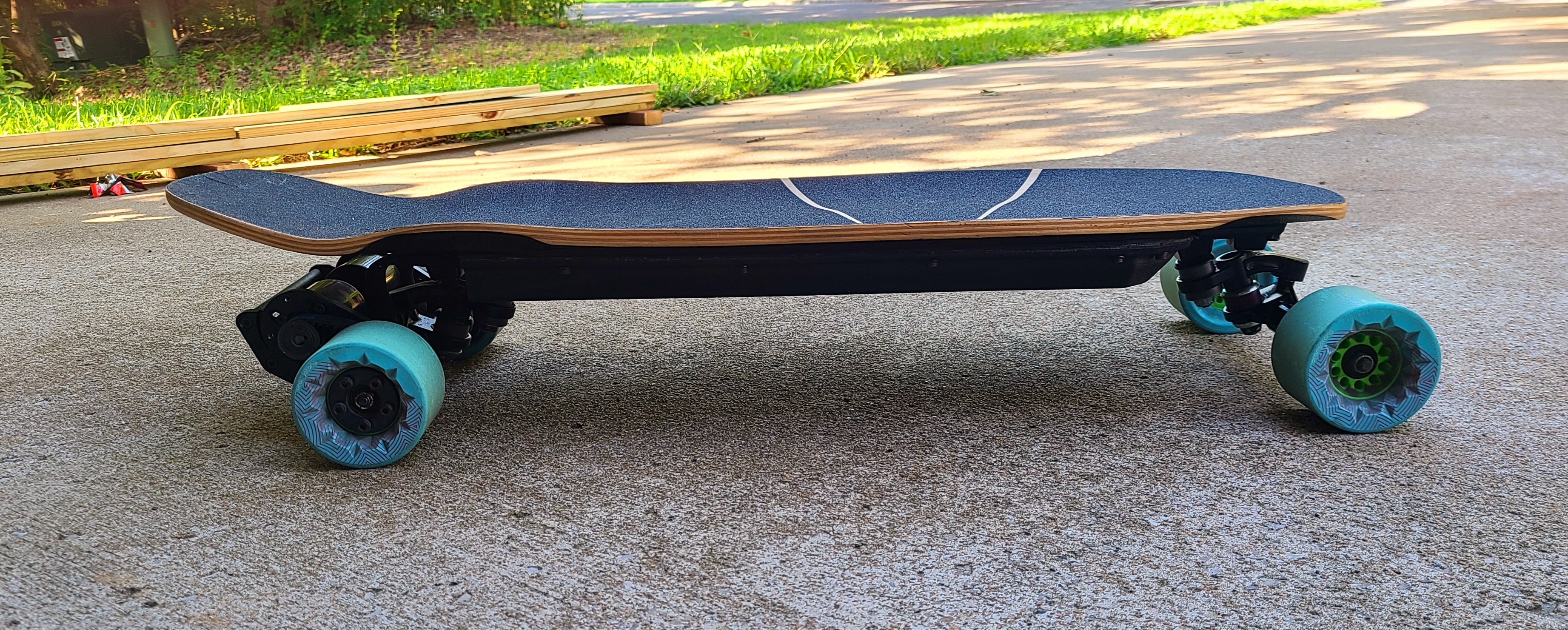

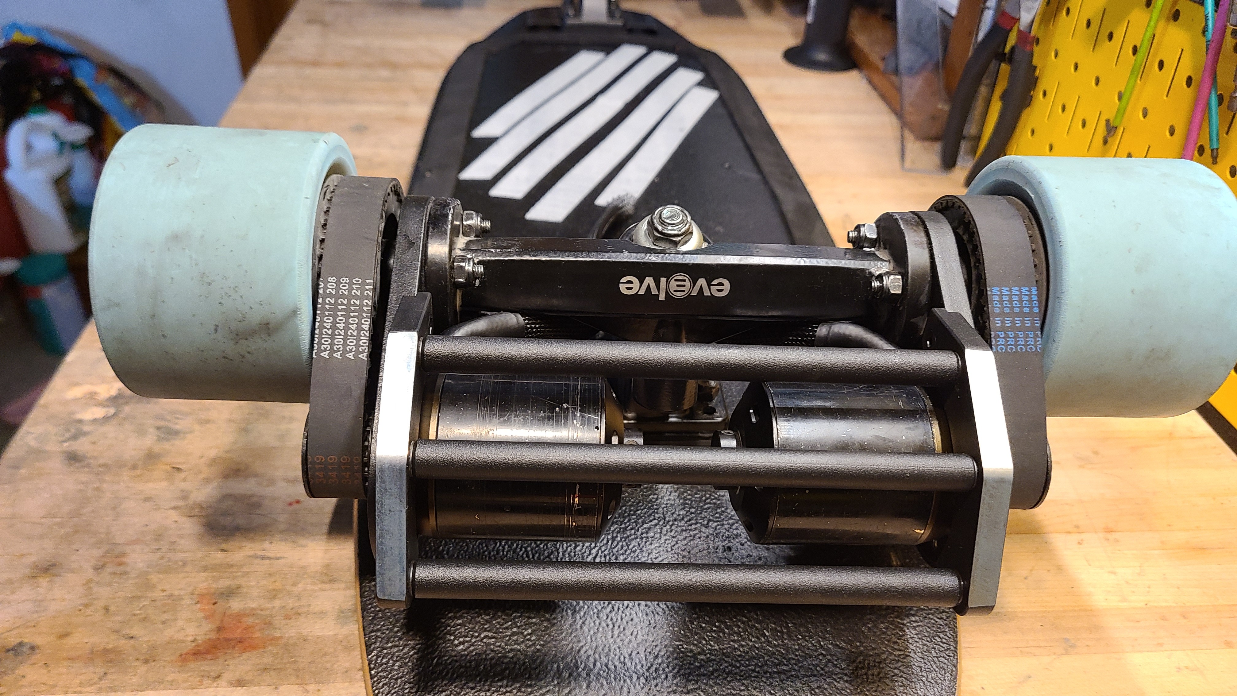

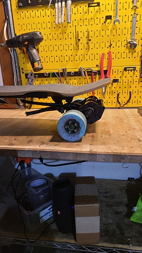

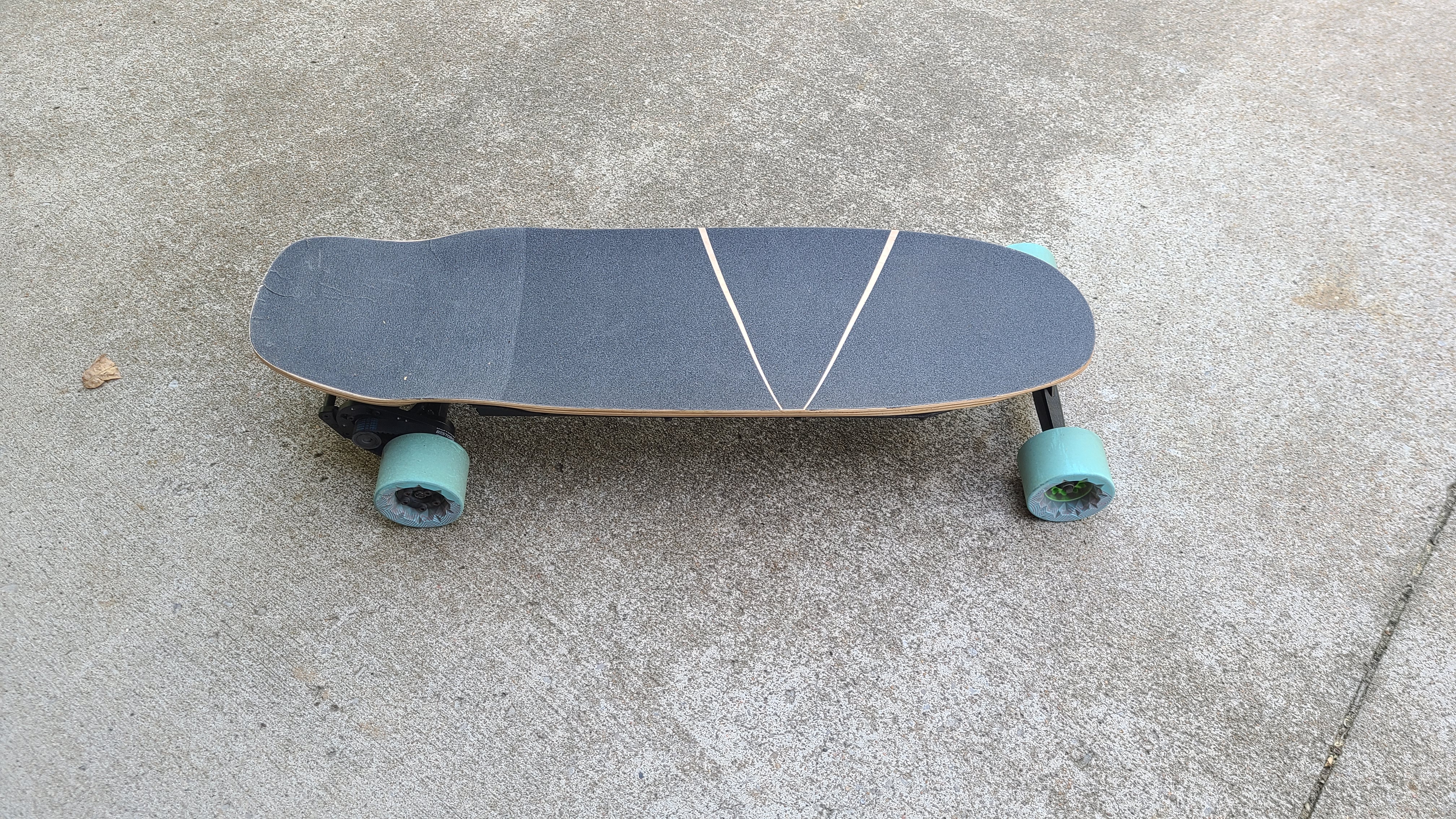

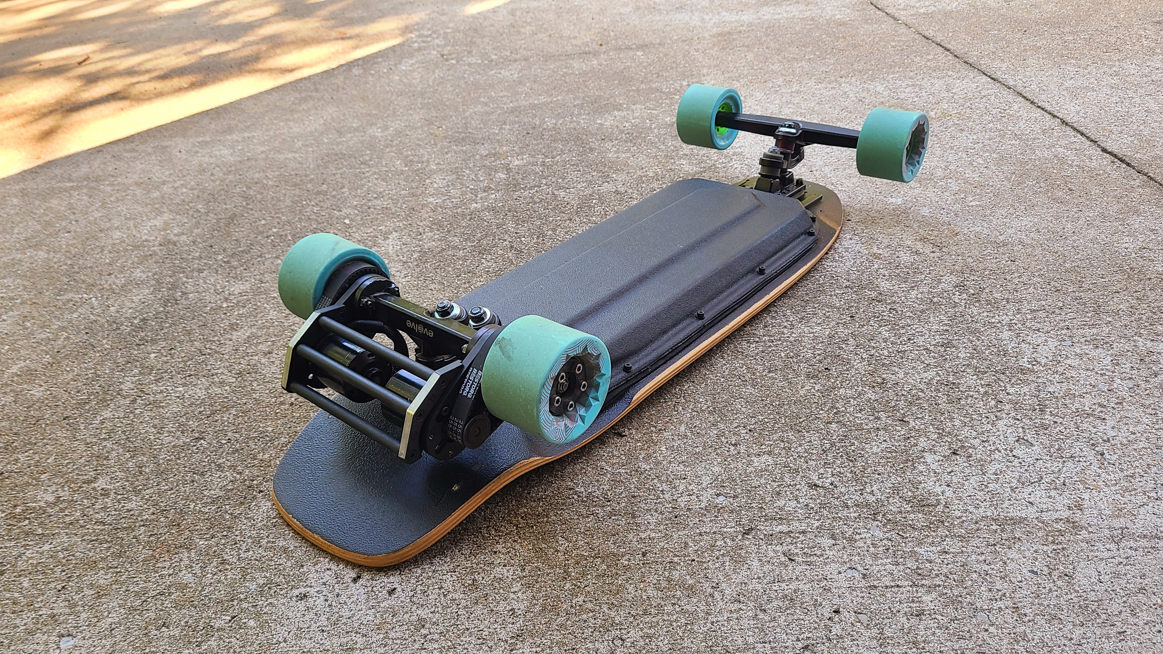

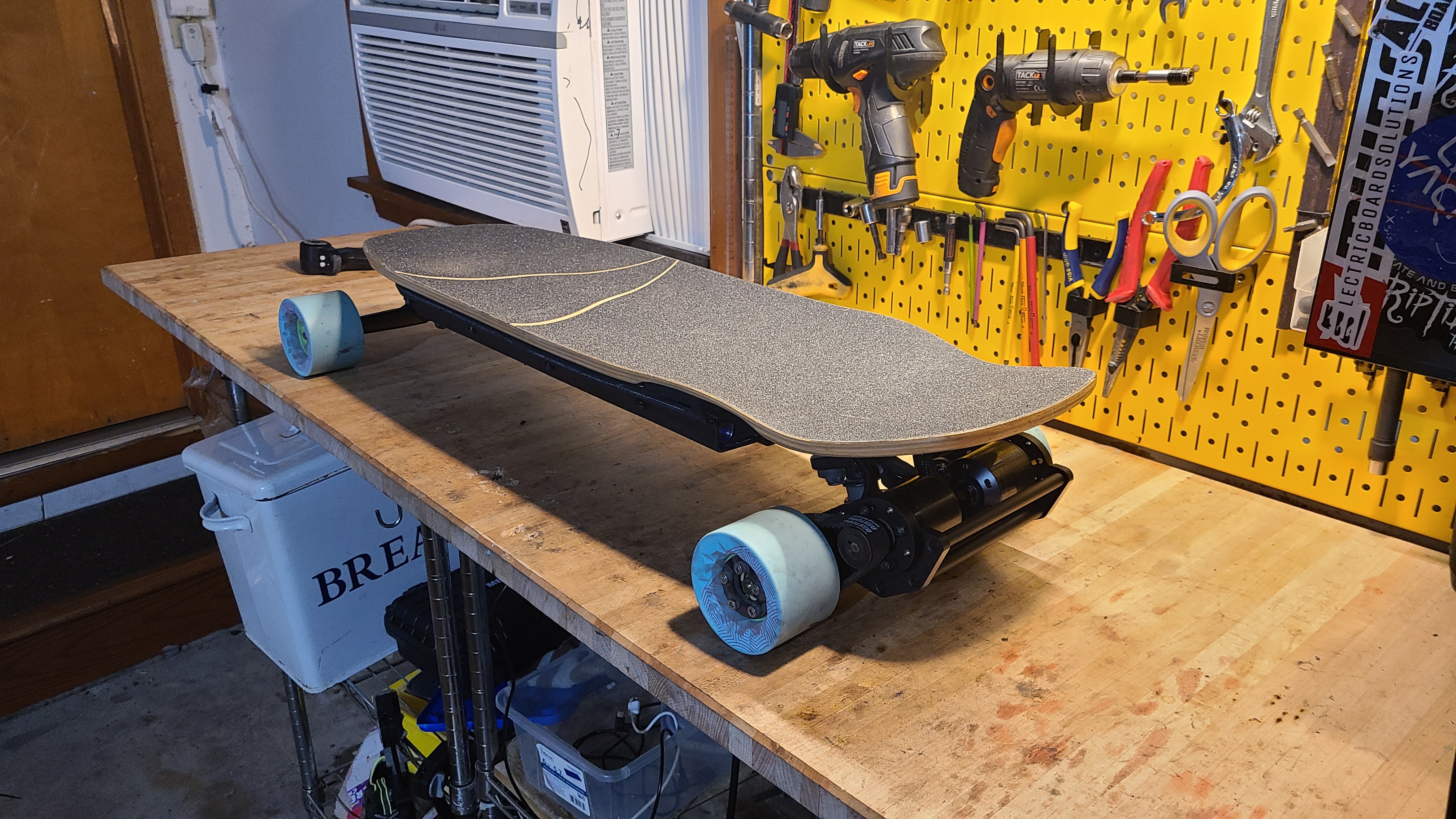

So. In summary. Can
Trucks and motors from my old Evolve Bamboo GT.
Earthwing Muirderer deck chopped down.

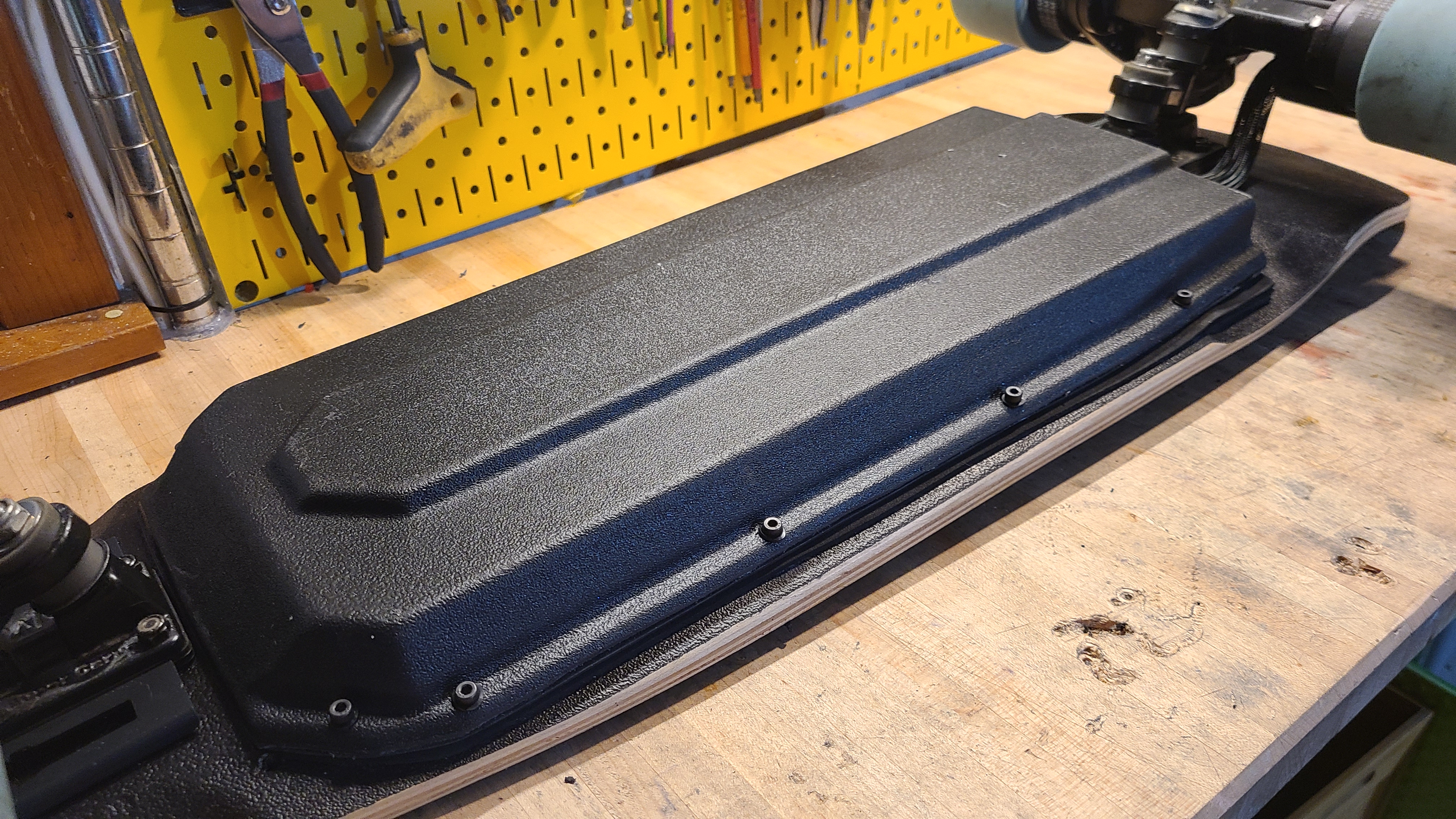

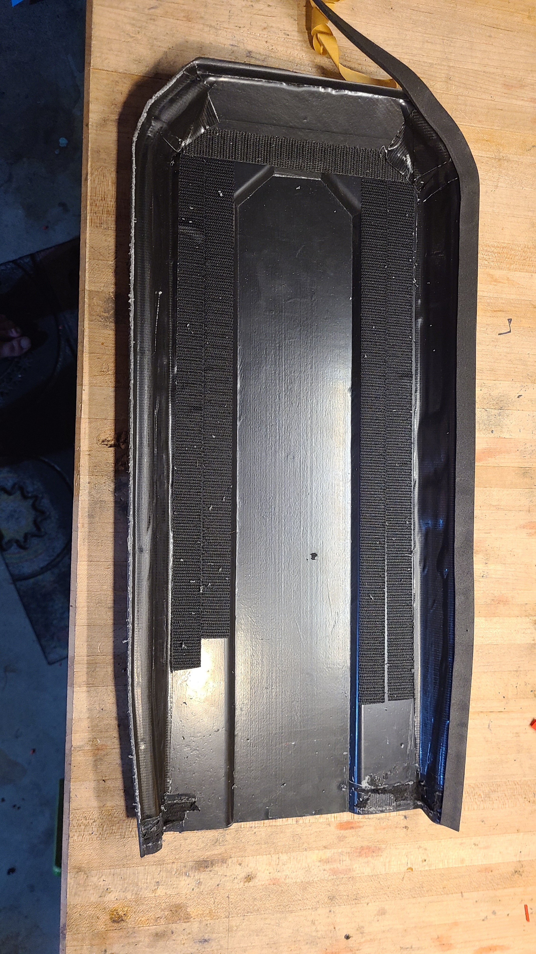

Psychotiller Evo enclosure chopped down.
New Evolve Bash Guard.

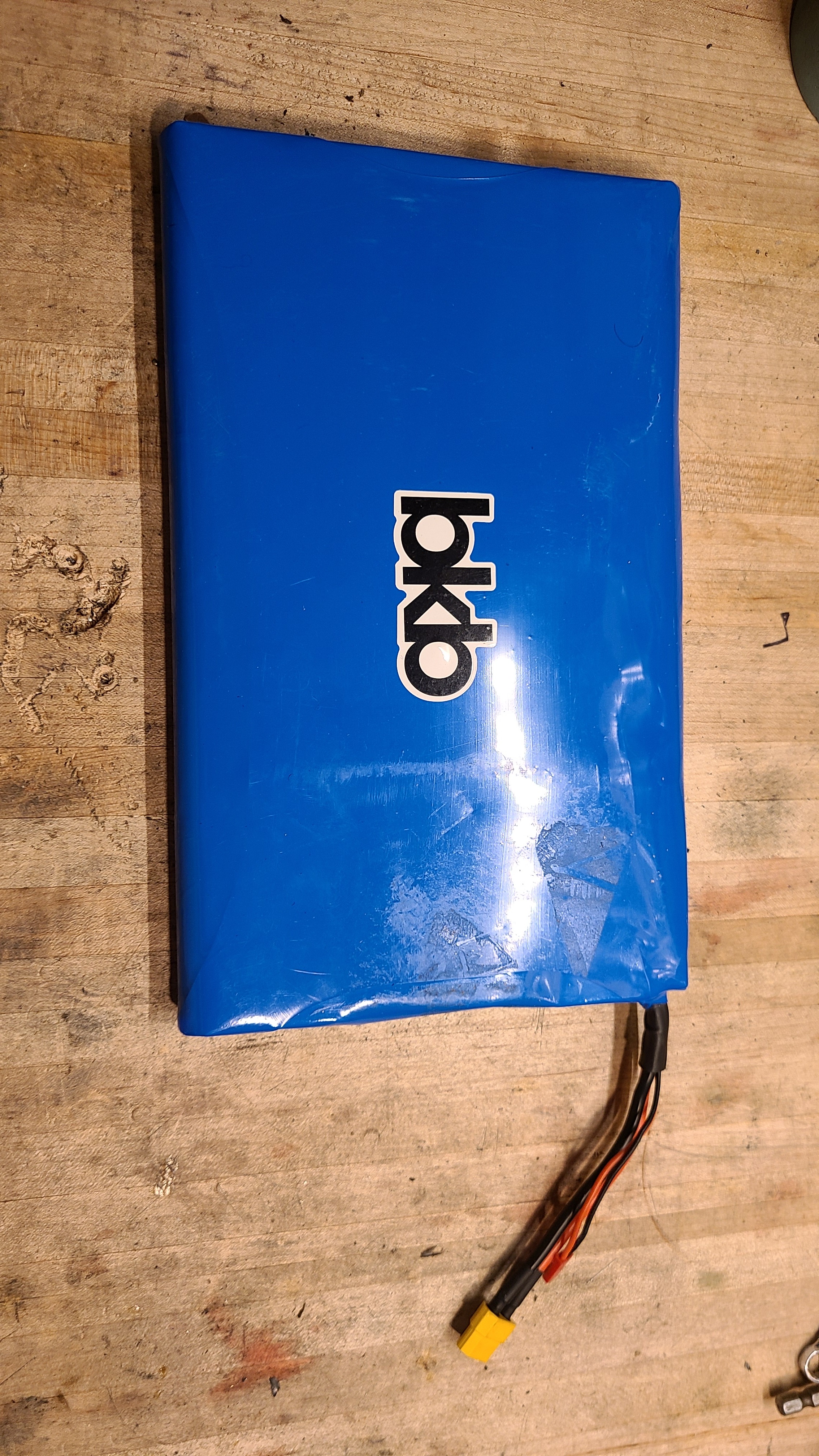

10s3p 30q pack from BKB.
Flipksky 4.20 Dual Plus.
Blue Caguamas running on 16/34

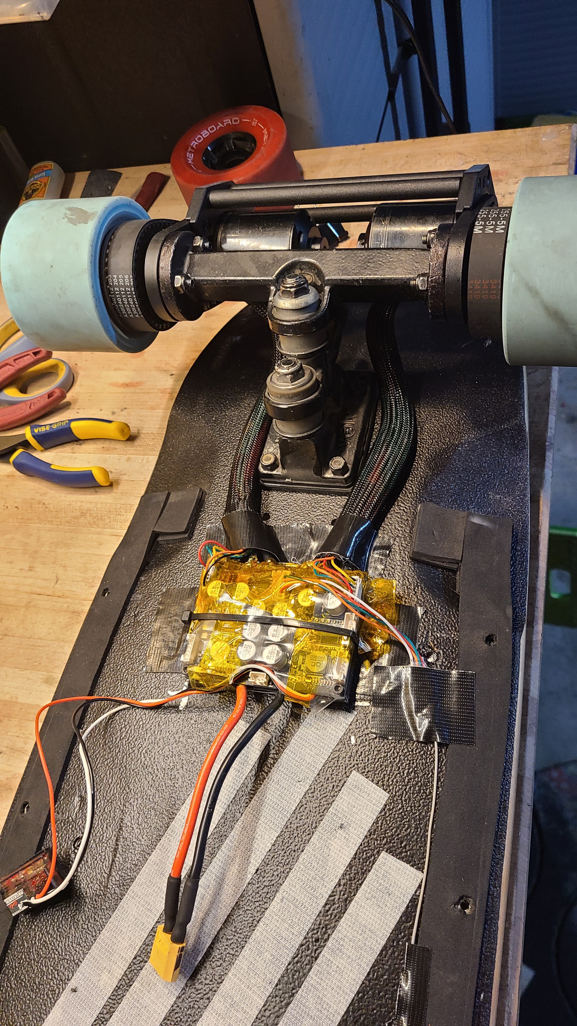

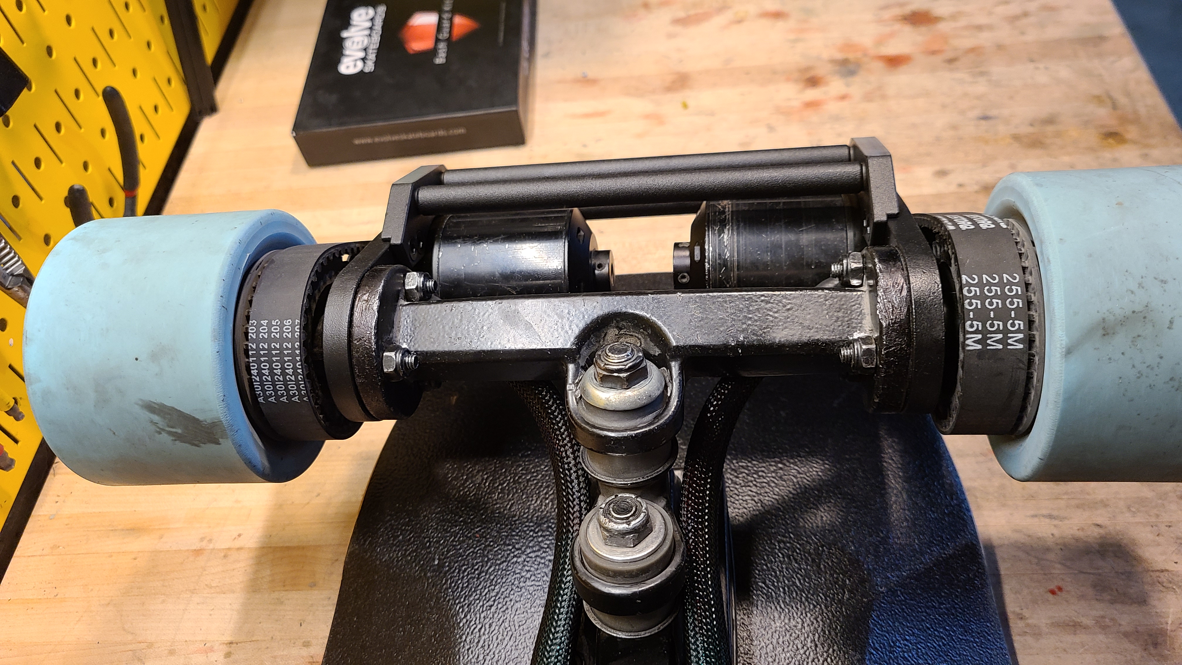

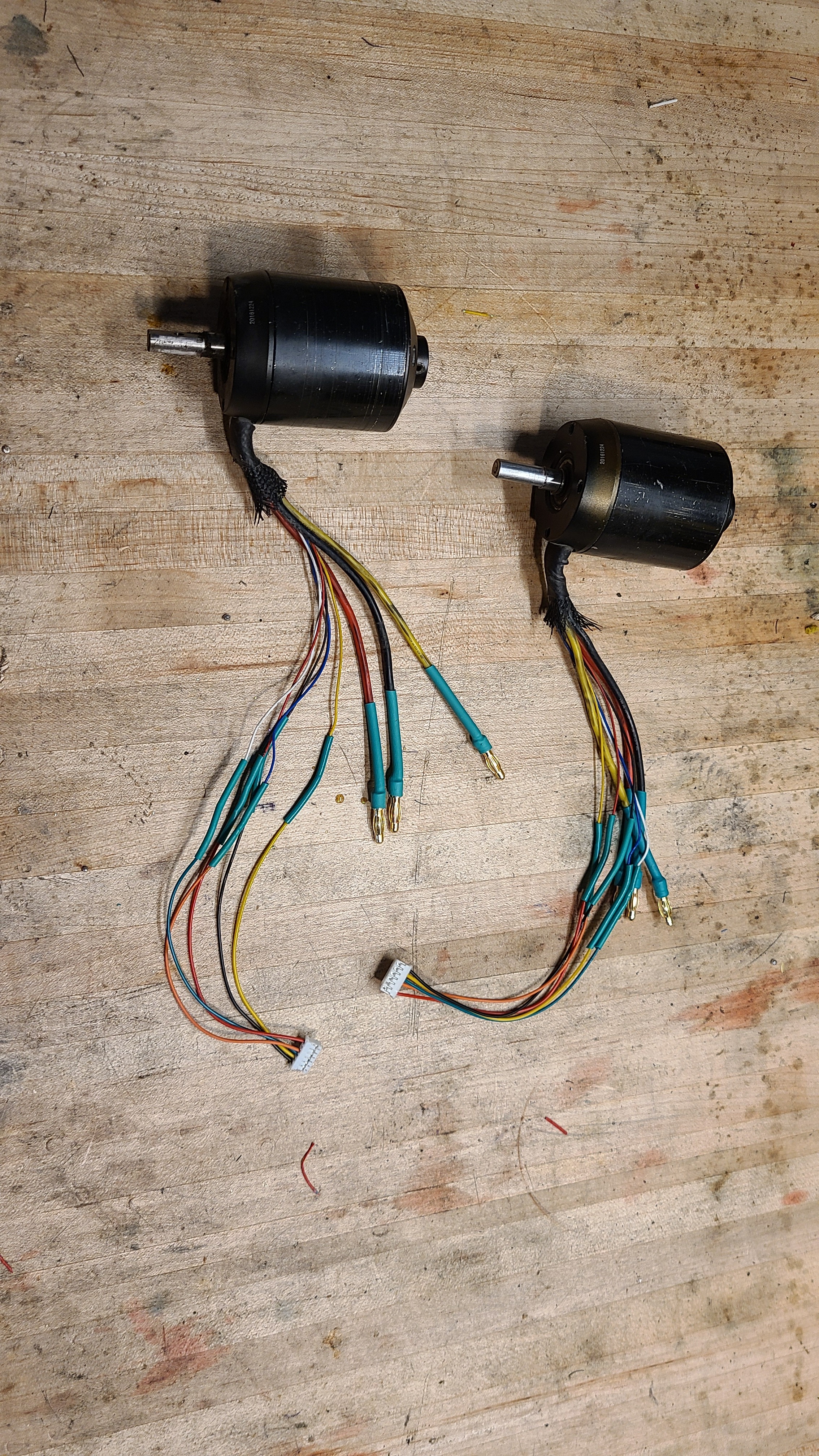

I started off by soldering new connectors to the motors and mounting them along with the bash guard.
The parts for the bashguard are really pretty nice…

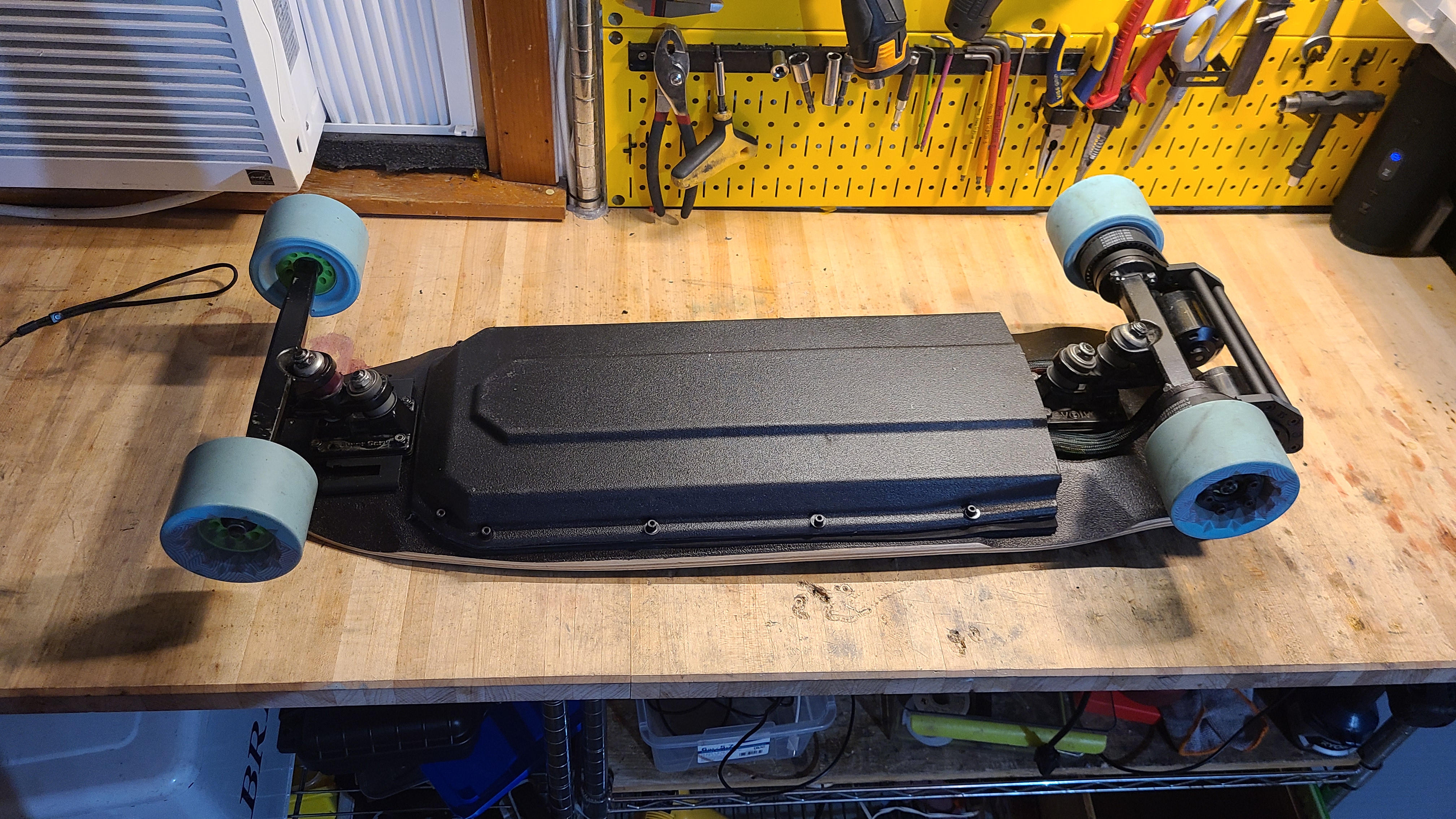

After this it sat around for a bit because I was going to build a pack and then happenstance landed the bkb battery on my bench.
This made life a million times easier and I just needed to hook stuff up together…

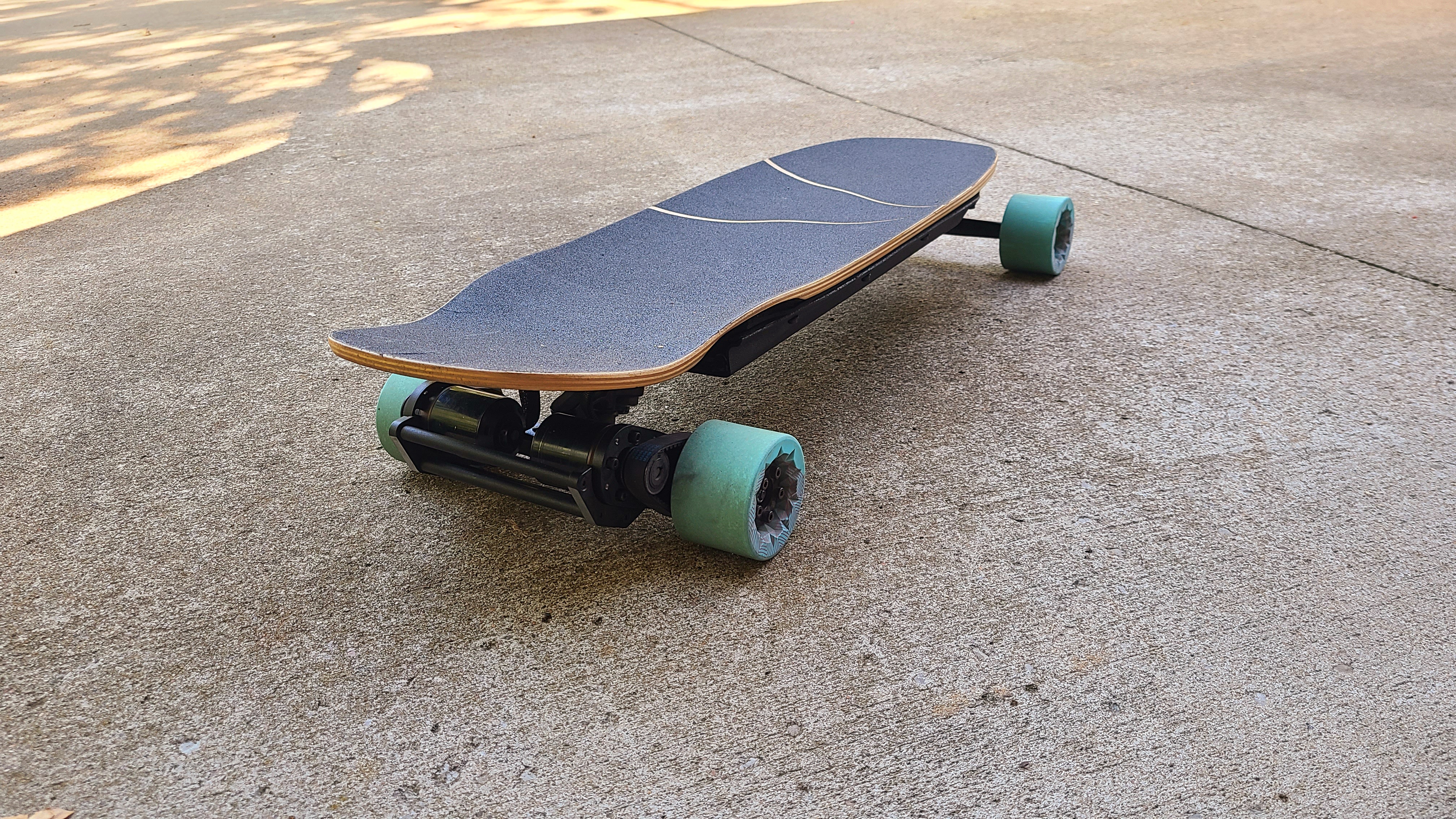

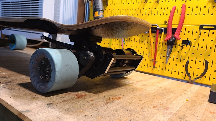

I took it out last night and it performed pretty well really for what it is…
It tried to kill me a couple times with the back wheels sliding out… And I came off but was able to run it out…
Need to get used to that.

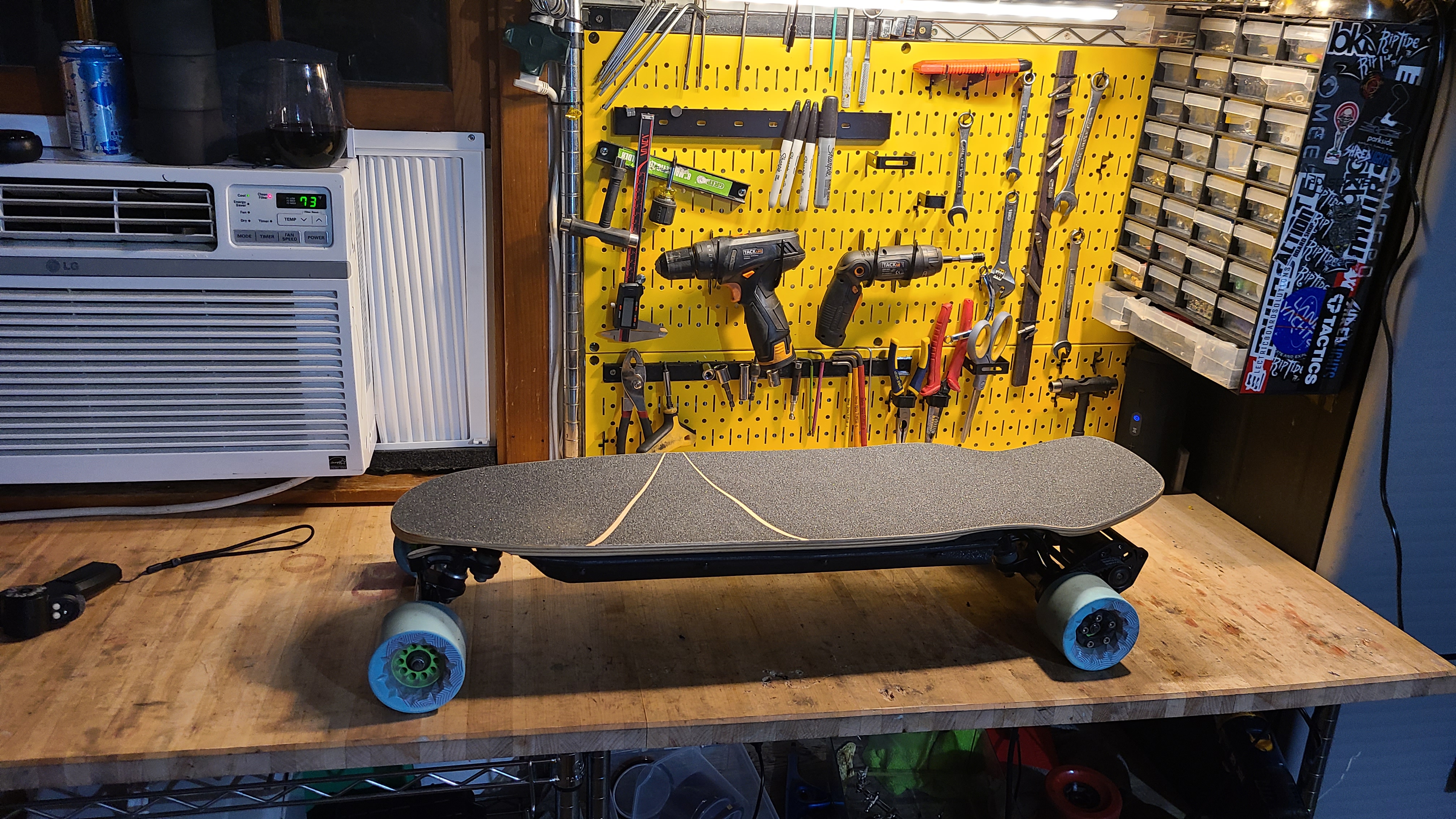

So I was hoping that with the smaller battery it would be easier to use the kick tail and it was not…

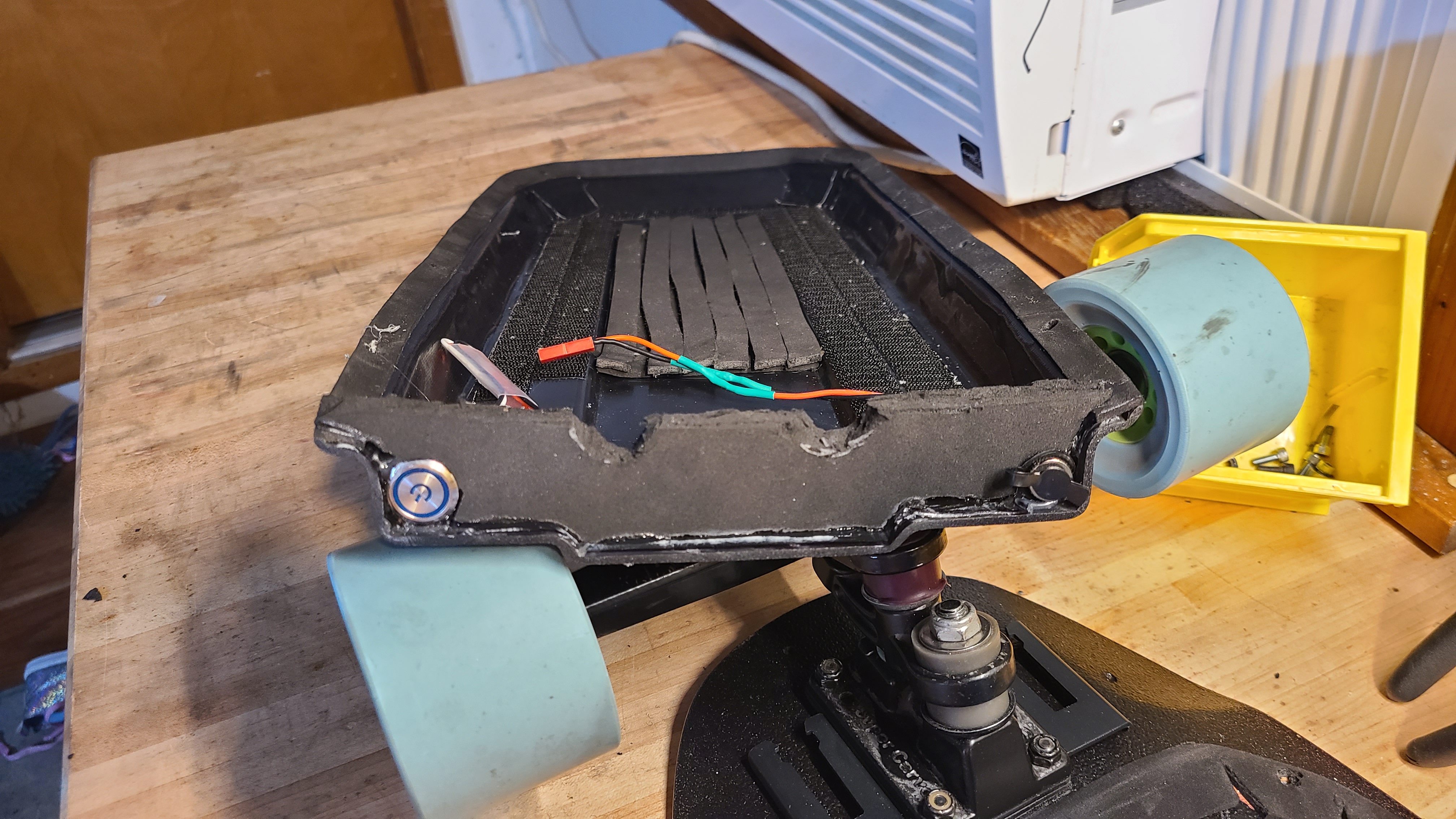

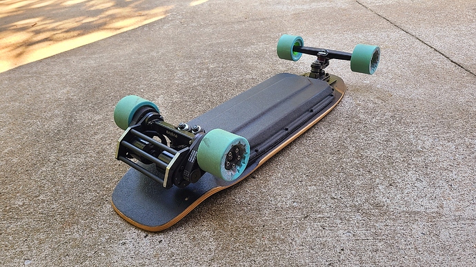

Well. The issue is that I had the trucks mounted on the outer holes on the Muirderer. I had to do that before with the 10s4p battery…
But last night I realized I could move the trucks up and I did that this morning.
It was really pretty easy… I just had to peel back the grip tape and cut a notch on the enclosure.
This made the tail 100 times more usable.

I also decided I need to go from 16/36 to 16/34
So I am changing that. The speed was ok on a full battery. But got lame with a bit of sag.
So hopefully that will do it.
Those bashguards are sick asf, and glad you’re putting the pack to good use.
@eBoosted Alan… I freaking hate you… Now I need to upgrade all my enclosures.
These parts are stupid nice!!!
