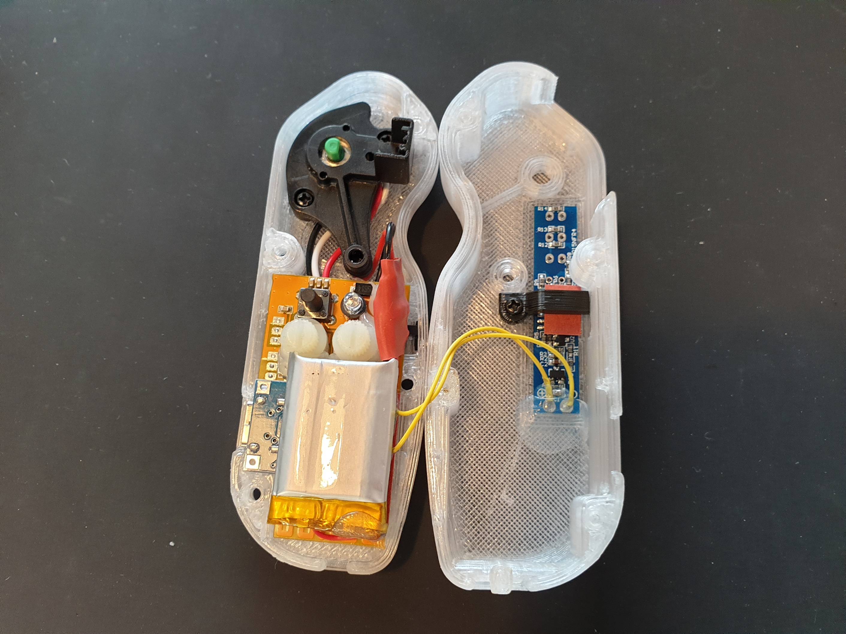

    Here’s how mine looked like at this point (the step down converter in under the red heat shrink):
  4. Attach the rest of the electronics onto place.
    You can see that the battery indicator is attached with a 3D printed part & a screw but additionally I placed some hot glue to secure it firmly. Please use some insulator material (e.g. fishpaper) between the charging board and the remote PCB. I hot glued everything together.

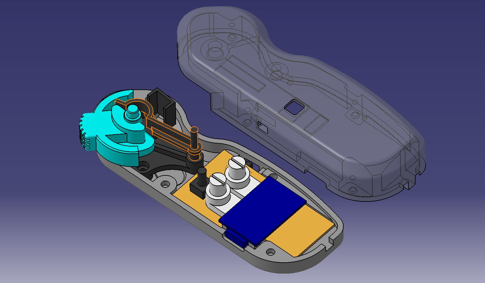

  5. Place the throttle wheel and the spring mechanism on to the potentiometer mount.
    Unfortunately I only have a cad picture of this but you get the idea.

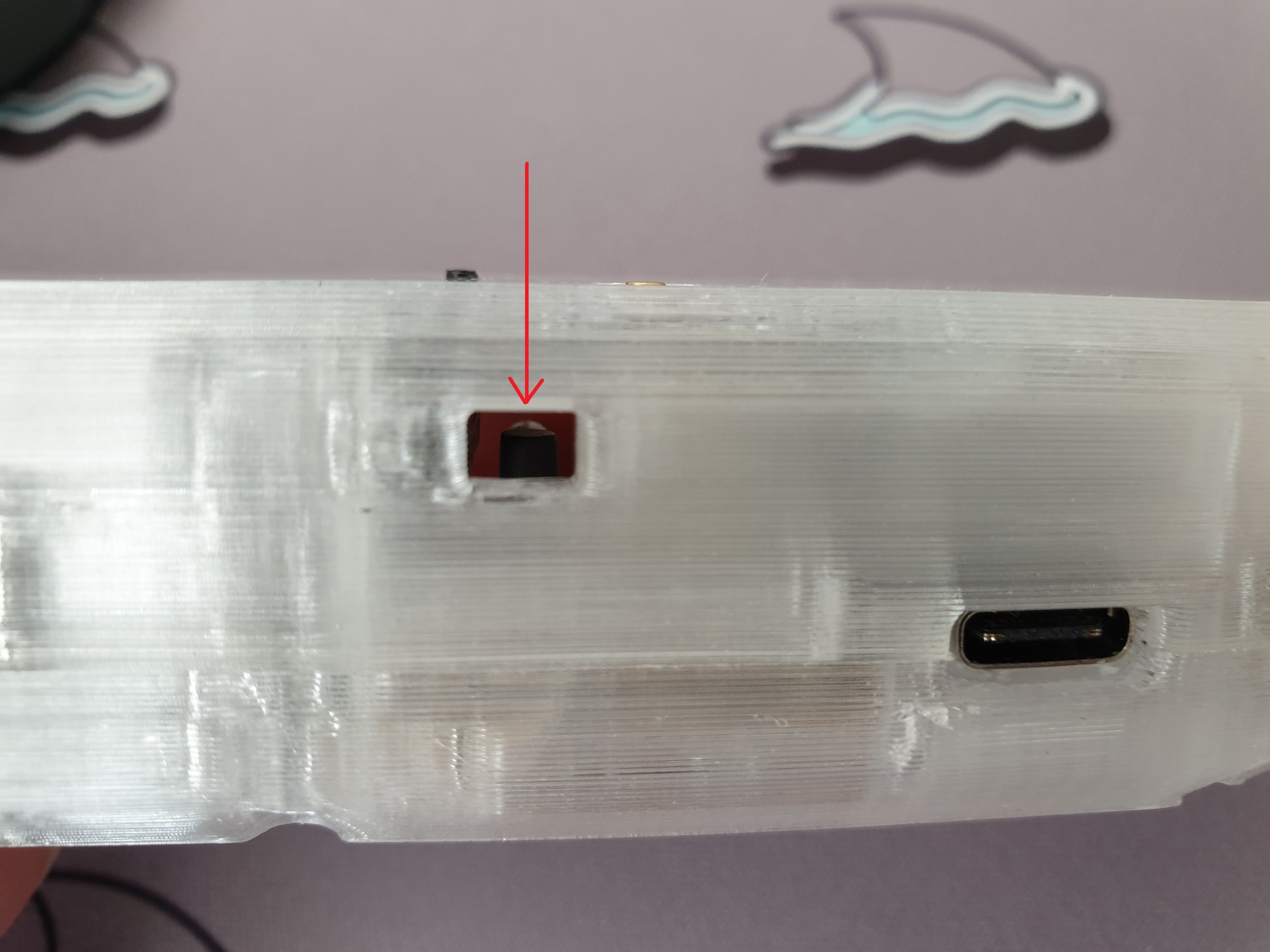

  7. Calibrate your remote. You can reach the bind button with a small screwdriver from a hole on the side of the case, just be careful not to poke anything else while you’re there.

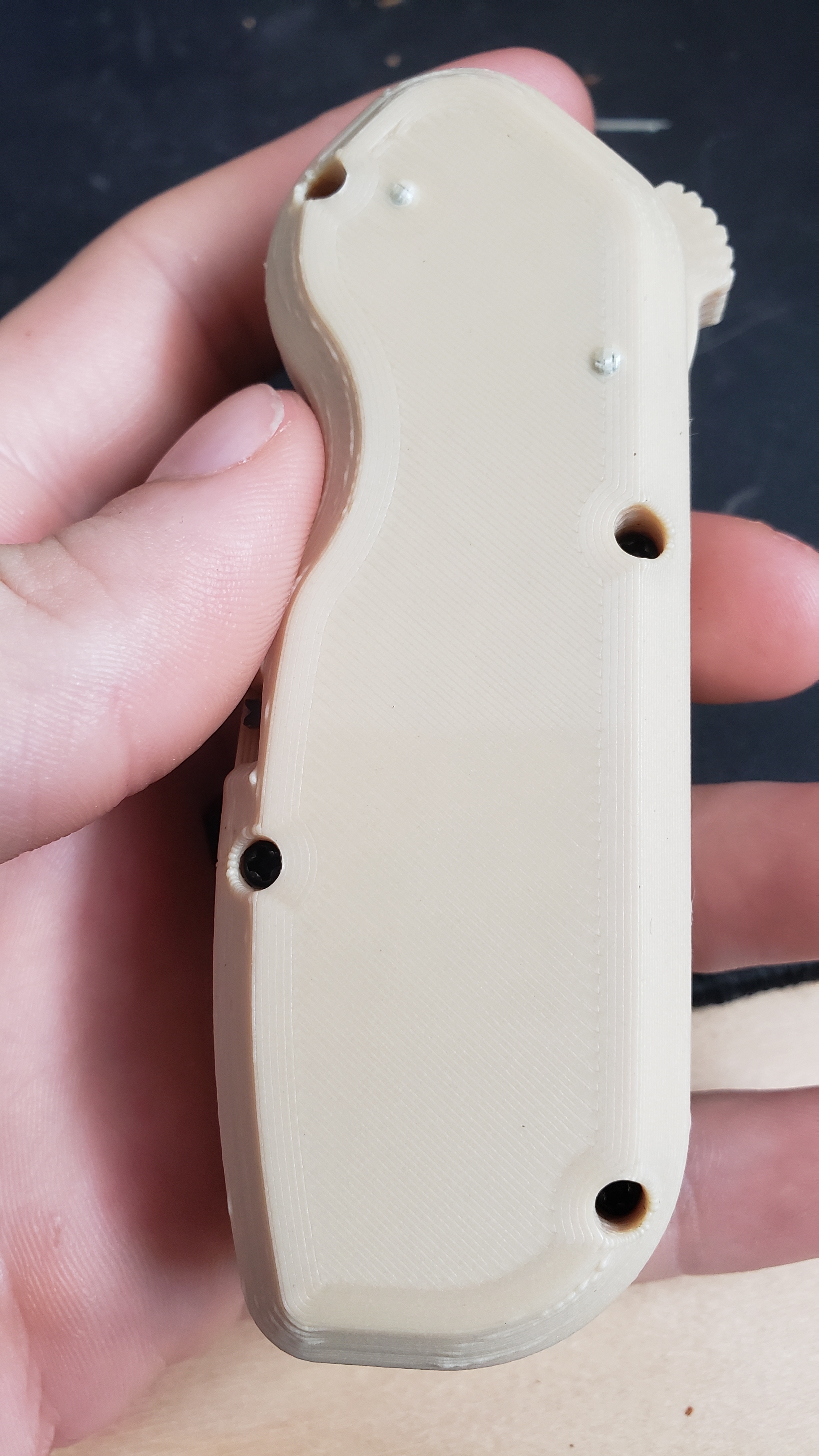

I think my screws where too long as they kinda stick out
Mine do too. Didn’t want to make the case even 1 mm thicker so…
I opened these holes so that the screws come neatly through (look at the 1st picture above). Alternatively you could shorten the screws just a little bit.
If you wonder why I didn’t model these as 100% through holes it’s because I think it prints way nicer if the first layer is as uniform as possible. You can always open up a hole but closing it is more difficult.
