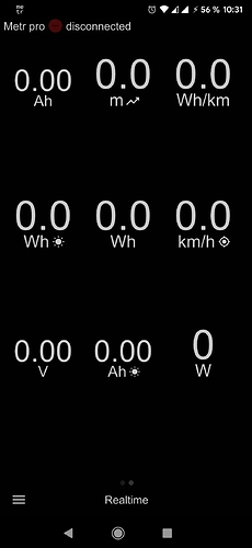

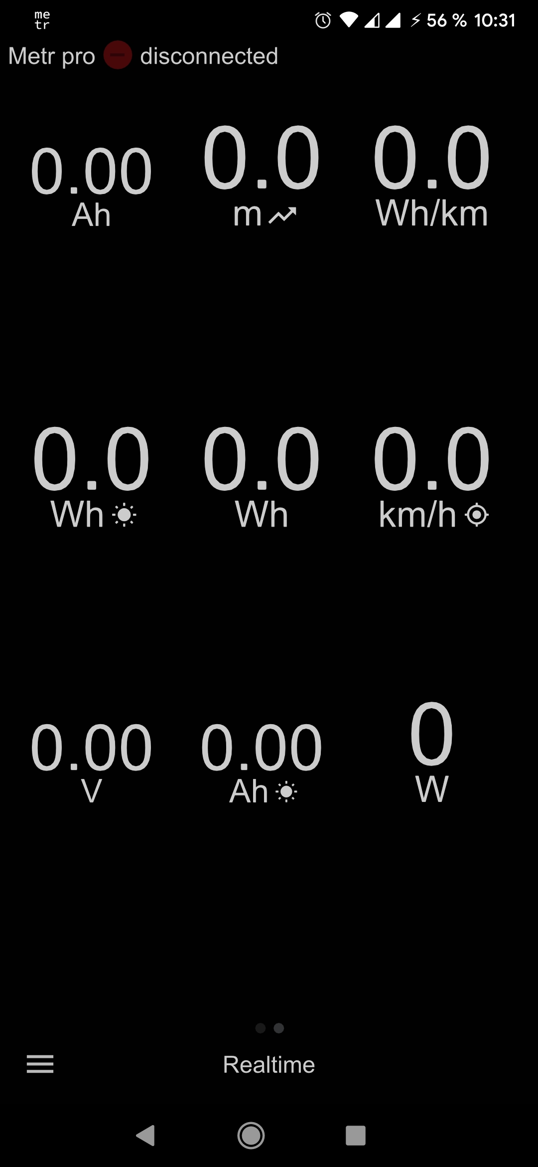

The second real time layer has the Connections status on top, instead of the bottom. On purpose?

@xsynatic You can hide second status cell. Enter layout editing mode on the second screen and tap it to disable. When resetting layout it is hidden by default. I think you accidentally enabled it.
I found it. The issue was that the box was out of bounds or at least not visible on editing mode. I had to reset the layout, that fixed it.

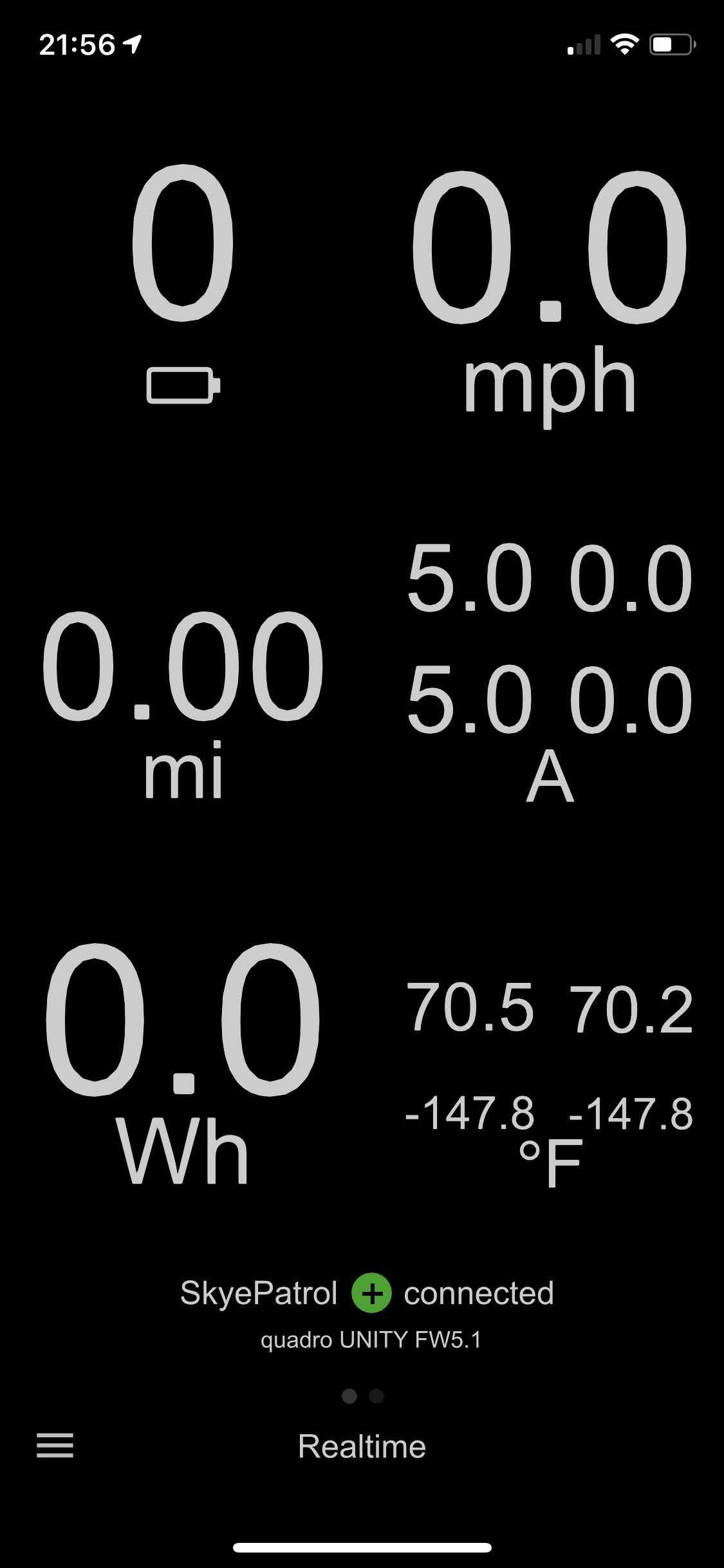

Any ideas why I got negative temp and 0
Battery. What did I breaaakkkk :eyes:
