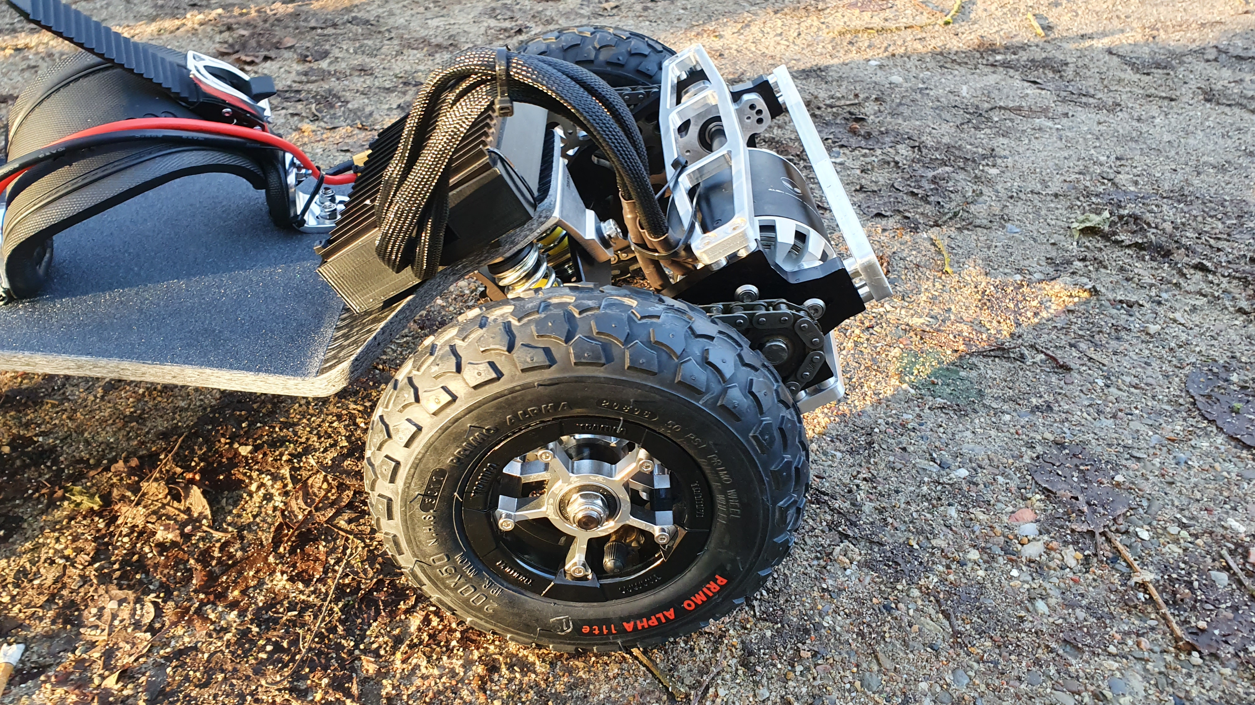

The Build Concept
An eFoil only has one motor and one (beefy) motor controller. The 80100 I got was meant to be used in a direct drive setup. That is why it’s a 80kv motor, a bit awkward for an esk8. I also have a second spare 80100 so I could theoretically run dual motors, but I only have one Arc200 ESC. I can’t get a second one as they are discontinued (which is a shame because they are awesome motor controllers).
So I decided to take a somewhat strange path and run a single motor setup, but driving both rear wheels. So “single motor - 2WD”. For this I swapped out the shaft for a much longer one so that the motor could drive two E-TOXX chains, one on each side, for both rear wheels. Obviously this locks the rear wheels together, forcing them to run the same RPM all the time. I knew that this would put some strain on the whole drive train when cornering and that it probably would make the board want to go straight all the time. But my feeling was that it wouldn’t be too bad, especially on wet and muddy surfaces.
For being able to get some serious amps out of the ESC, I use a 15.9x10cm anodized aluminum heatsink. Batteries are only two 8Ah 15C Turnigy Graphenes. They are enough for now, but I will upgrade to a li-ion pack in the future.
The board was purchased as a whole from @Trampa. HS11 deck 16ply, Infinity trucks, Superstar hubs, 8" Primo Alphas, ratchet style bindings.

The motor sprockets are glued with Loctite 638.
Arc200 bolted to 15.9x10cm aluminum heat sink. Seems to work wonders.
PETG enclosure for the ESC and receiver. Fixed to the board with three M4 screws and thick rubber washers in between.
The battery box is fixed using 3M Dual Lock. I used two long strips lengthwise and several shorter strips in between so that they are perpendicular to the longer ones, hoping that this way they can take different kinds of force and vibration.

Sealing the motor
I sealed up the motor with a two part 3D printed cap and several small insets that perfectly fit into the gaps on the motor base. The insets are epoxied, the cap is screwed and further sealed with Sugru.
Heel straps

ESC enclosure
I re-did the ESC enclosure. Before it was a 3D printed provisionary solution. It was a one part enclosure, sealed up with Sugru, so I couldn’t open it for maintenance etc.
I now use a Serpac ABS IP67 two part enclosure that I can open if I need to. The heatsink on the top stayed the same.
Trampa Barrels
Before the barrel/elastomere upgrade I was on springs with yellow dampas. While that was fine for carving, it felt very unstable at 30+km/h or on sudden throttle releases.
Impressions
Riding with the barrels is a night and day difference in terms of stability. It is astonishing how super stable and safe they feel, no matter how fast I go or how fast a accelerate or brake. Before I was super afraid to approach vmax, now I can ride at ~44km/h easily and I can pull the throttle as hard as I can and remain full control and stability (at least until I up the current settings once more :grin:). Who still has springs: just upgrade, it is worth it. Didn’t lose any turning ability either. These things are just great.
