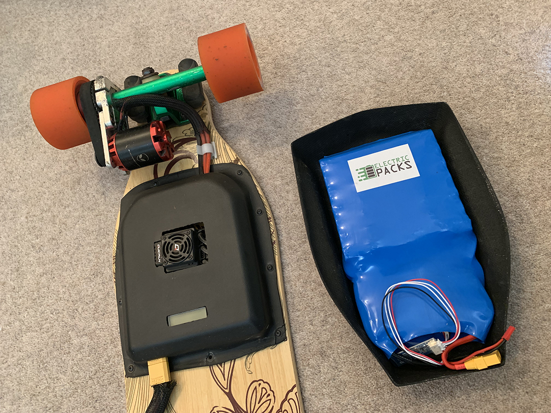

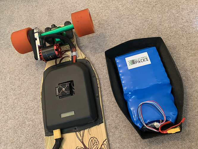

How the 6S build looked (Hobbywing Quicrun 150A ESC, Alien Drive mount and APS 270kv motor) next to the finished 10S3P battery and enclosure!
@pjotr47 teasing me with the finished battery!
Absolute work of art, imo. Strategic cell and smart BMS layout to fit the relatively awkward enclosure space. I would say the enclosure is suited to 10S3P in this format, as apposed to squeezing 10 more cells in, as it’s advertised. The final setup simply has the charge port at the top of the enclosure for easy charging.

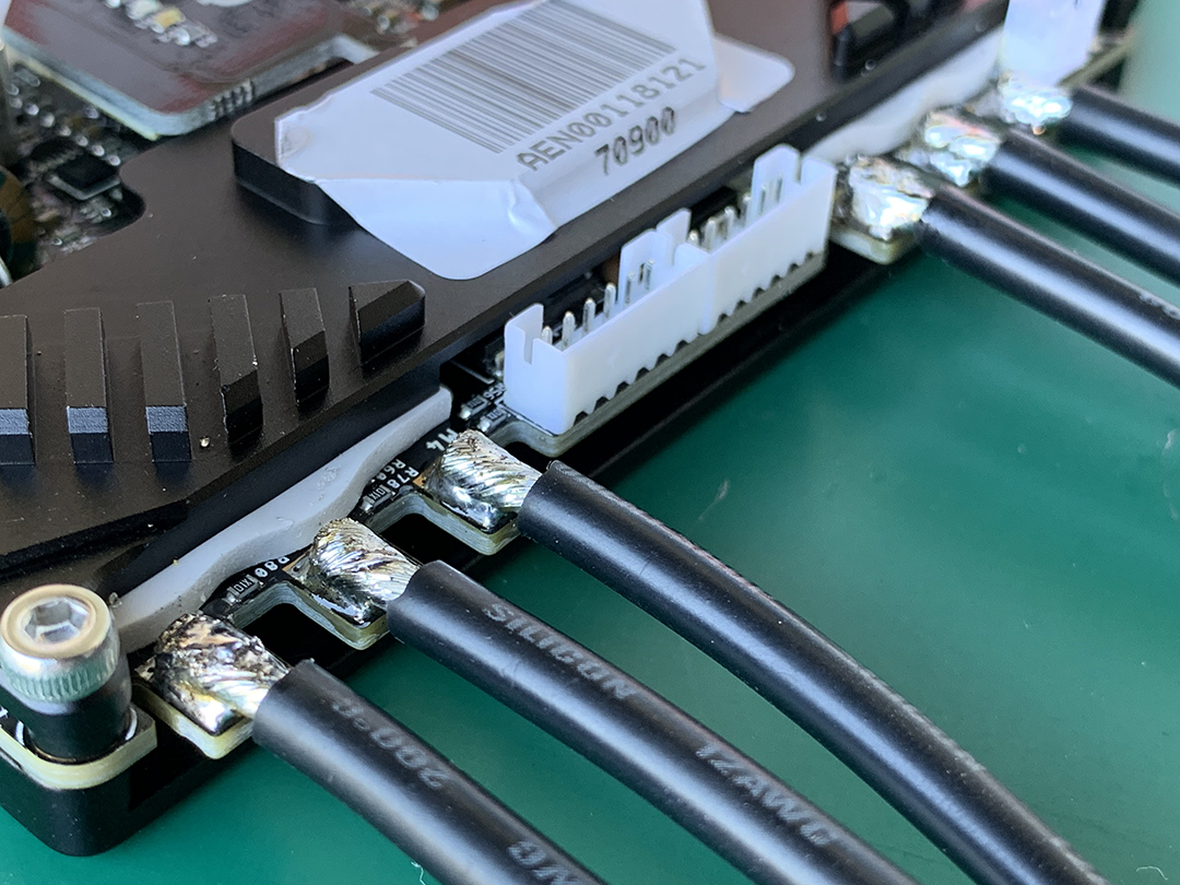

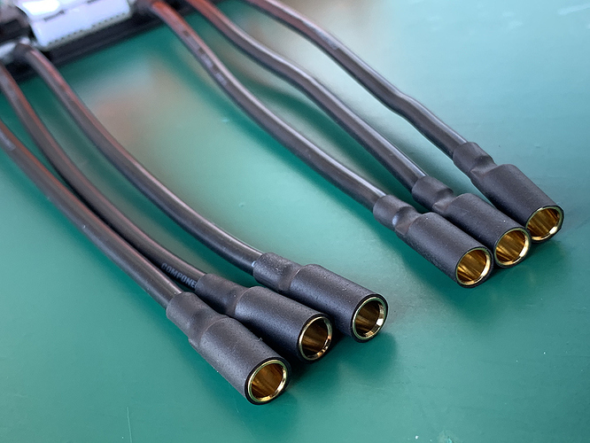

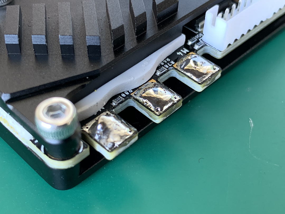

I decided to replace the phase wires on the Unity with 12AWG wire, and 5.5 bullets.
Initial layout. Because I make stickers, I have a lot of transfer paper, so I stuck some to the board to get an approximate layout, ahead of drilling holes and making a custom Unity mounting plate… which took a while… as I struggled with drilling the 4 mounting holes, which I couldn’t get to align properly. I bought a pillar drill from Amazon which helped massively, and learnt lots about correct centre punch use and pilot holes, etc. I got there in the end!
I ended up shortening the Unity phase wires, and lengthening the motor phase wires, so they wrapped backwards, this ended up being the ideal wire management solution, including the rubber holding strip - it looks a bit ghetto but it works! I essentially got the motor wire layout idea from Boosted, as the wires go straight into their ESC enclosure.

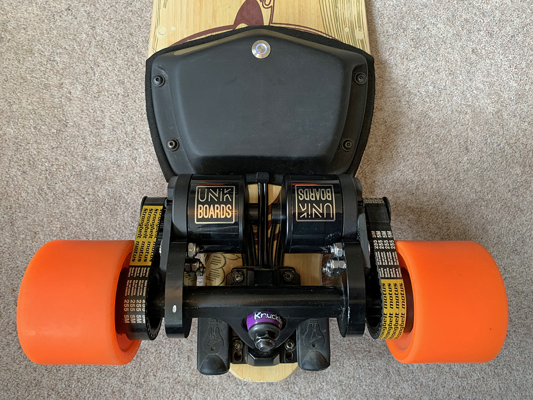

A look at the back of the Eskating mounts and previous generation Shredlights. The belts are from Belting Online, and are 255, which is the perfect length for this 32t/15t setup - there’s just the right amount of adjustability in the motor mounts.
A closer look at the motor wire management. This was bloody tricky to say the least. I’m using an Eskating riser with space for phase and sensor wires… but in order to keep the wires where I wanted/needed them, I had to use a combination of thin, double-sided tape and a quick action to flip the trucks onto the board while it was laid on the table. It took a few attempts but it turned out well!

I replaced the standard green (soft) e-Caliber bushings with these Orangatang Knuckles - night and day difference with better adjustability and overall ride feel, highly recommended!
Better look at the motor mounts, etc.

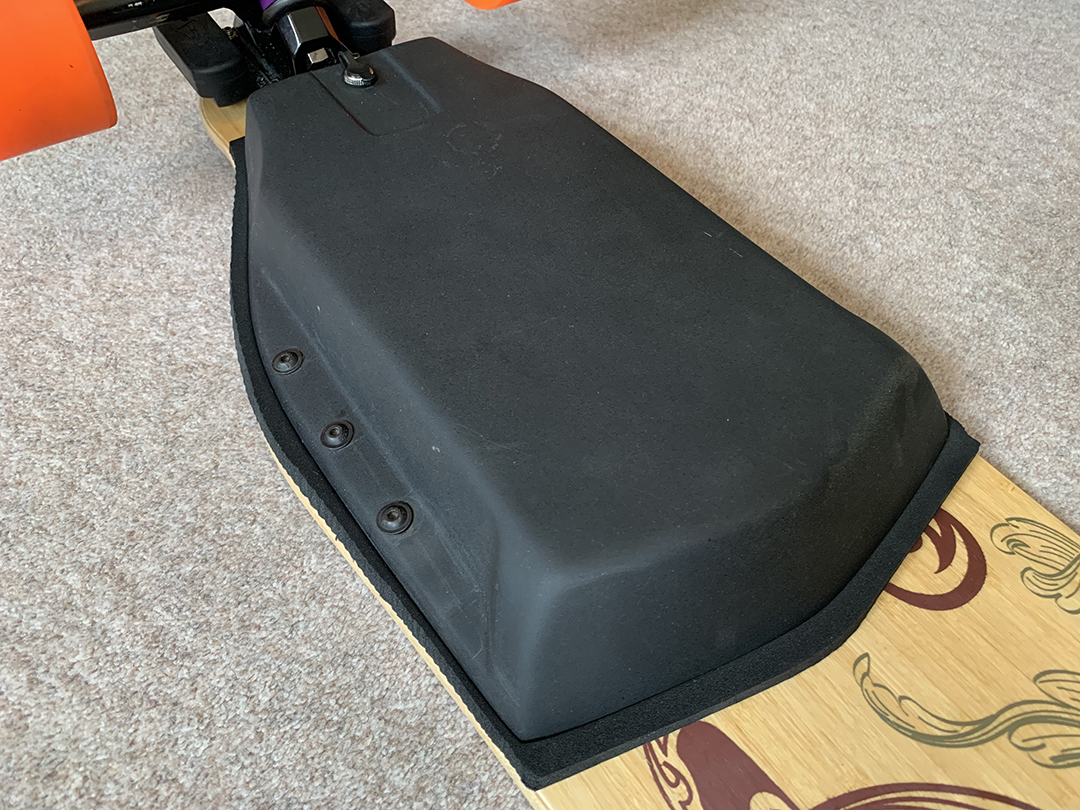

How the ESC enclosure looks now!

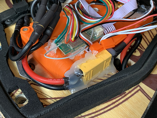

As well as the Unity, we have a Metr Pro module, which is epic… and is the only way I can see what % of battery I have left, as the Smart BMS is charge-only and doesn’t keep track of the battery % properly.
Close-up of the Metr Pro module, as well as the XT90 that comes in from the board. I had to use some extra strong glue under the connector as the vibrations kept knocking the hot glue out of place. It still looks VERY DIY haha, but it’s solid now! The same glue was used on the Metr module and antenna.

I may trim the bottom of the foam… it works :man_shrugging:t2:
