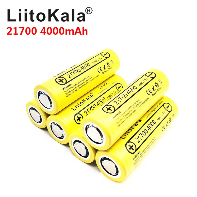

This is probably my 4th battery build, or so, and i decided to just say fuck it…and for science lets try this budget cell. I know people had varying issues with the liitokala 30q knock offs… which still kinda intrigue me BUT the last reviews of this cell online were a year old BUT they also showed good specs “as advertised” so I pulled the trigger.
20ah was probably a bit more than I actually needed as I had a 4p 30q in my board and got about 10mi per charge of medium hard riding. A 5p from the get go would have been nicer, and a 6p just to showoff =P
At any rate I chose a 5p of the cells as insurance if the cells couldnt perform at 15amp each as advertised I could use the extra group as buffer amps… so far so good… Ill link you to my first video… its going to be a 3 part video, 2nd video is almost done… and so far after a couple weeks of riding this pack the range is great… 60 mins non stop riding and my feet fucking hurt… with 25% left to kill…

I’d really like to know how these cells perform. From whom did you purchase these?
I assume that OP got them from LiitoKala Official Store
zero room left in the case for my watt meter but was totally the plan… at some point when I get a free moment Ill have to solder some extension leads to run the wires out of the case to the meter and back in to the unity… im curious too about what data it has to offer.
if you click on the pic you can see the numbers on the foam… pen was weak… but only .06 from lowest to highest… grouping made the balancing job easier in the end
yeah Liito official store… was $185 shipped for the lot and arrived in under 3 weeks…

Conclusion
The cells has the rated capacity and capacity is fairly constant with load, but they do get rather hot at high current. This means they may handle high pulse current, but 20A or more in constant current is not a good idea.
so i guess the take away is it’s slightly worse than 40T but at a 3+ p config it shouldn’t be a problem and ofc the more the merrier.
heres comparing them to the sanyo 20700b . I know these are 1mm wider but thats really neither here nor there. Seems like sanyo is slightly better in the first 50% but these seem to blow the sanyos away in the last half and less than half the price.
What am I missing? these seem like an absolute bargain
So seems safe at 15a x 5p = 75 amps. fucking plenty.
And yeah, dont do 20a on these
Heres the prices for a 10s4p setup. Half the cost for arguably better performance.
