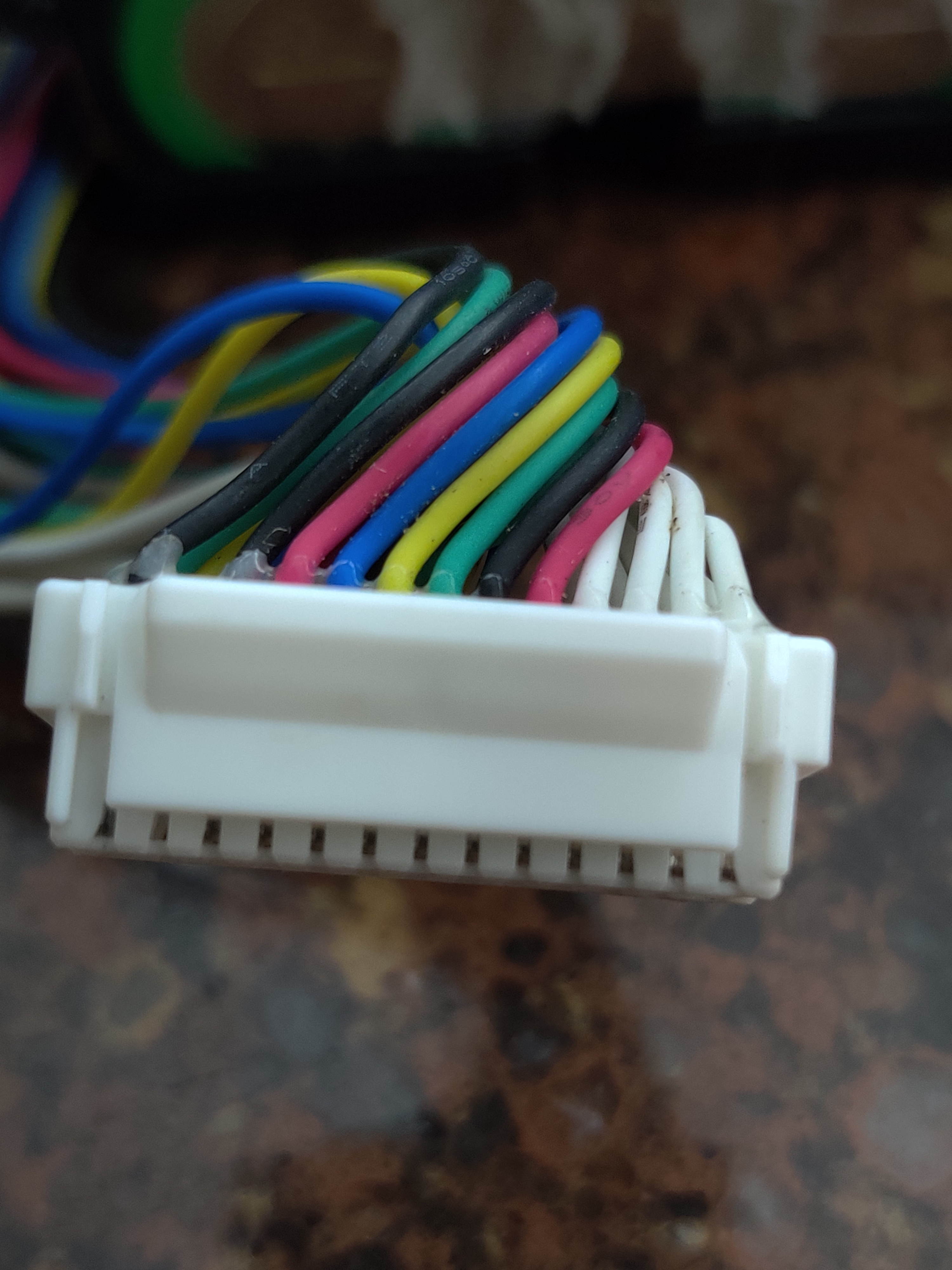

Can you give me the clearest possible picture of the pins on the connector and a pic of the connector from the bms.
I’m tempted to say jst PhD or jst pbd but I can’t quite see the connector clearly enough
Oh god…I’ll see what I can do
I have half a mind saying to steal this harness and figure it out later😜
Do you have a pic from the bms connector?
I’ve never seen a dual row connector quite like that
Let me see if I can find one
@Lunartic i fucking found it. I have good and bad news which ones you want first?
:stuck_out_tongue_winking_eye: Always dessert first
The good news is it’s called a JST ZND
The bad news is that it’s so freaking niche that I couldn’t find a single retail version for sale
I might know someone who has a certain set of skills
Yeah might just tell my buddy we are taking this one off his current battery so we can get this project moving unless anyone has a source on a 26pin JST ZND connector :stuck_out_tongue_winking_eye:
Atleast now the search is rendered slightly easier :joy:
You are awesome! I hope one day to return the favor!
I’m just intensely good with research :wink:
Must’ve helped to have a catalog of connectors :rofl:
So close… I believe its a Jst ZPDR 26pin😁
https://www.digikey.com/product-detail/en/jst-sales-america-inc/ZPDR-26V-S/455-2536-ND/2472569
Finding a prewired harness is the tough part!
Quite possible, both are very close in specs and dimensions
