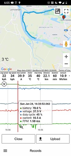

Some strange % voltage sag happened during last ride (but the actual voltage graph looks ok to me)
No throttle for about 0.5-1 sec
Happened only once since 2.500km on that board but twice during that ride (the second one without that strange “no throttle” issue)
Any ideas? Thank you in advance
Upload the actual metr data please not screenshots please.
Some sag is to be expected. Keep in mind the actual ESC is sampling at 10 kHz while this plot is only at like 20 Hz, so it is very possible to miss data in the graph that will be reported on the fault data. Impossible to tell why you would experience a cutout without the data from the ride where is happened.
