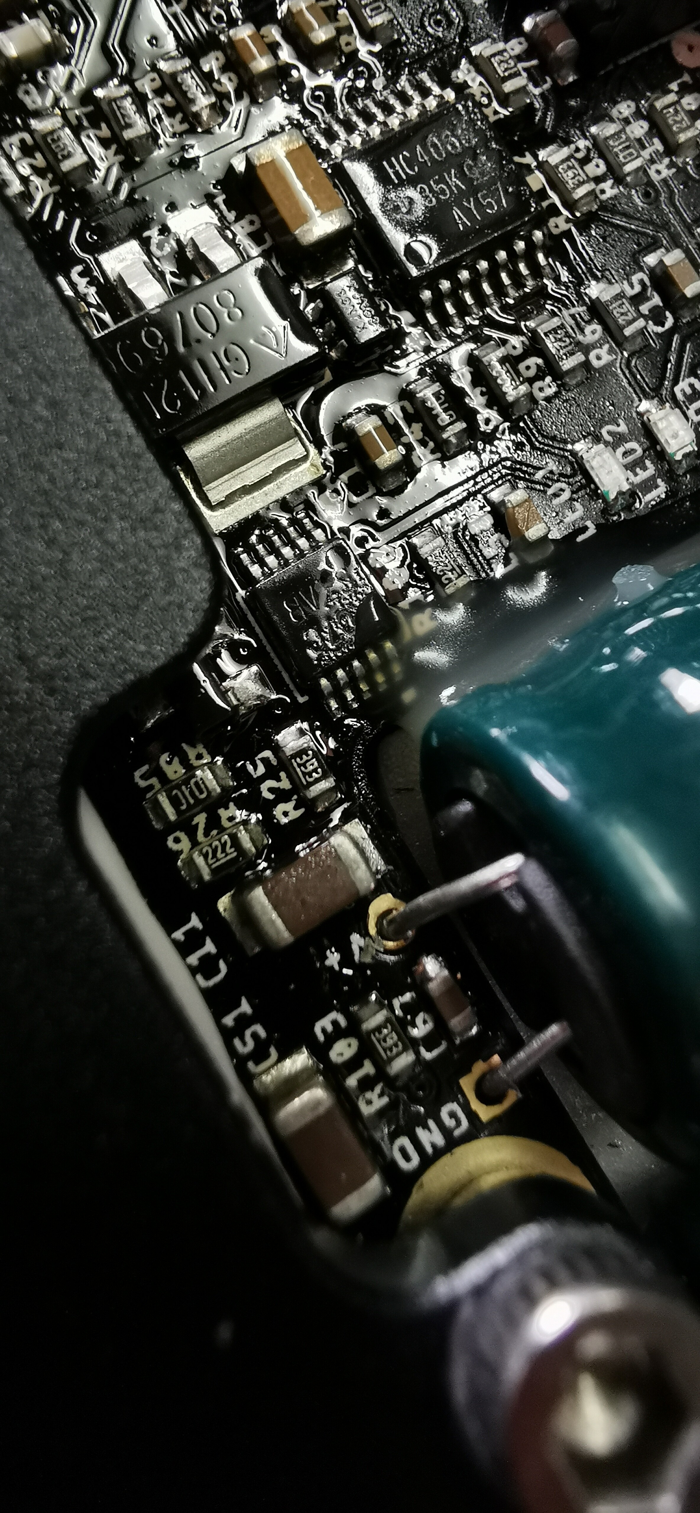

Yes, the Unity itself, measured here:

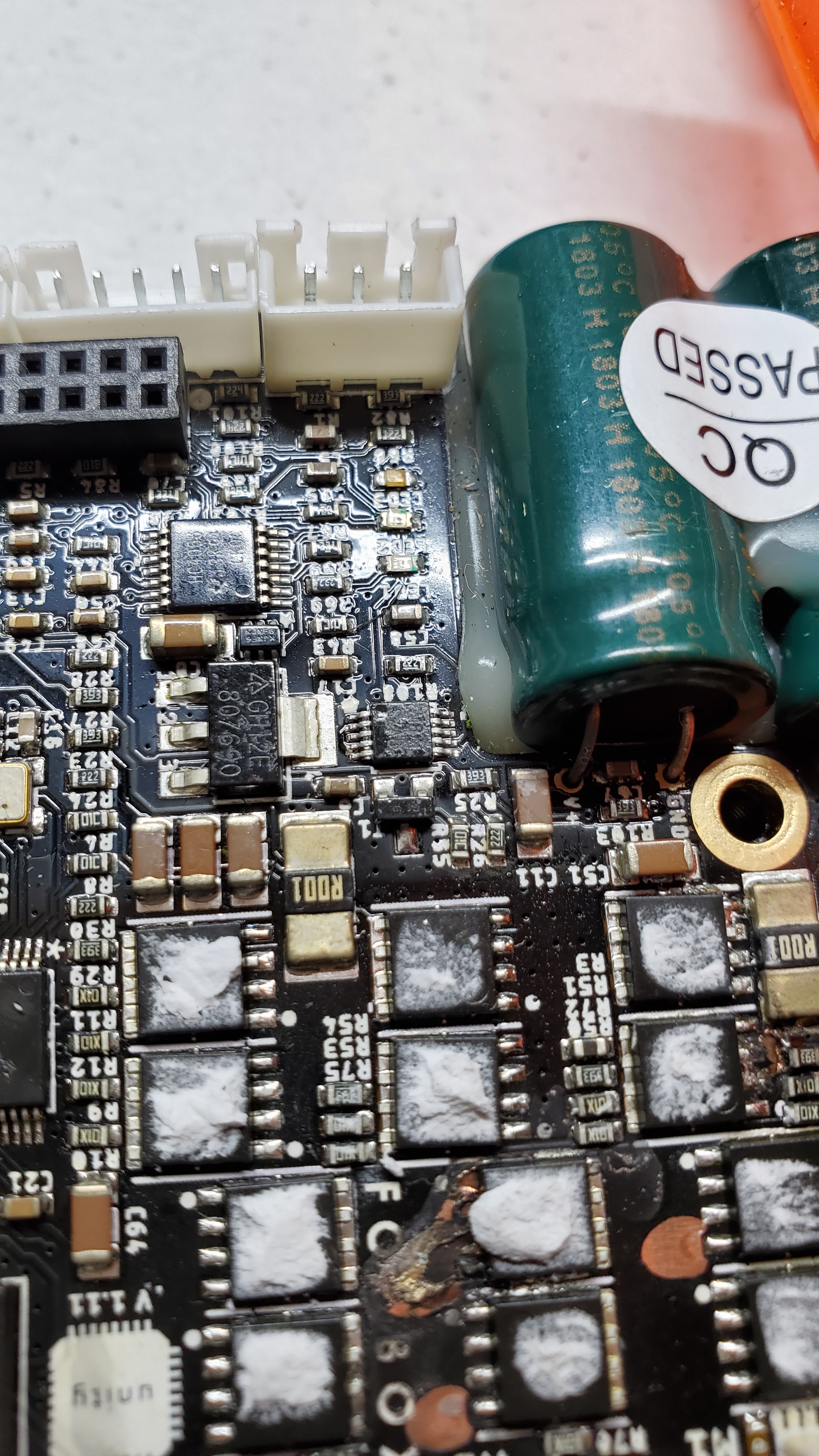

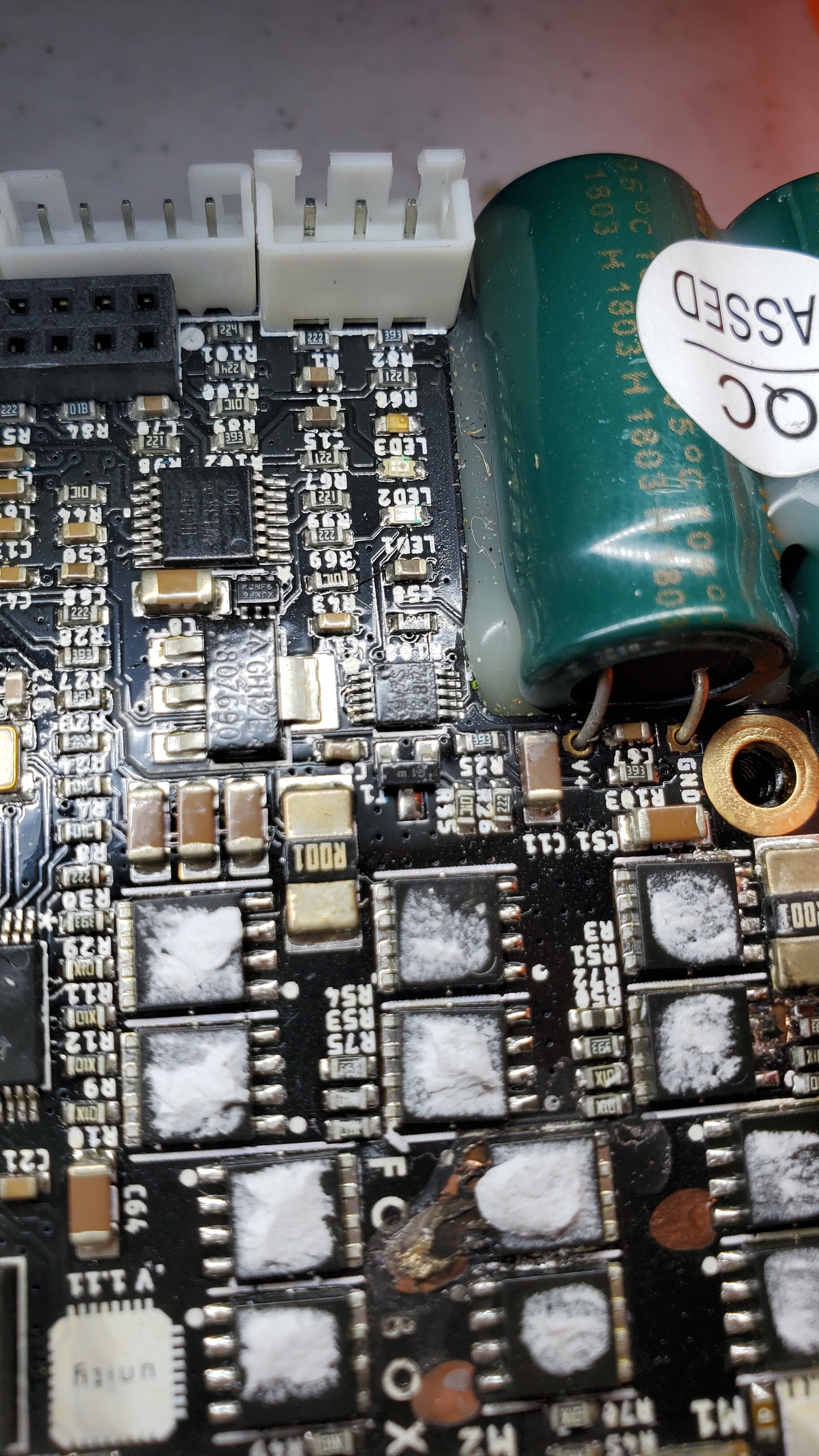

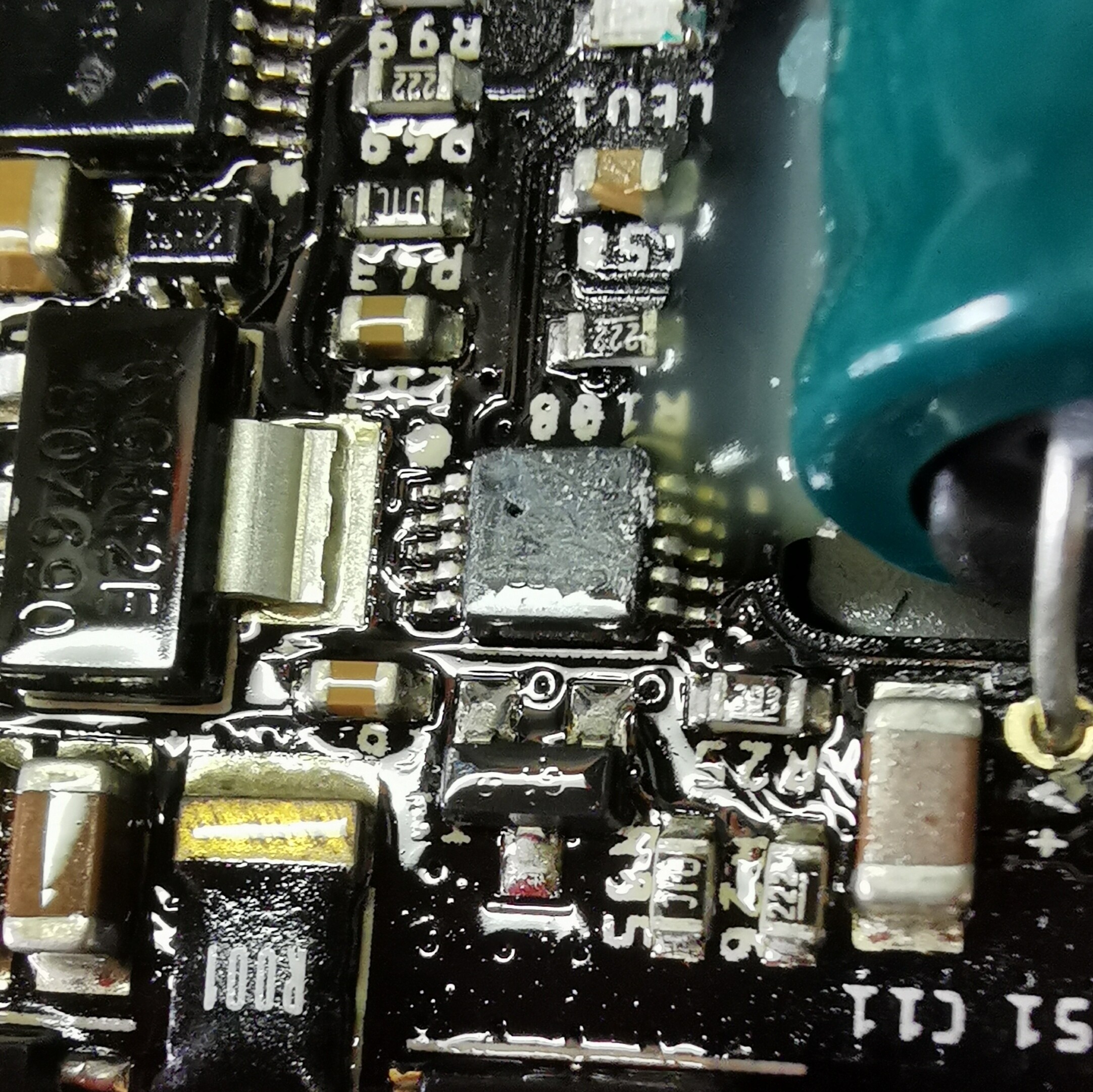

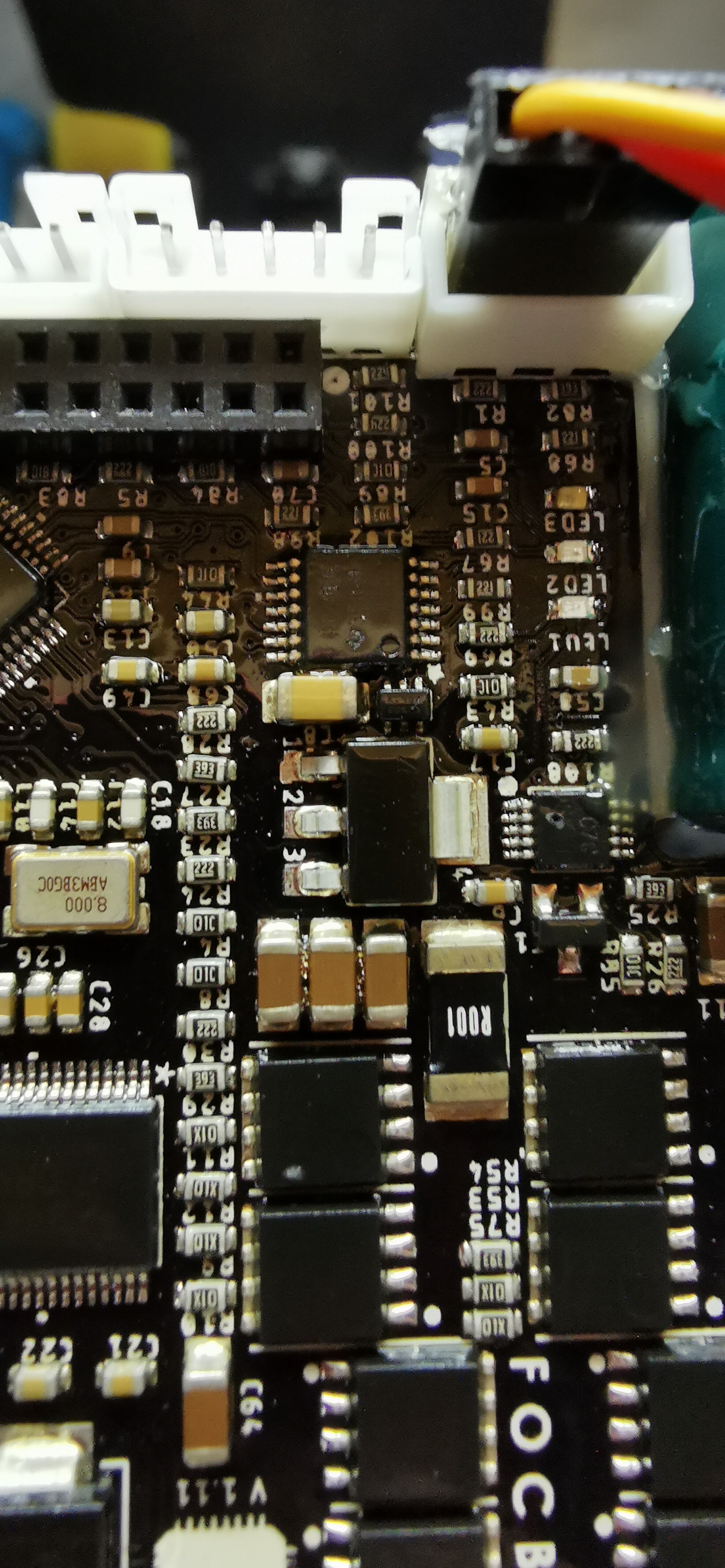

It is difficult to see… is this blown? It’s the charge pump for the transistors doing the precharge.
I guess you have zero volts across the big capacitors when you try to power up?..and that would be why its dead stationary but alive when being powered backwards during regeneration from the motors.

No, I don’t think so. Everything looks kosher. The application of the conformal coating is definitely questionable but nothing looks blown.
…and zero volts across the caps, yes. To be clear, the unit is totally unresponsive if I try to power it up.

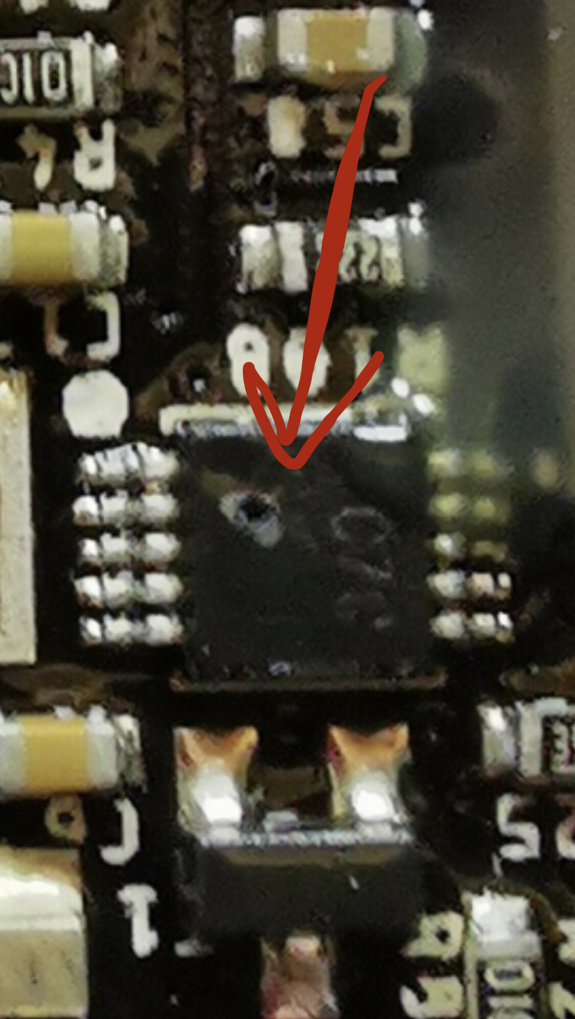

It’s toast… this component should not come with a hole in it :grin:
It’s not a hole. It’s just the way the light is catching the poorly applied coating.
Your picture still does not convince me… it still looks like a hole… coating burnt off :grinning_face_with_smiling_eyes:

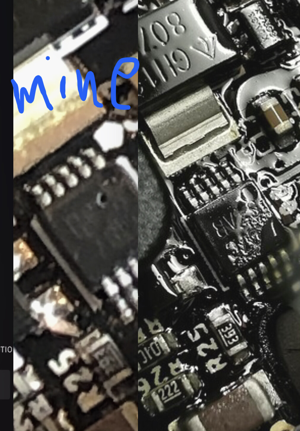

You might be right. Its just that the unities I have reworked have had a hole in that component on that same place
Perhaps scraping the coating off will reveal the dirty truth?
Well I’ll be damned.
You’ve got a hawkeye there, @Fatglottis.
What’s the fix? Replace it or rip out the a/s?

Interesting… My blown unity has a divot there but no hole blown through it.
You got some fine peepers @Fatglottis :eyes:
In this case I suggest removing it. It’s just sad if it breaks again, also I don’t know about the status of other components in this circuit now.
Yes that divot is there as a marker to show the leg orientation so that the IC is not accidentally rotated 180deg.
My laser vision tells me your unity has more severe issues :grimacing:

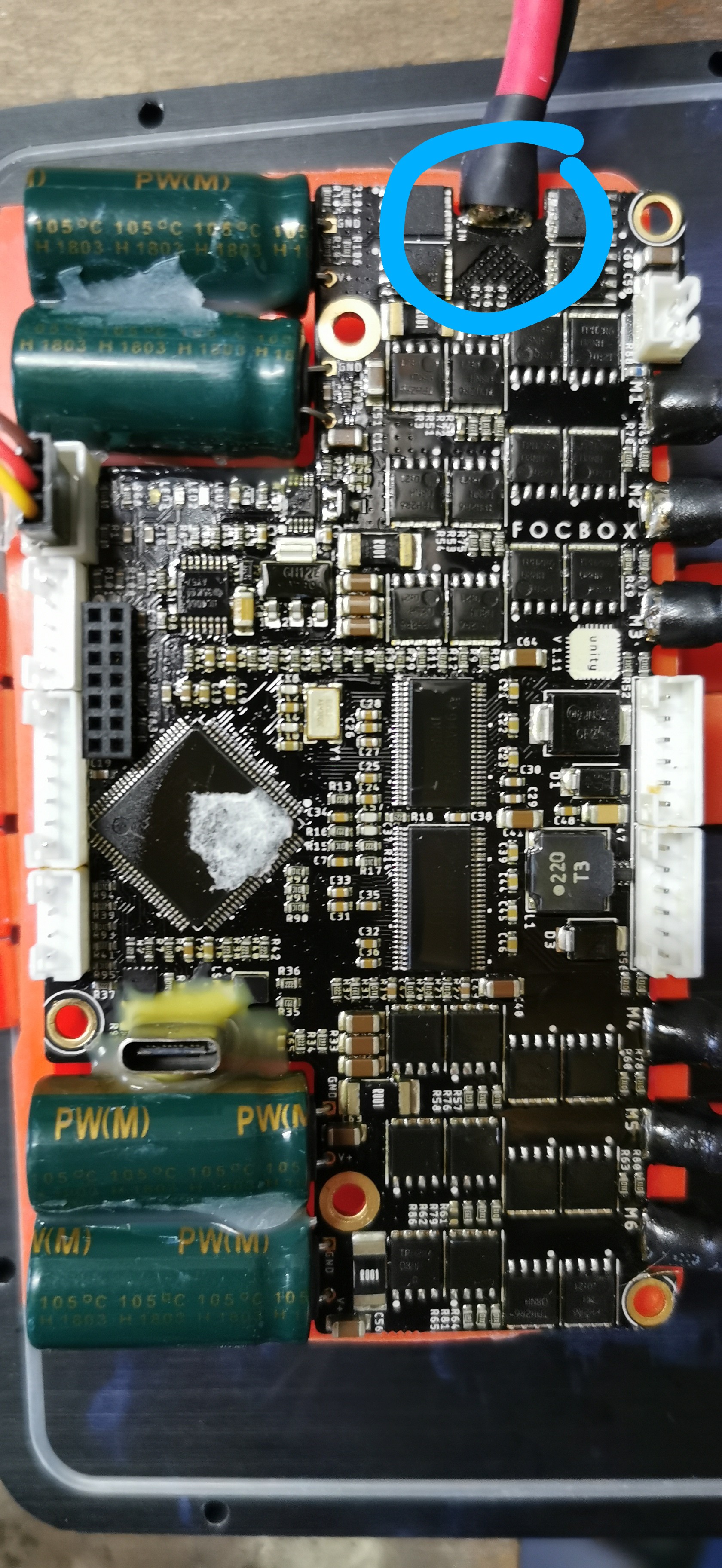

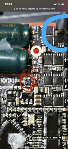

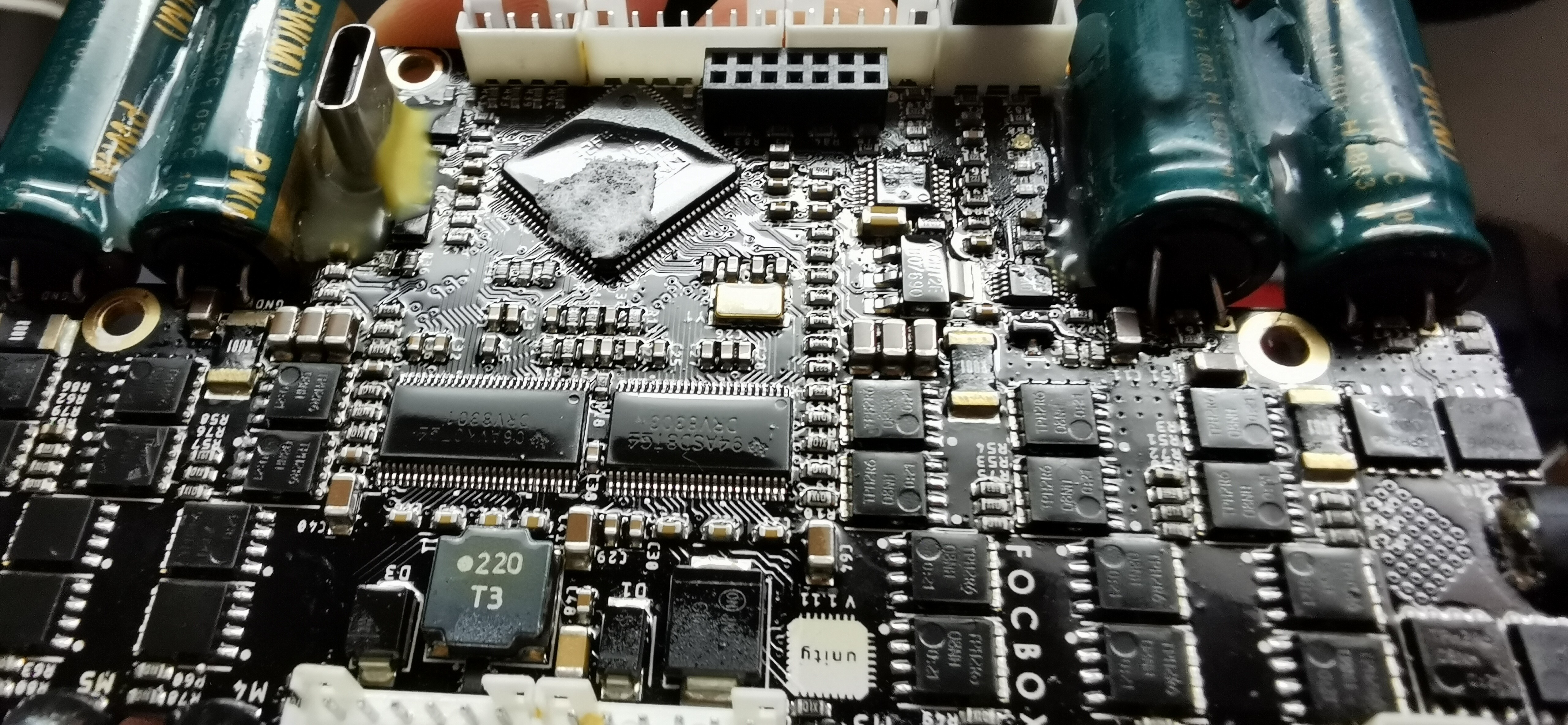

On the bench under no load too. I think I got home just in time to avoid a bad situation.
