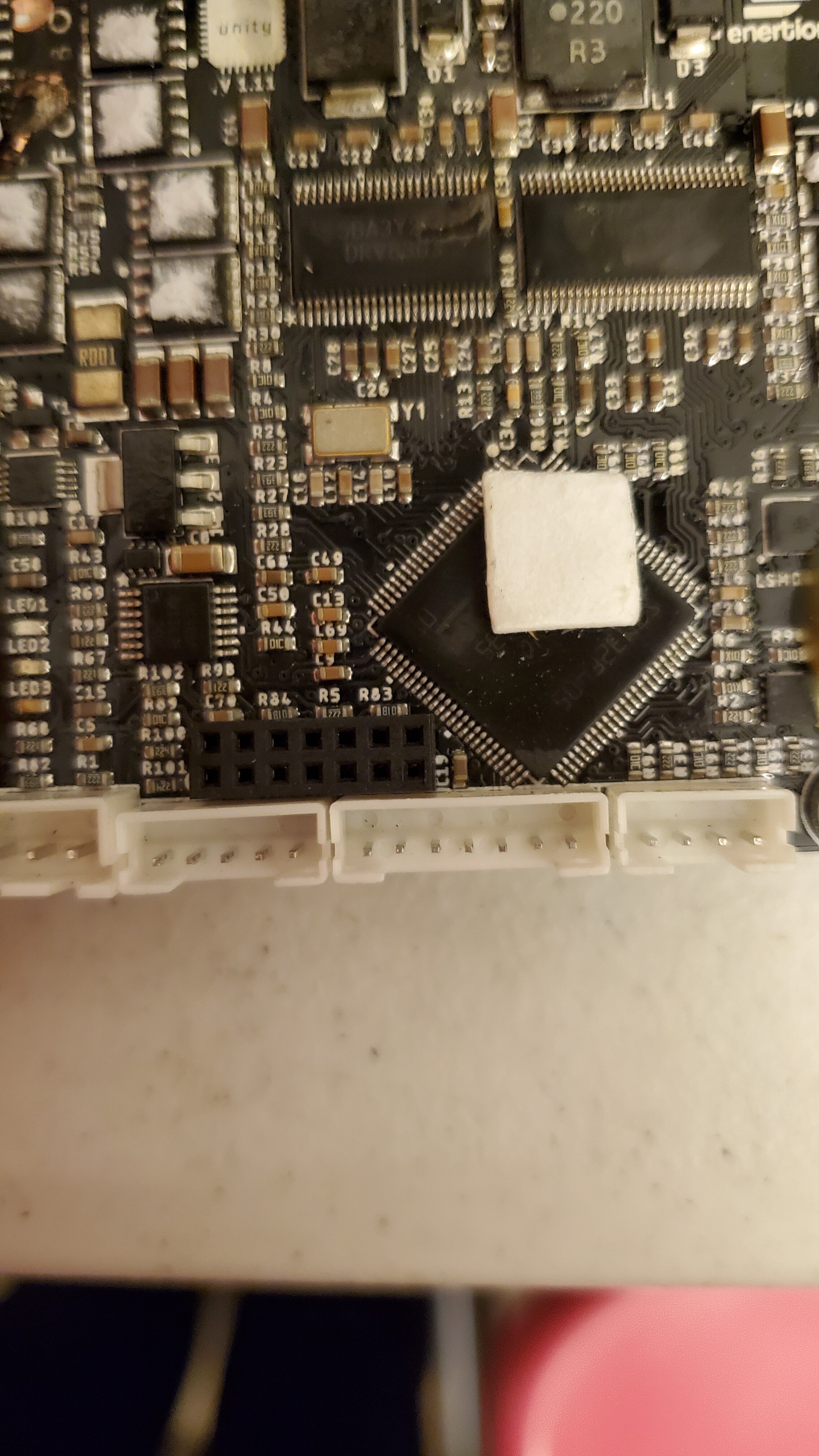

Sadly it was not super obvious to me. I’ll try and remember to send a photo of my blown one when I get home but forewarning I’ve been drinking.
I’m guessing but:
miso/mosi/ss/sck go together.
and sck is serial clock. I’m guessing that’s CLK
and miso is master in slave out. I’m guessing that’s IO
but rx/tx/3.3/ground I think are all that are needed fo uart connection anyhow.
Not very telling
The main issue with this port is that it uses a different (and fixed) baudrate than the other uart port. Changing this value require rebuilding the firmware. @Nick_Leet3D rebuilt one with the correct baudrate for the Davega here : Unity internal UART wiring
I didn’t try to update my unity yet with it, so please share your results if you try it :wink:
IO and CLK are for SWD programming of the BT module. So others would call them SWDIO and SWCLK and they have nothing to do with SPI.
But you are right that only RX/TX/3.3V/GND are needed for UART. You can just leave IO and CLK unconnected @Clunt.
I remember someone was asking about the wiring for the unity BLE module, so they can use that port for something else, or maybe my memory is a bit fucked due to working during holiday :crazy_face:
Yep, that was me, in the post i shared just above :wink:
