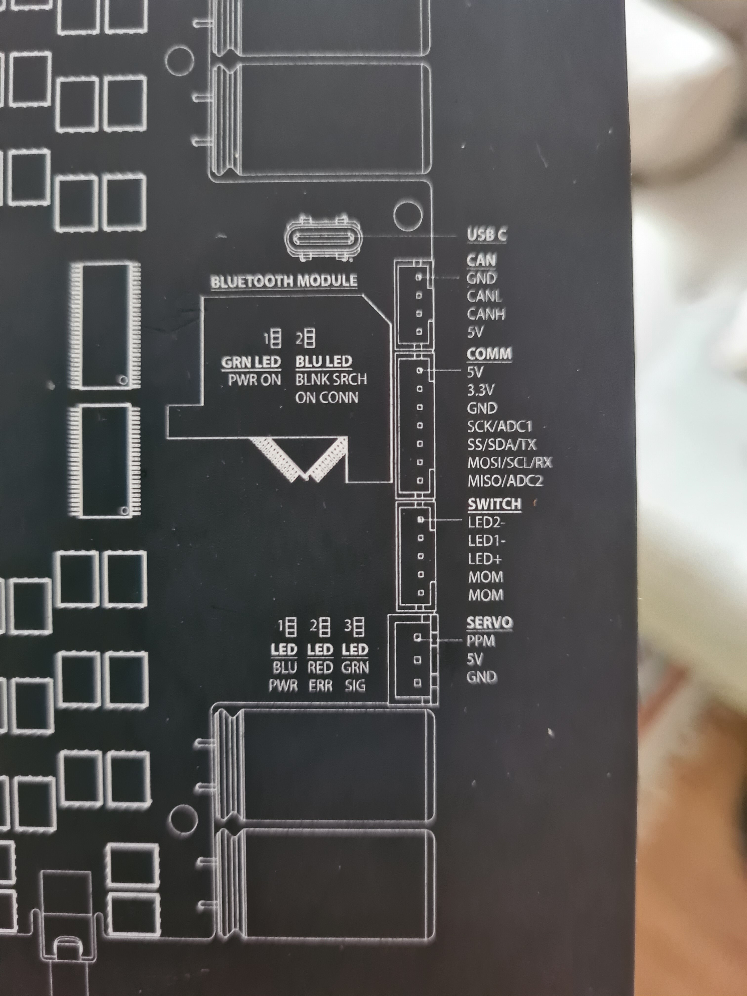

What do we know about the com port on the unity that the ble module connects to? Would it be possible to get the required signal from it into a usplit, then run a davegax and metr from the usplit outputs?
I have the vx2 on the main com port and don’t want to run the usplit on the remote
Here you go
I wonder which pins correspond to the “io” and “clk” they’re not pins the other comm port has labeled.
They might be obvious on the unit if I hadn’t used thermal adhesive to attach to heatsink lol
