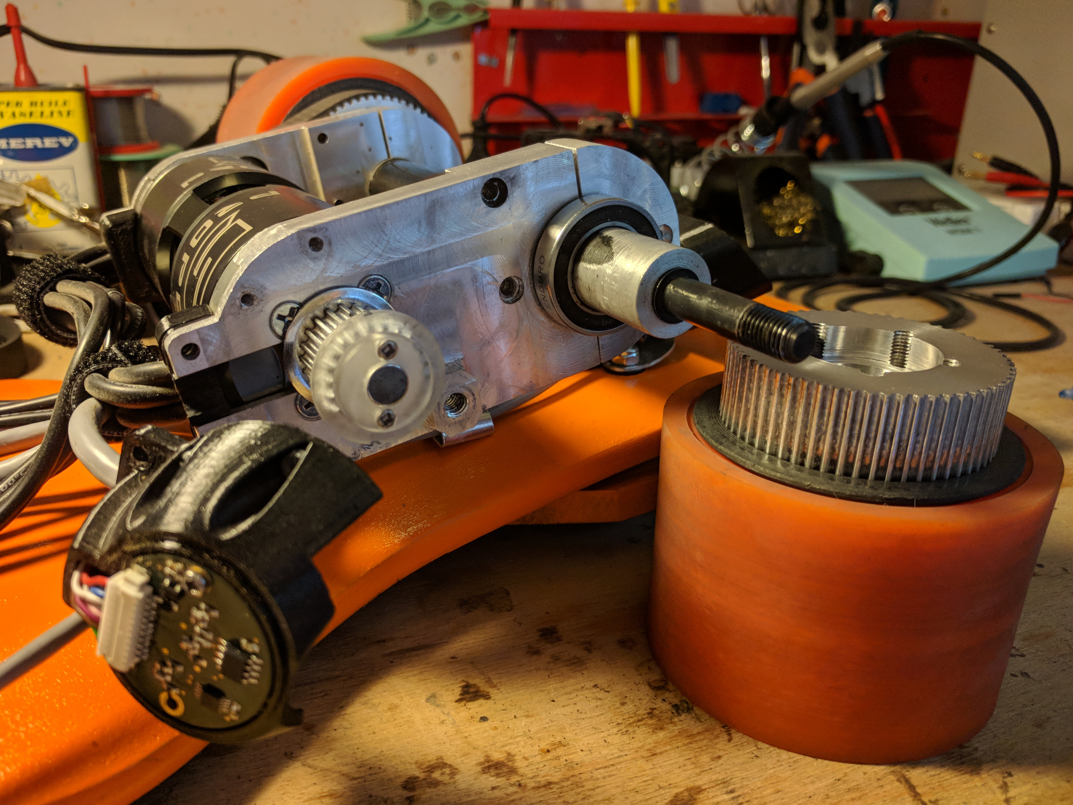

  • Motors: dual NTM propdrive from HobbyKing, 5060, 270 RPM/V, modified termination (delta to star) which results in 156 RPM/V.

  • Transmission: 3MGT 15mm synchronous belt, aluminum pulleys, 21/60 gear ratio, because I wanted to climb steep slopes, and I am afraid to go fast.

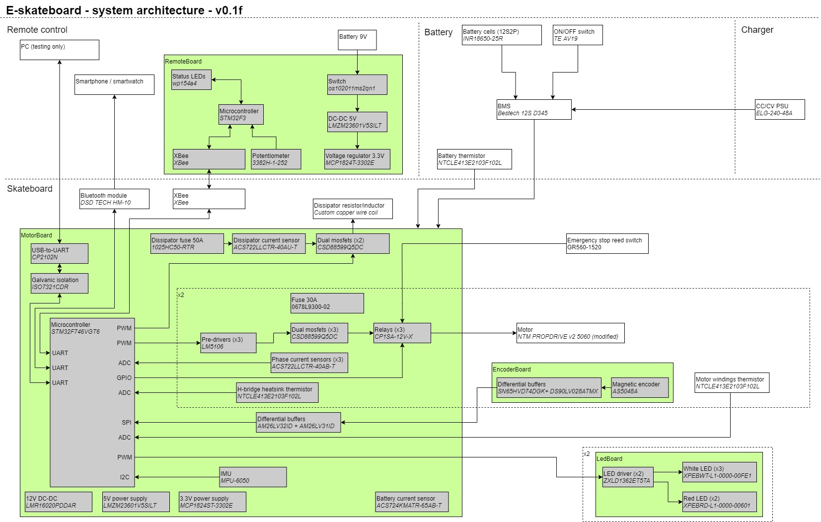

  • Electronics: custom design (more on this later).

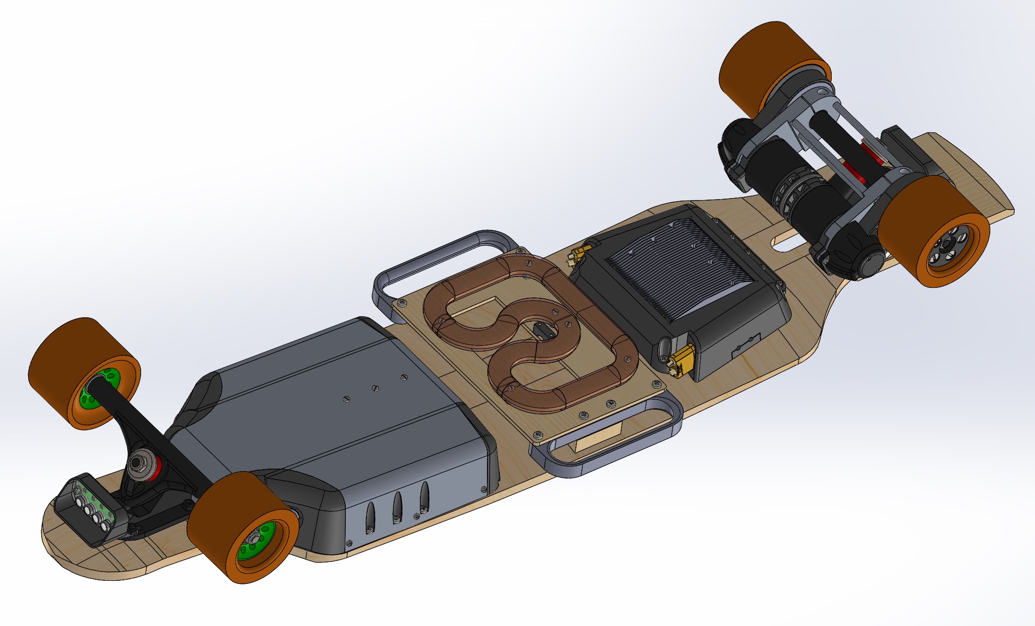

The CAD design was done with Solidworks. Notice how clean it is, when you omit the cables.

Motors: the motors termination was modified from delta to star, to lower the KV from 270 RPM/V to 156 RPM/V. A thermistor was also glued to the windings with thermal epoxy. Finally, a flat was ground on the motor shaft.

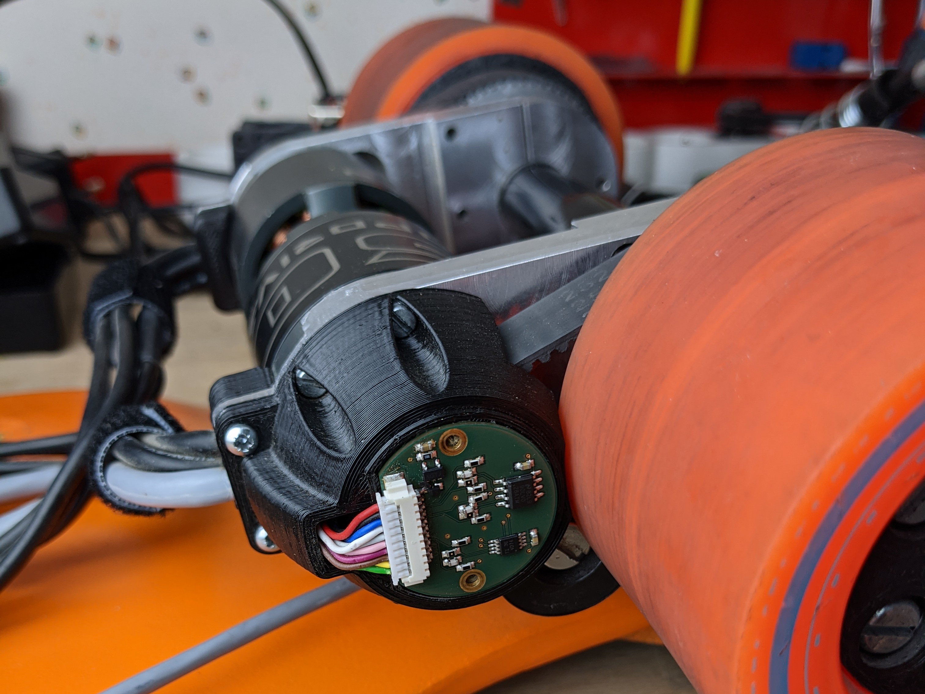

Motor mount: since the Paris Trucks have an irregular conical shape, the lathe was required to obtain a nice cylindrical face and attach the motor mount properly. The motor mounts were machined out of a block of aluminum, with a conventional milling machine (I don’t have access to a CNC unfortunately). There is an idler pulley to prevent belt skipping without having to tighten strongly the belt. These were 3D-printed and fit around a ball bearing.
Pulleys: both the pulleys and the belt were ordered here but needed modifications. The motor pulley needed a grub screw hole and a magnet holder for the magnetic encoder. The wheel pulley was modified with fixation holes and a hole for the ball bearing.

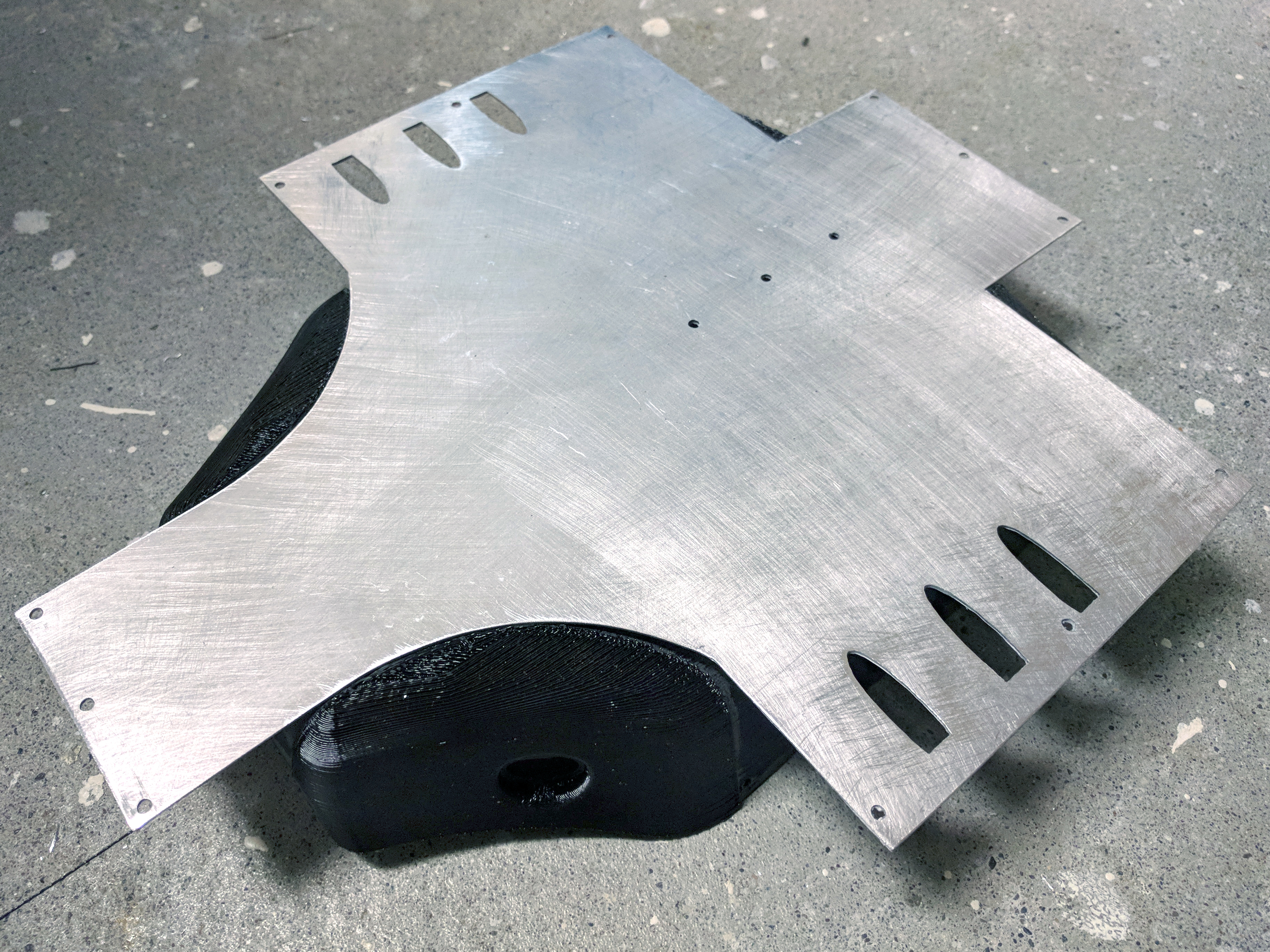

Battery enclosure: a fully 3D-printed enclosure would probably be suject to fatigue stress, and crack between the layers. A full aluminum enclosure would be ugly, because limited to simple angular shapes. This is why I made it based on a folded aluminum plate, with 3D-printed corners.

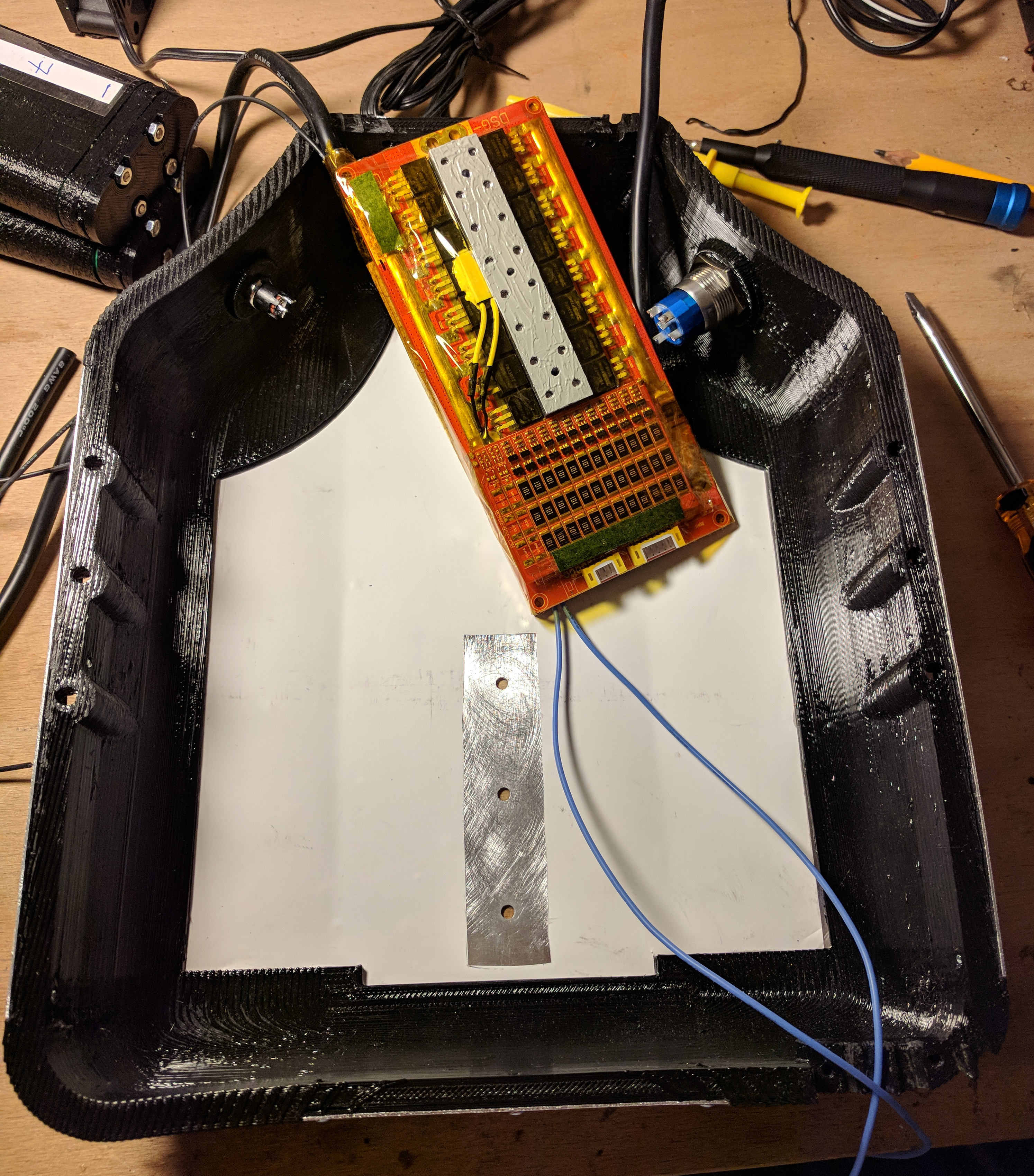

BMS: the stock heatsinks have been replaced by a threaded block of aluminum. This block is then screwed directly against the aluminum wall of the enclosure, with thermal paste for maximum heat dissipation. I really don’t want this part to fail.

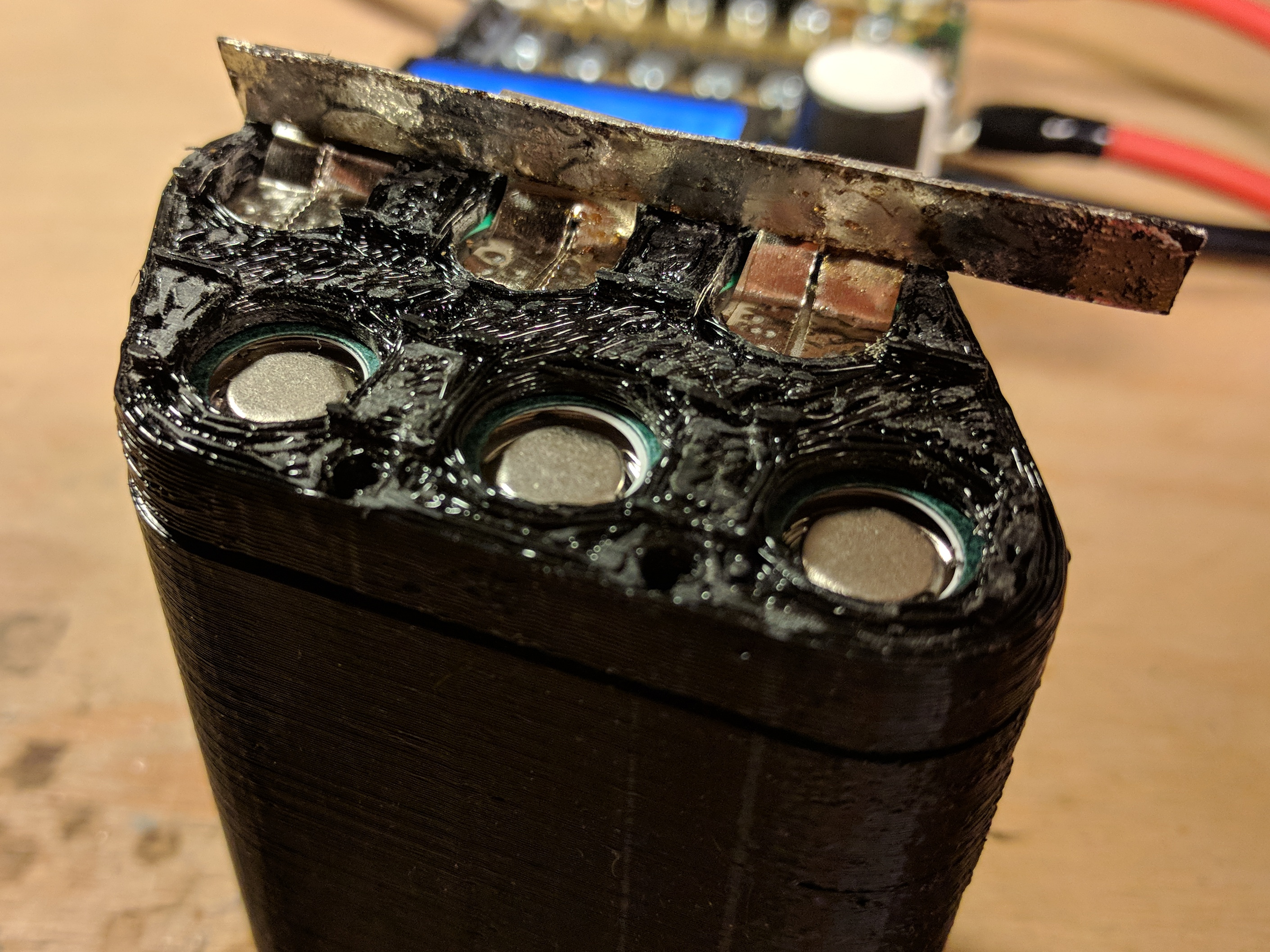

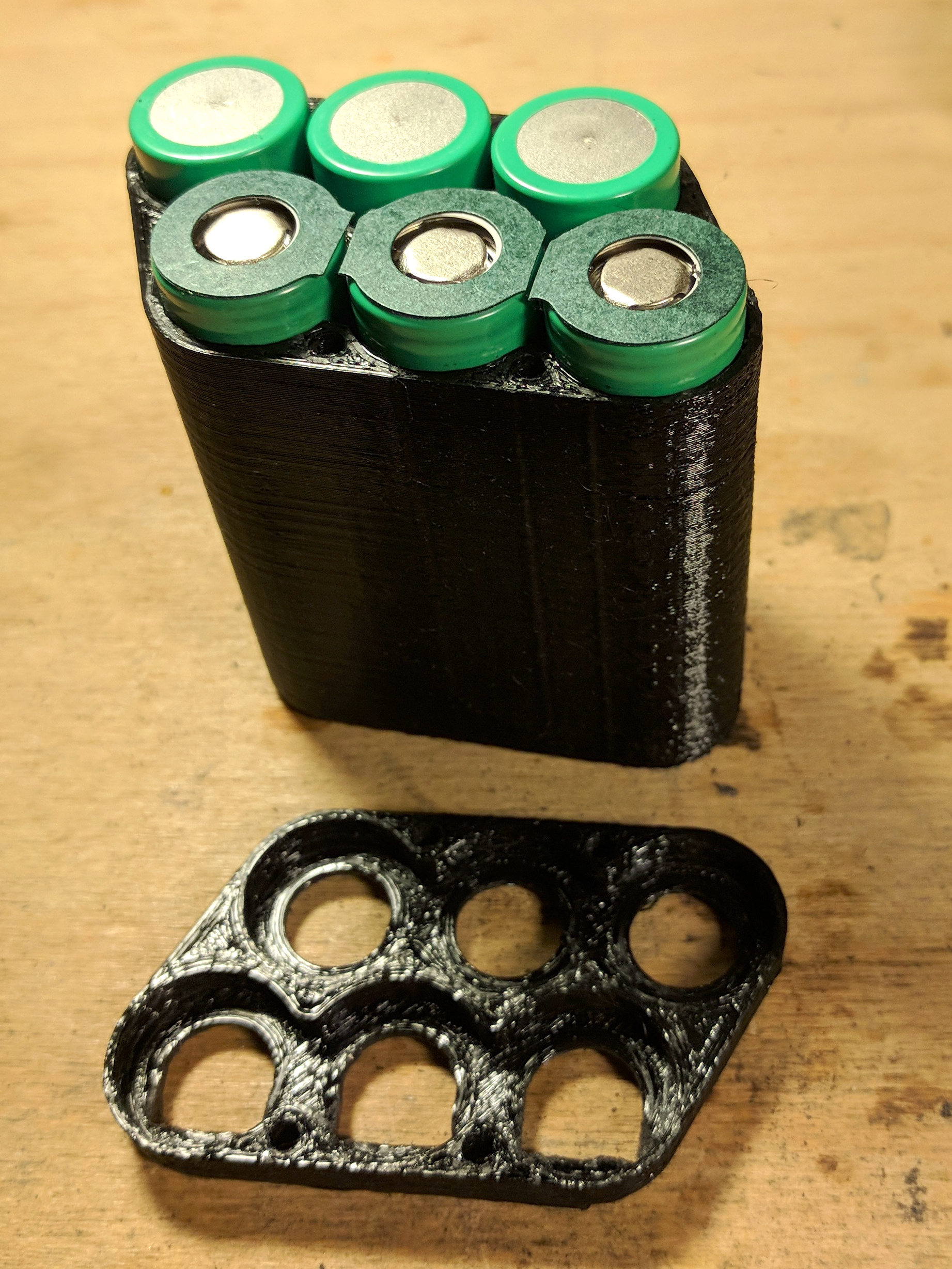

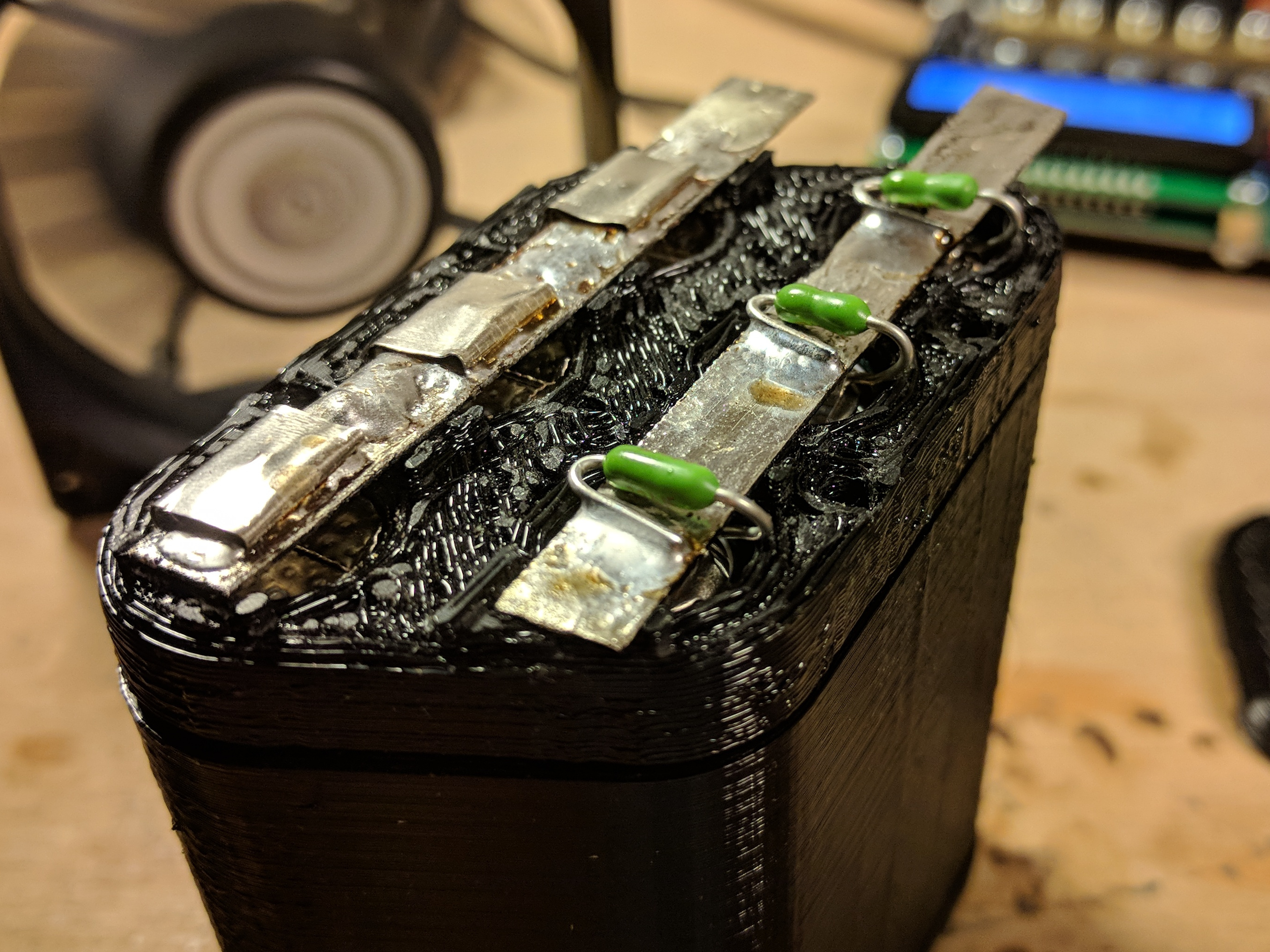

Battery: the battery was challenging to make, because the deck and the enclosure are not flat. I also wanted that the cells are mechanically protected, and that the insulation never only depends on a thin piece of fishpaper or kapton tape. So, each P-group (or pair of P-group) is enclosed in a 3D-printed plastic enclosure, to protect them mechanically and prevent short-circuits between P-groups. They include supports for a copper bus bar, and you get tabs outside to solder your cables on. The nickel strips are first soldered to the copper bar, then spotwelded to the cells. An advantage of this design is that thanks to the looseness of the nickel strips, the spotwelds will never be mechanically stressed because of the possibly different thermal expansion of the cells and the nickel/copper. The positive side of each cell is connected to the bus bar by individual fuses. I was not able to solder reliably the fuses leads directly to the cells, so I soldered them first to a small piece of nickel, that I can spotweld it on the cell. Each balance lead is also fused, and the charge port too. The assembled battery unfortunately looks ugly because of the balance wires and the hot glue to secure the cells modules and the cables. This one is safe, but I’ll definitely look for a better design next time, which optimizes the wiring layout. Or I’ll just choose a stiff deck.

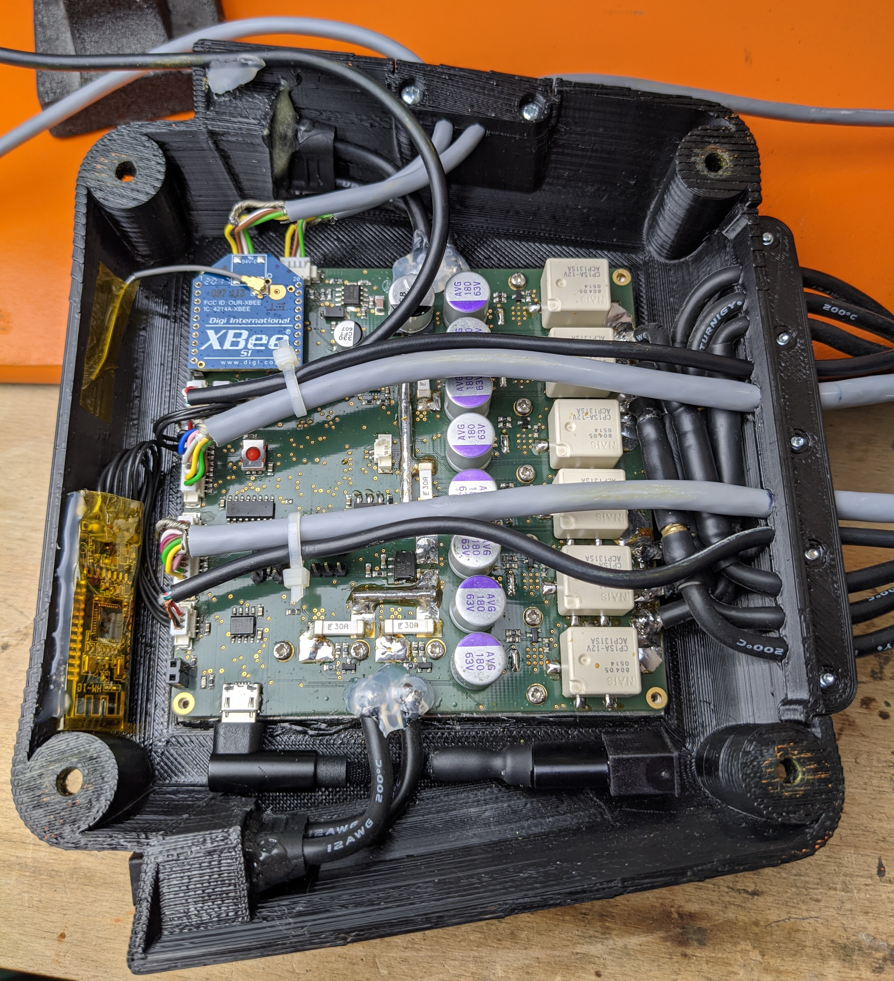

Motorboard enclosure: made from a large heatsink at the bottom, and 3D printed walls on the sides. Like all the other enclosures of this build, the outgoing cables are clamped with a dedicated 3D-printed part that is screwed to the enclosure, for strain-relief.

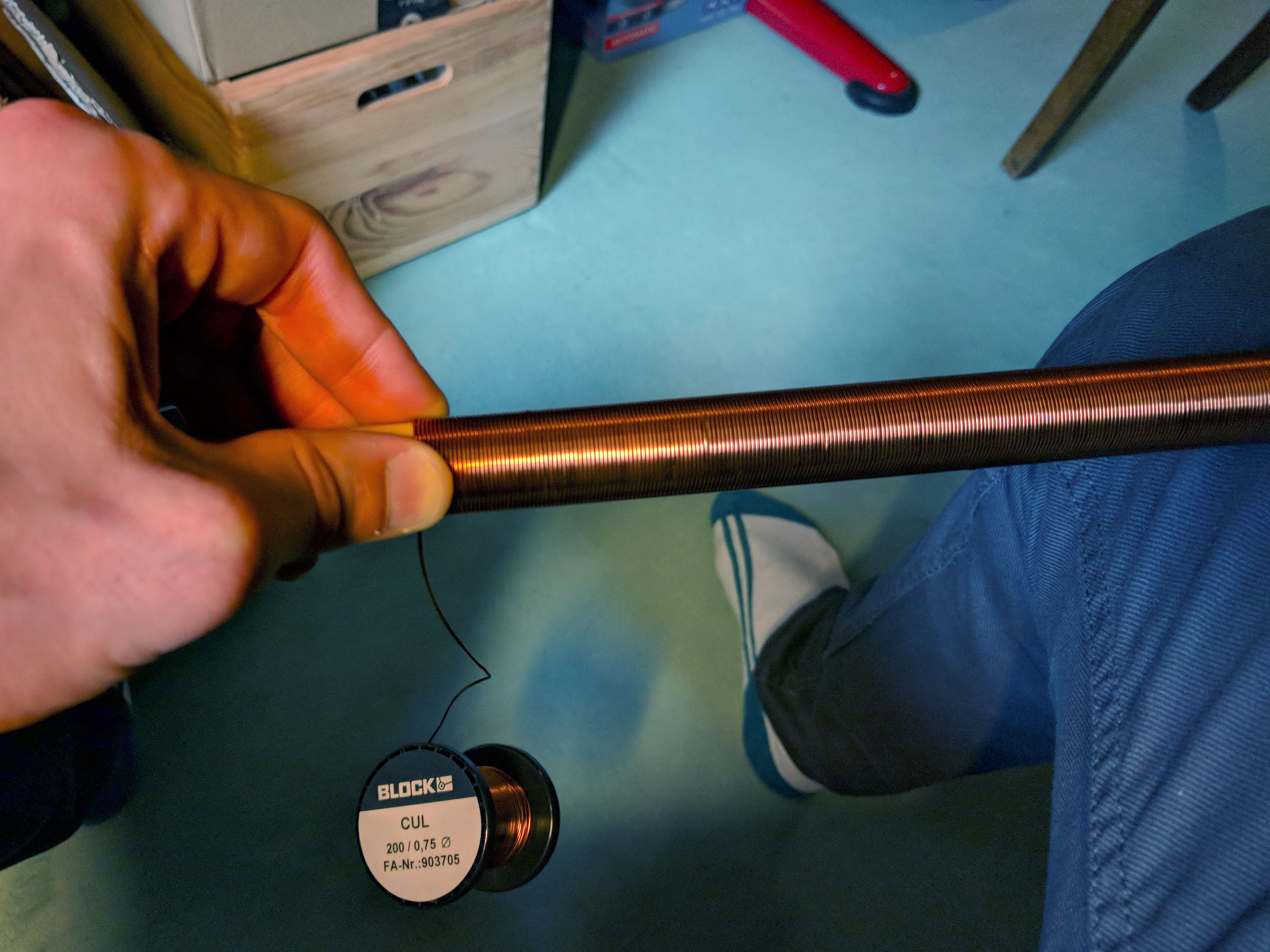

Braking power dissipator: I first computed the required wire diameter and number of turns to get the desired resistance and inductance: 400 turns of 0.75 mm diameter copper wire, to get 1 ohm and 150 uH, to keep the current ripple below 1 A. It needed to be custom because an off-the-shelf power resistor would be too heavy and does not have the inductance required to avoid excessive current ripple. The coil was hand-wound on a smooth cylindrical bar. A wooden plate was inserted to hold it and give it the compact shape.

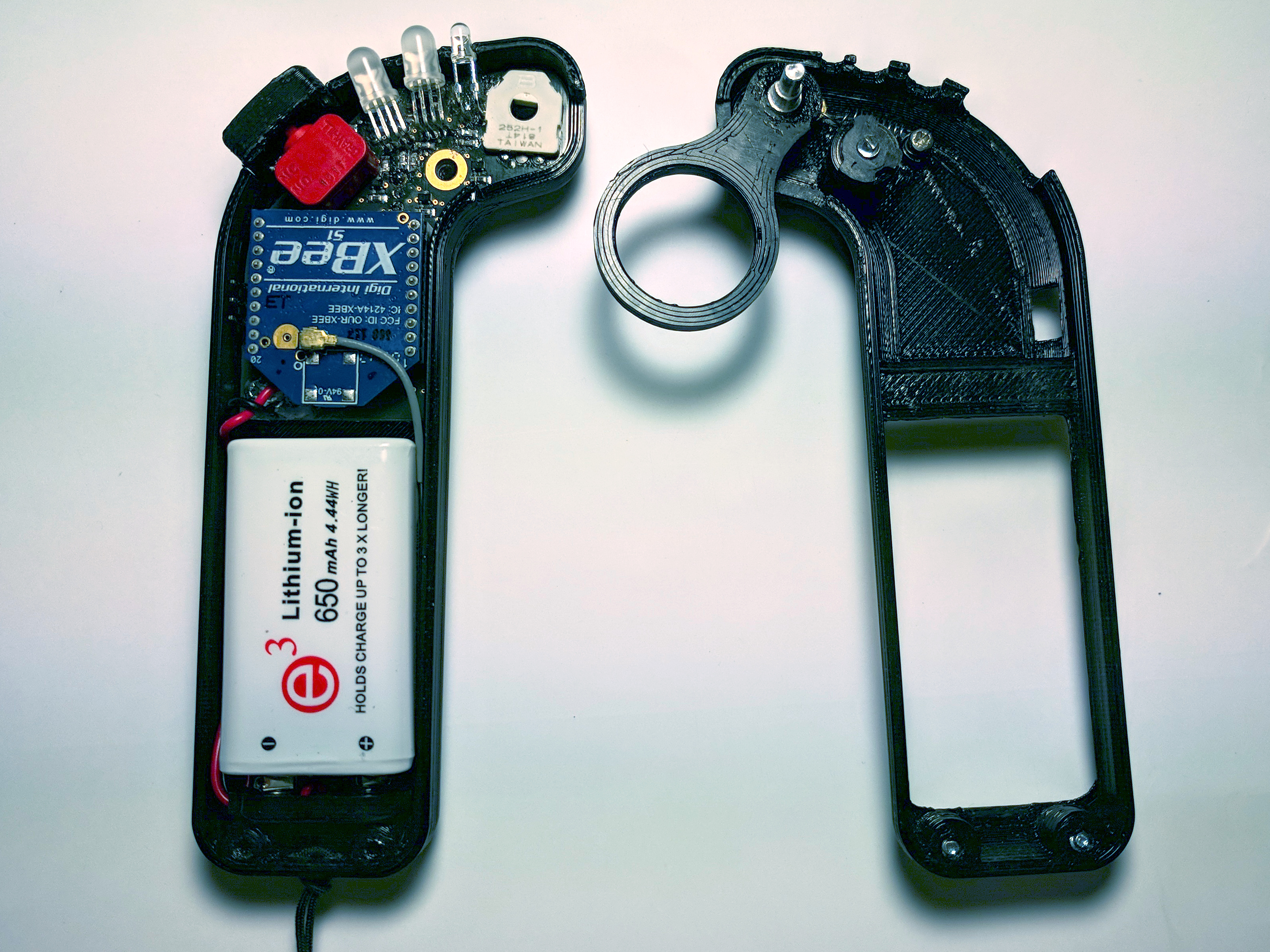

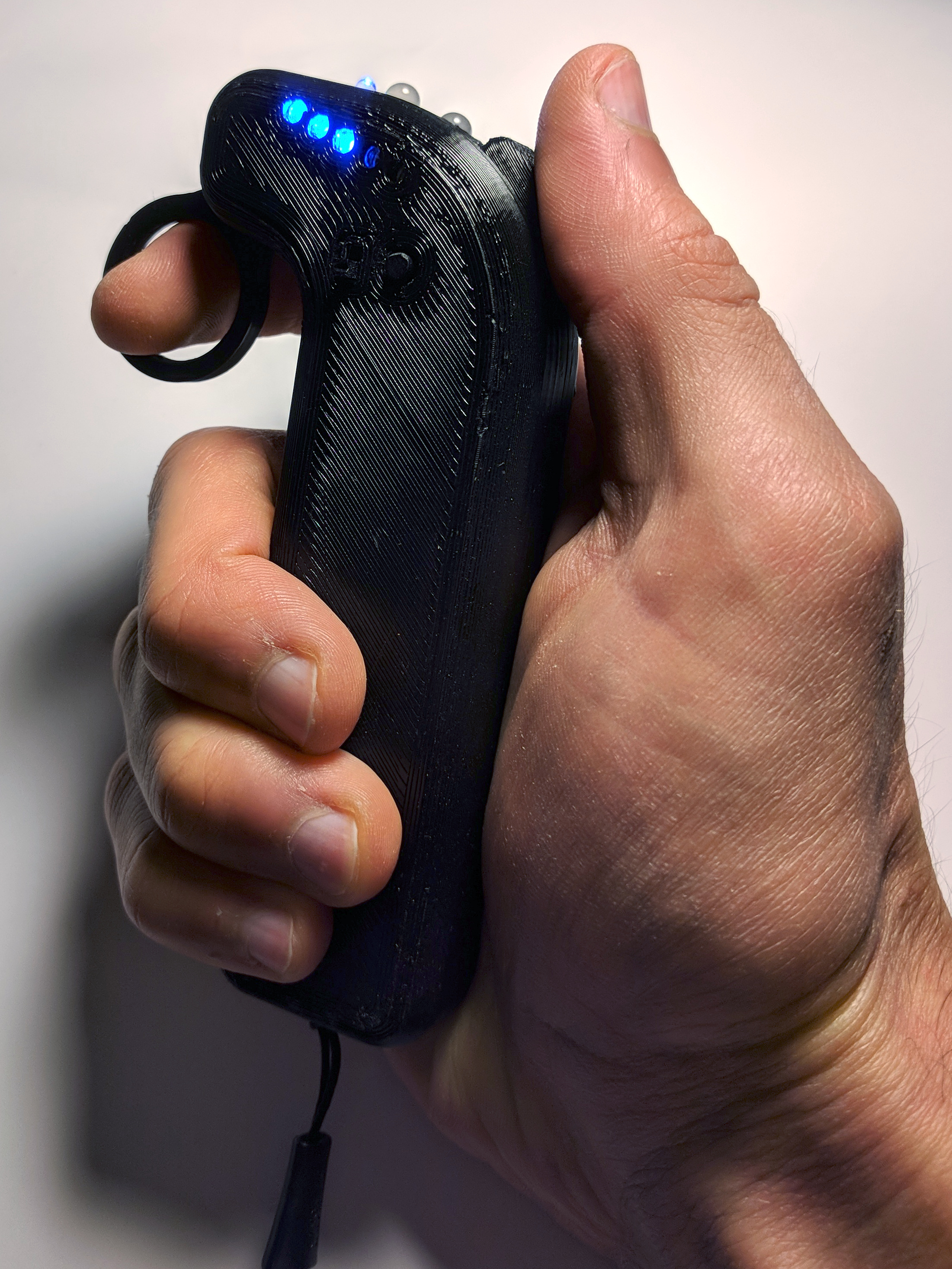

Remote: 3D-printed enclosure, the trigger shaft is guided with a ball bearing. It is powered by a rechargeable 9V battery, that can be easily swapped by another one. The motors current is controlled with a RC-like trigger, if the thumb dead man’s switch is pressed. The LEDs indicate the board battery level.

Motorboard: The mosfets are rated up to 12S and 30 A for continuous operation. The large components are on top, the mosfets are on the bottom side and fixation screws are between the mosfets, so it is easy to screw firmly a heatsink below. This board does field-oriented control (sine wave commutation), and uses a 50 kHz PWM frequency to avoid bothering surrounding animals. The electro-mechanical relays are connected to a watchdog circuit that detects if the microcontroller crashed and avoid locking the wheels. The H-bridges are individually fused, which should allow to keep the control of one motor if the opposite side fails. The communication with the motors encoders is through a differential SPI bus for maximum reliability. There are also analog input connectors for thermistors. Last but not least, the USB communication port is also galvanically isolated, since I don’t want my laptop to die in case of a serious issue with the board.

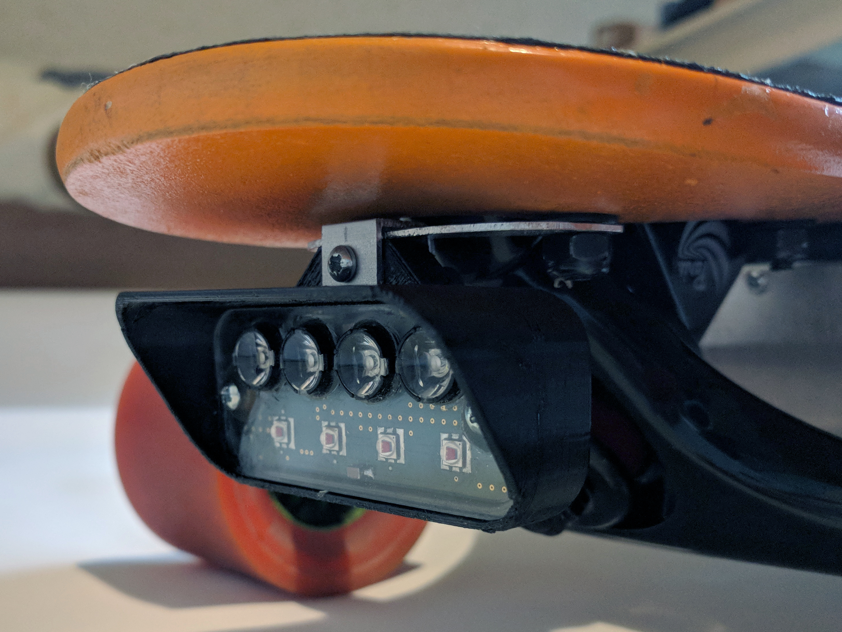

LedBoard: they are powered directly from the 48V of the battery (no need for a BEC), and can be controlled from the motorboard. This allows to switch the headlights on and off directly from the smartwatch.
Each PCB has both the white and red LEDs. The white LEDs have a reflector to reduce the field of view. The red light is stronger when braking, to emulate the behavior of the taillights of a car.
When the headlights are enabled, the color is chosen automatically so that the white light is always in the direction of the movement, and the red light in the opposite direction.

EncoderBoard: just a magnetic encoder and a differential transceiver to improve the reliability of the SPI communication.

Holy shit this is impressive. I’m curious how the board knows to stop sending power to the battery (when braking) and to send it to the resistor instead.

The current implementation is that the voltage (and then the current) applied to the power resistor is proportional to the excess current to the battery. For example, if you set the max battery regen current to 10.0 A and you actually are measuring 10.1 A, you multiply this error (10.1-10 = 0.1 A) by a gain (e.g. 20 V/A) and you obtain the voltage to apply to the resistor (in this case, 0.1 A * 20 V/A = 2 V).
I have to say I have not done the tuning of this gain yet, because I am not capable to brake hard AND at high speed at the same time. I think I would just loose balance. I really need to build a testrig to test that safely.
Of course, this closed-loop control only works if the gain is large enough. If it is too low, it won’t limit the regen current to the battery enough. If it is too high, however, it may become unstable.

Physically, the battery current and the power resistor current are measured with a Hall-effect sensor (I am using this one). When the current flows through, the sensor outputs a voltage proportional to the current, that can be read by an analog input of the microcontroller.
What “decides” where the current goes is a single half-bridge (it is kind of a double switch, you normally need 3 of these for driving a brushless motor) that is dedicated to that, and sets whether some current should flow into the resistor or not. Like a drain tap for water. Note that the current will then flow both to the battery and the resistor. Not sure if this is clear, it is difficult to explain.
