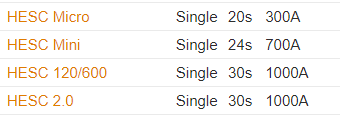

Added some really interesting VESC controllers coming out of 3 Shul Motors in India. They seem designed for electric motorcycles and the big ones support some crazy amps. They have a “micro” 20s 300A version that looks skateboard sized.
Some videos with glowing brakes and wheelies on their prototype page

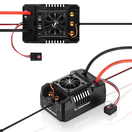

MakerX G300
Hobbywing Max 4
Of course, if someone tried one of those, share feedbacks
