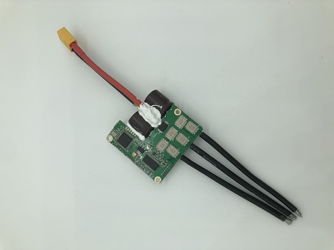

is this a vesc?
Nop. RC… but as there is a short short list of ESC at the bottom end… i tough that it might goes in…
An option beside Castle Mamba XLX2

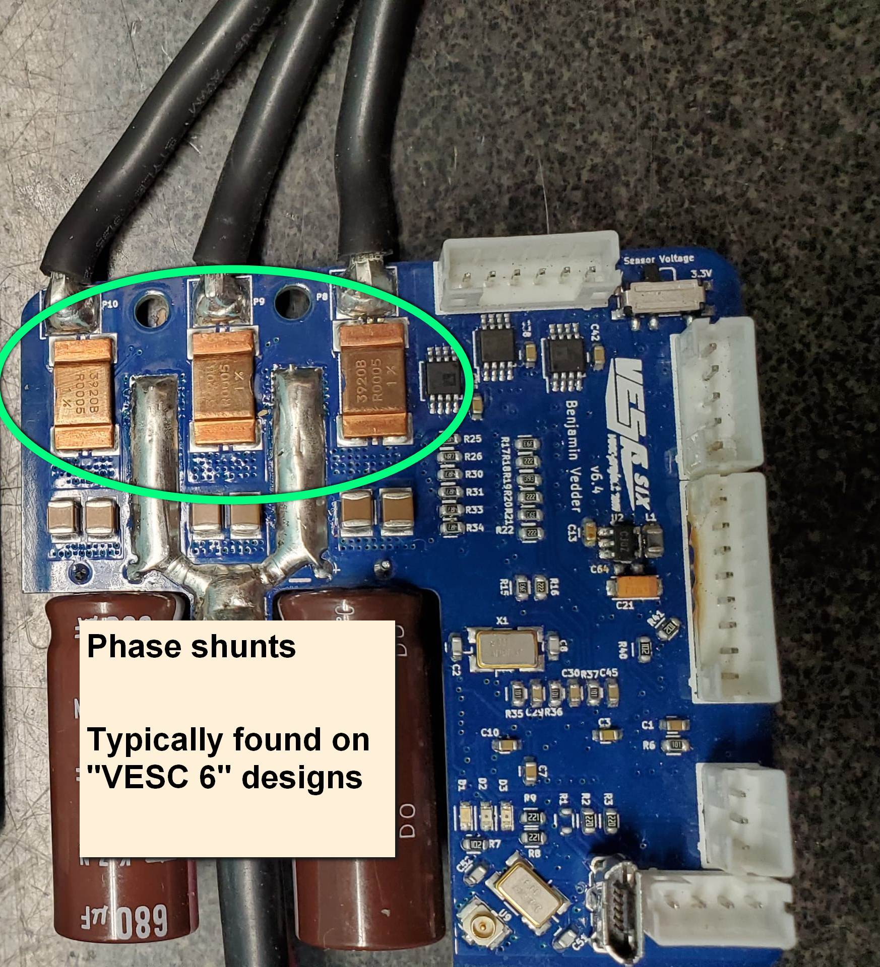

Phase shunts are placed electrically between the high and low side mosfets, and the phase wires. These are typically found on VESC 6 and 75/300 based designs.

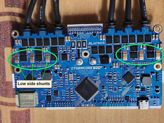

Low side shunts are placed between the low side of the mosfets the system ground. These are typically found on VESC 4, Unity, Stormcore, and 100/250 based designs.
Phase shunts provide a more accurate measuring of current flowing to the motor, but the design is limited by the available current sense amps on the market today. Generally these are used on designs under 70-80v.
Low side shunts can work on much higher voltage, but are less accurate in measuring current.

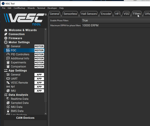

On the firmware tab of the VESC tool you can see if phase filters are enabled or not at the firmware level.
If they are disabled in the firmware, then the “Enable Phase Filters” setting does nothing.
The issue is that some hardware designs don’t include hardware phase filters, but they are running stock firmware (75_300_R2 or 100_250 for example) which has them enabled. This causes the motor detection results to be incorrect and the motor won’t spin properly.
Usually if the Hw: name (75_100_V2 in the screenshot above) on the firmware tab is named after the controller then it’s a good bet that it’s configured correctly for that hardware.

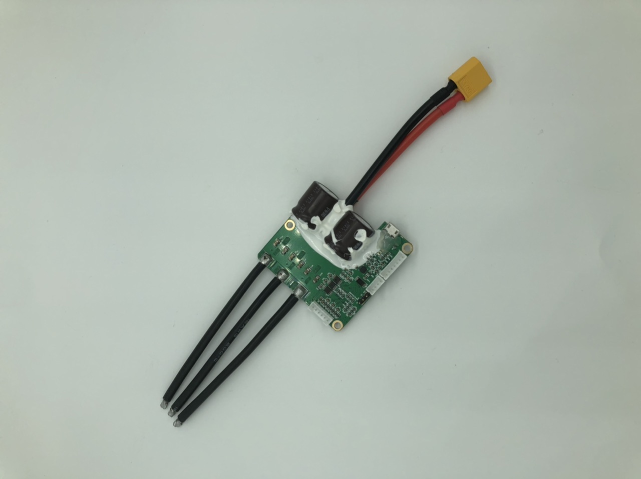

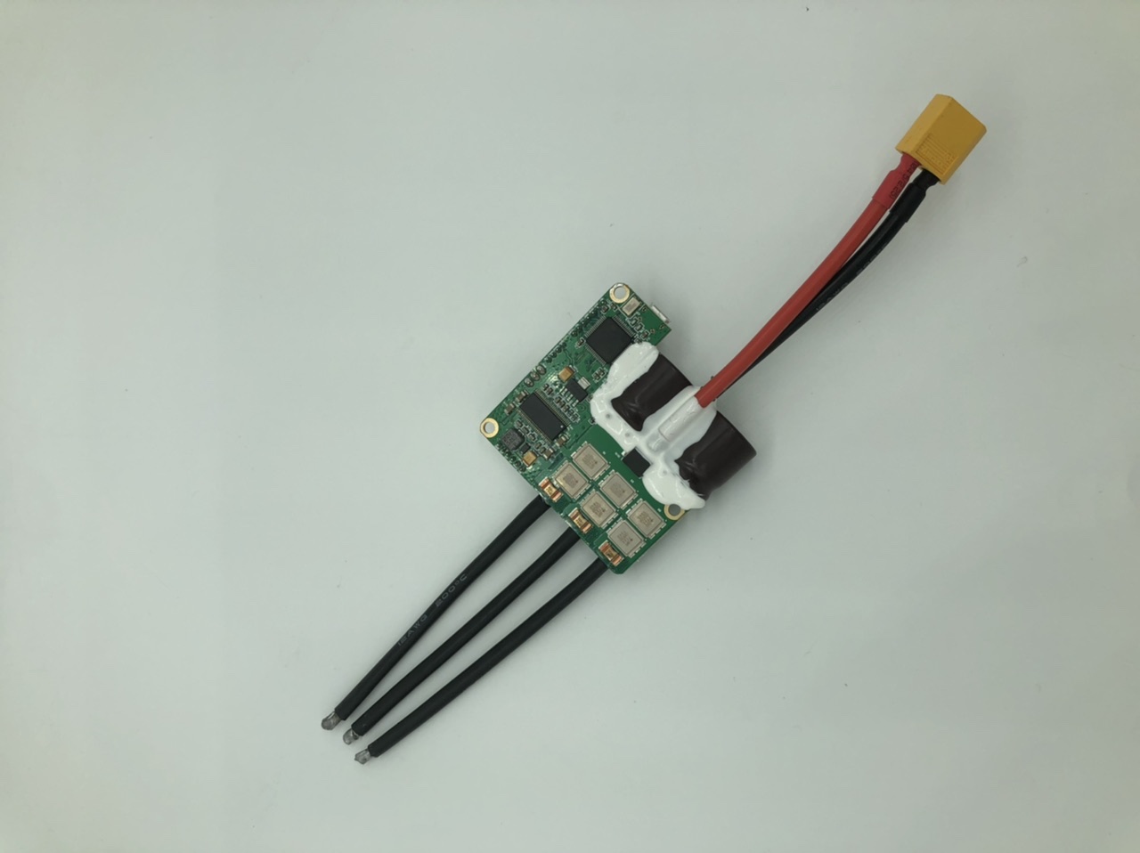

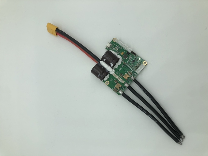

It was a focbox but a 3 shunt design
It looks like there may have been two versions of it. You can match the PCB up to these pics to find out which one you have.
Nice! Looks like i got the v6!

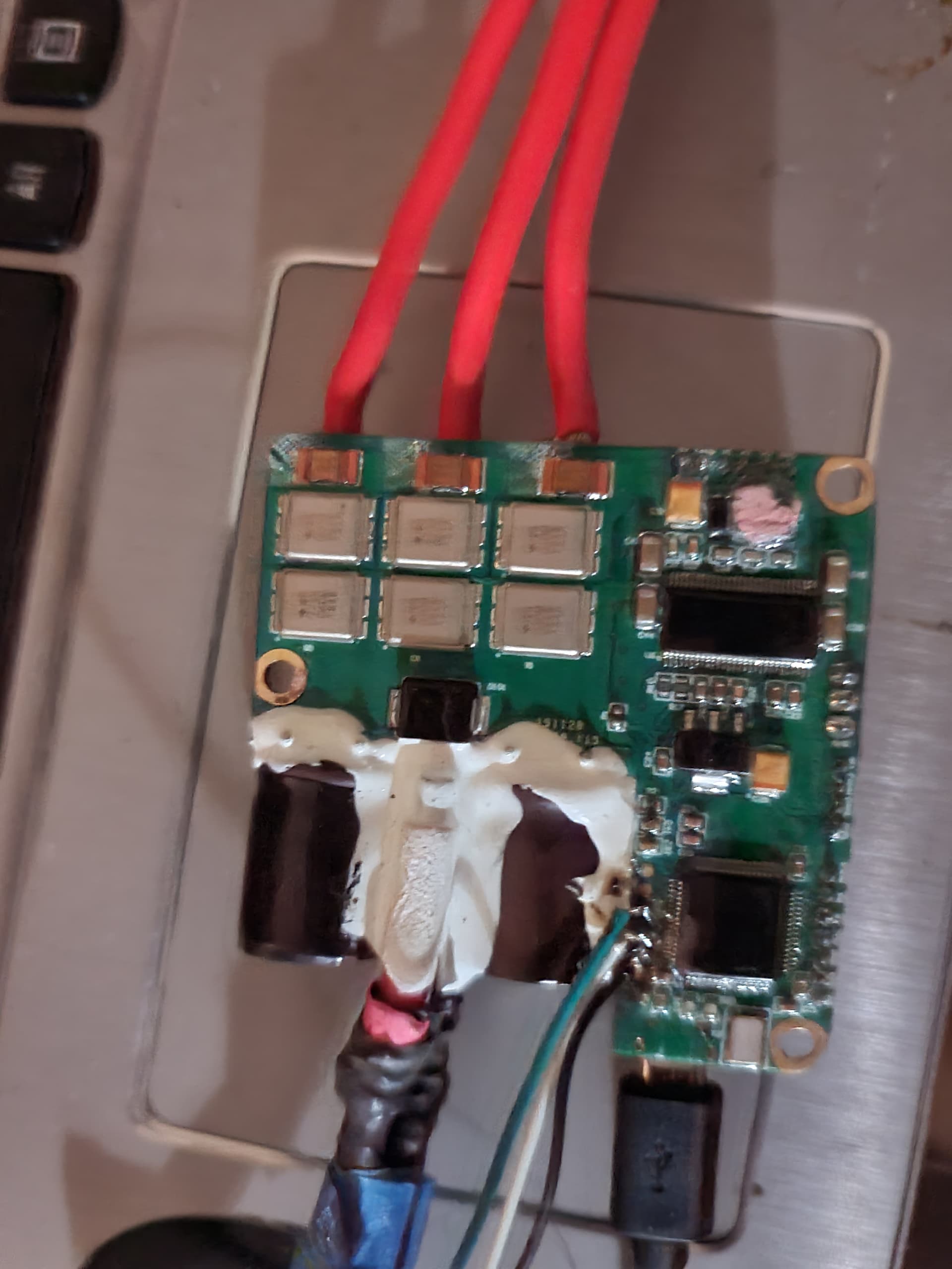

Is there any way to tell what filters/shunts it has?
