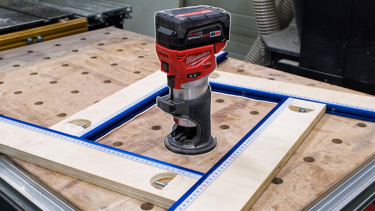

If you don’t have access to a CNC or a laser cutter, you could use 4 straight edges and a router to cut it out.
Lots of adjustable builds on YouTube, though you could make something much simpler for a one time use.
Here it is in action:
I actually have a routing kit for my Dremel that I was going to use for routing wires through a deck a while back. It would probably be perfect for this.

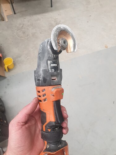

Just a thought: routing or grinding is gonna make a lot of nasty airborne dust. Routing will likely dull your tool quite a lot as well.
I use a vibrating tool with a diamond blade on it for cutting fibreglass. Minimises airborne dust but is noisy and quite slow. It is my favourite way to cut glass tho.

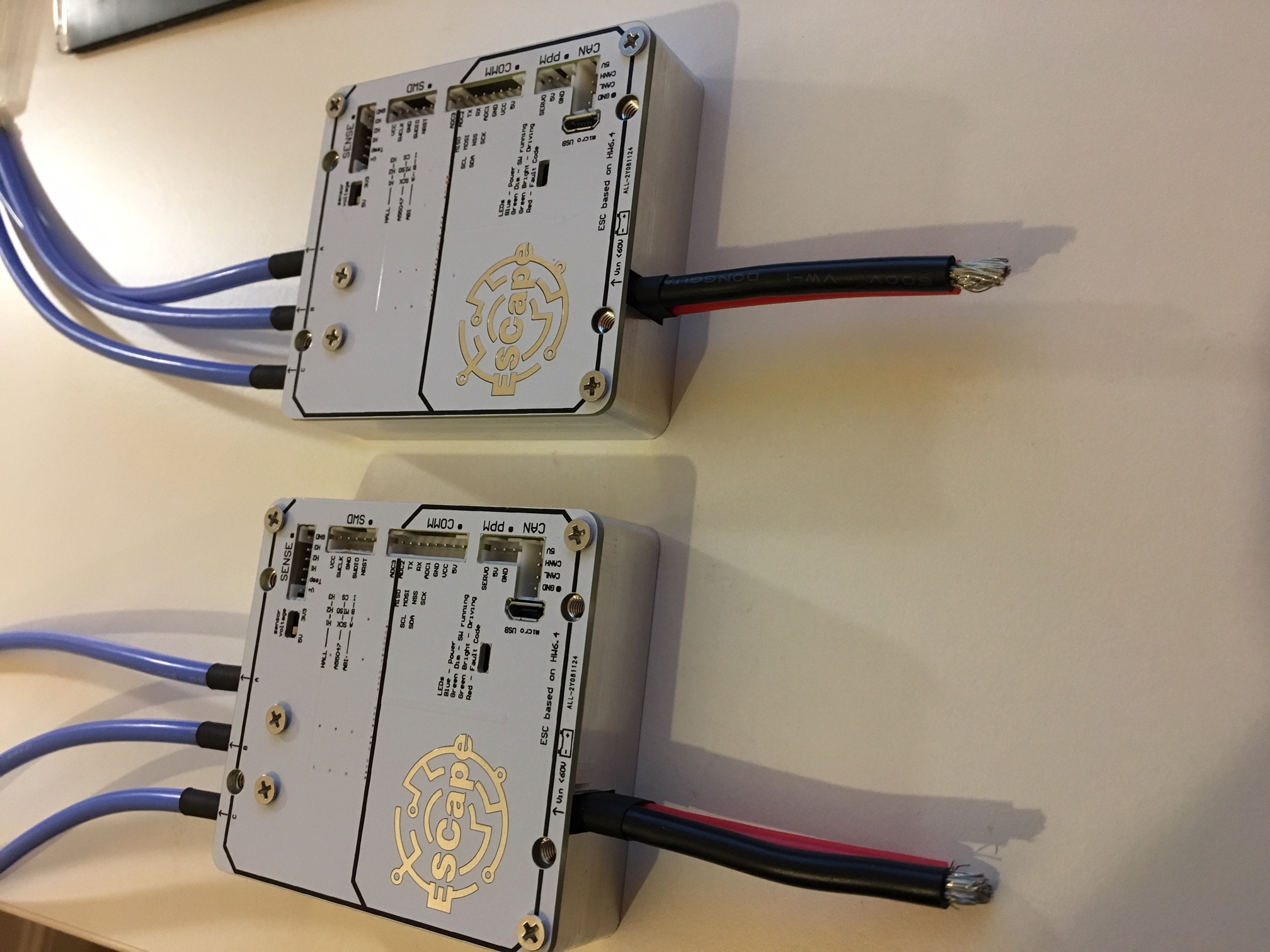

Anyone know the specs of the ESCape?
