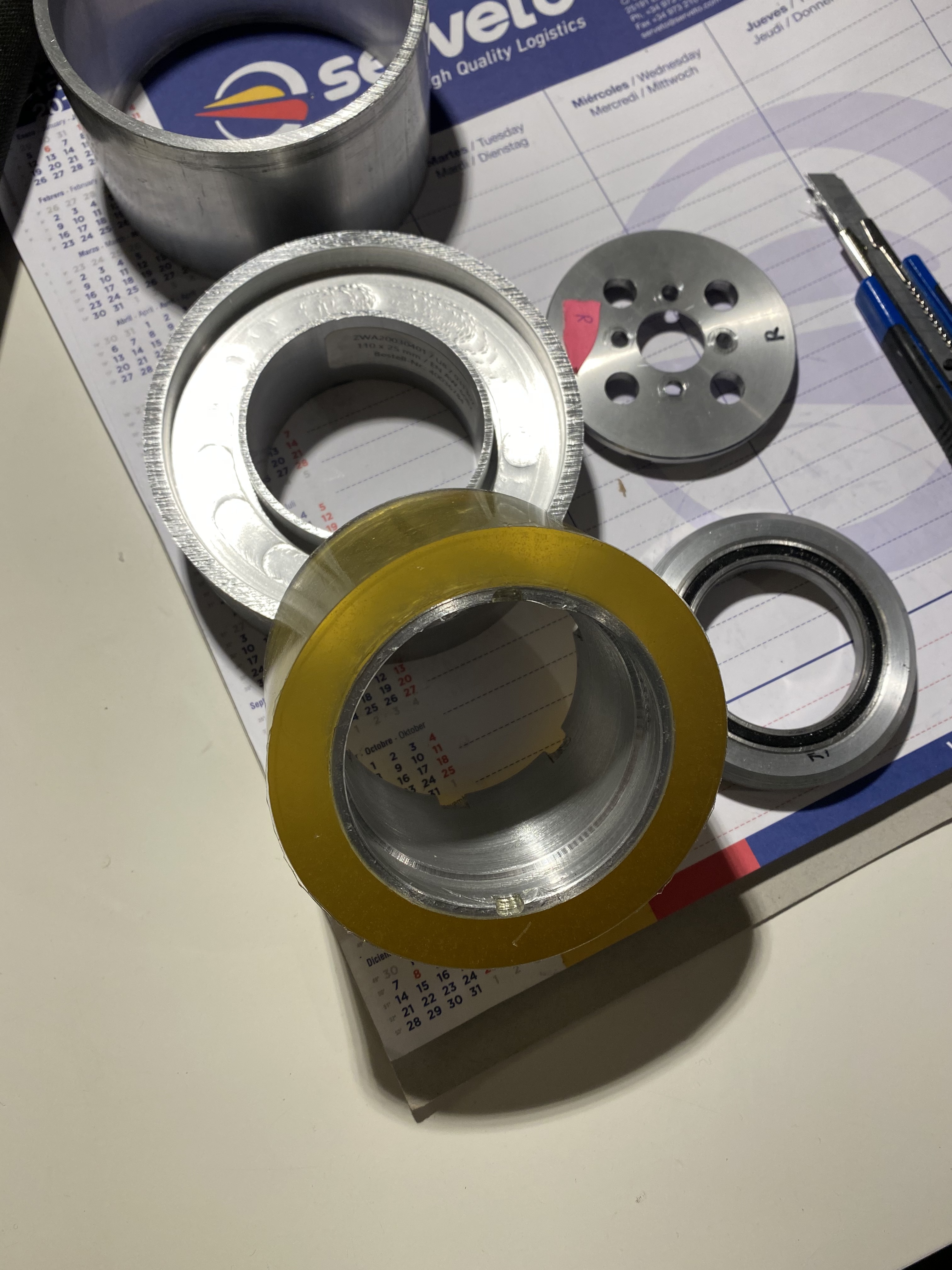

Why not just bying some? Well, I did, but they didn’t quite fit to my DIY Hubmotor (too tight), so I had to DIY again :smiley:
For the outer ring of the mould I used an ordinary aluminium pipe and machined a simple ring groove into another aluminium part for centering the outer ring and the inner one (being the core of my sleeve).
Basically I used visnu777’s manual and same PU.
  1. Application of release agent on mould (Spray, distribute with brush, spray again, wait for 30 mins):
  2. Assembly of mould, stiring of both PU components for 3 mins, casting slowly to prevent air bubbles)
  3. Curing for 2 days, easy removing from mould:
  4. Some tempering at 65° in order to further improve physical properties
  5. Magic amber sleeve is done :sweat_smile:
@visnu777: Thanks a lot! Without your post here I wouldn’t have even thought about casting wheels or sleeves at home at all! :slight_smile:

I didn’t try yet, because the second sleeve is still curing. But with 10mm PU I expect it to be as hard as the sleeves of maytech and Co :laughing:
This time I tried to pour it even slowlier than the first time, to prevent those bubbles. But they aren’t as bad in reality as they seem on the picture. The lamp amplifies them a lot :smile:
I was too stingy to spend another 20€ for the black pigments. I guess, if the sleeve was coloured you wouldn’t notice those bubbles at all

I totally agree. One of my sleeves came of the aluminium at 40km/h. Luckily it only loosened a bit and didn’t fly of completely. Now I glued it with special PU glue to the aluminium. Test coming up this weekend :wink:
In every case I would really recommend to machine deep grooves or holes to interlock PU and aluminium in addition to grinding the surface for good adhesion.

After some testing with heavy strain for the wheels (speed, burnouts, carving) both sleeves loosened from the aluminium.
The glued one went of almost completely…
…while the other one just detached in a few spots (dark areas):
So I added thousands of flat holes and grinded the aluminium with very rough sand paper to achieve better adhesion and form closure.
I hope this will do :crossed_fingers:

I am quite sure that the formula is fine. I used very sensitive scales. On the second wheel, where the PU only came of in a few spots, it was very difficult to peel it off completely.
I blame the oxid layer of the aluminium. It seems that I didn’t sand it properly enough everywhere…
Aluminum likes to make oxide with air almost instantly, based on other pictures you sent, that could be the cause. Make sure you check if there is no contamination present from something simple as mixing stick. At current state I would start doing small scale tests before trying to case new sleeves.
So, I finished the second sleeve last weekend (the amber color didn’t fit the whole board design. Thus I bought some black pigments after all)
The weather allowed 10km testing with up to 45km/h and 80 degrees Celsius motor temperature. So far no signs of defects :hugs:
