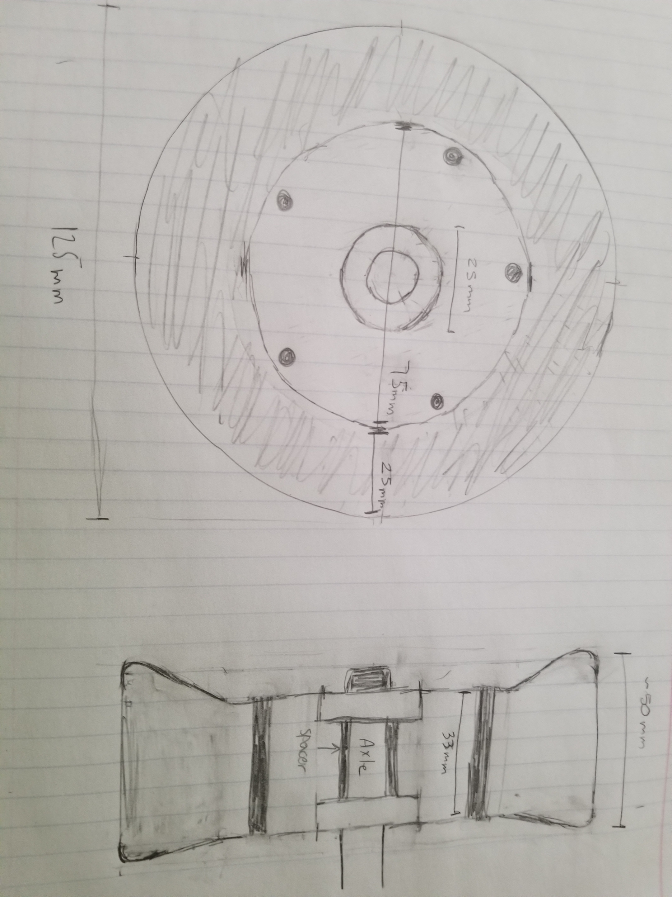

Would like to DIY some good looking gummie clones, can anyone help me out and design a mold for them?
Here is my project. Hope you guys like it.
Going to try to make this into a gummie clone
Anyone able to help me turn this into a 3d printed mold or a 3d file?
Design will need a bit of refining, black circles/tunnels meant to be a copy of where superstar hubs screws are meant to go. I am not sure if the screws by themselves mounted through the urethane will be okay (for the drive systems) or a hub that allows more urethane than regular hubs will be needed.
You can PM me with some more information, might have time to model something this weekend and I can also print the model if you want.
