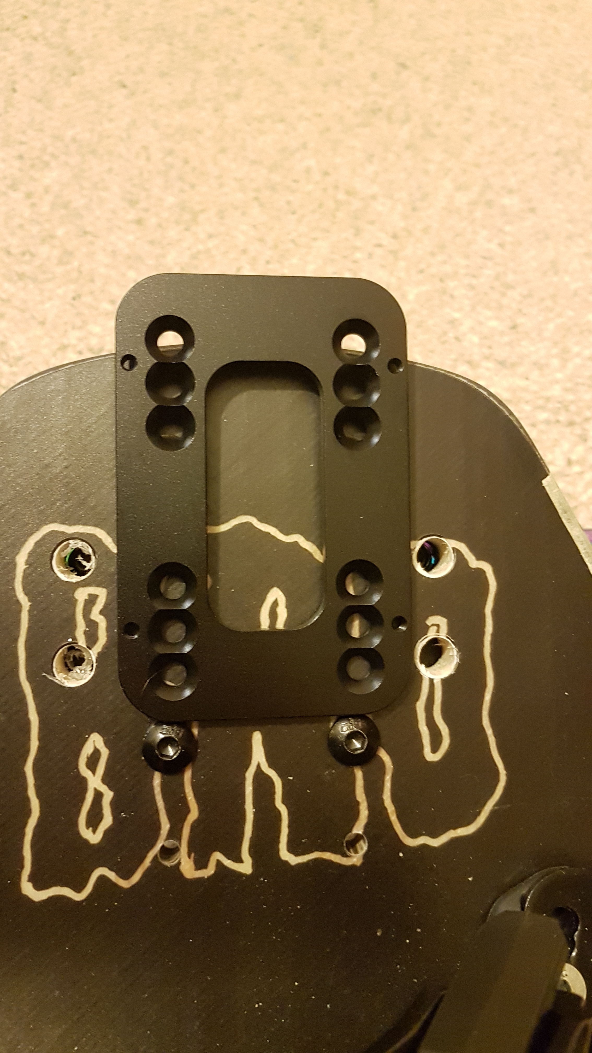

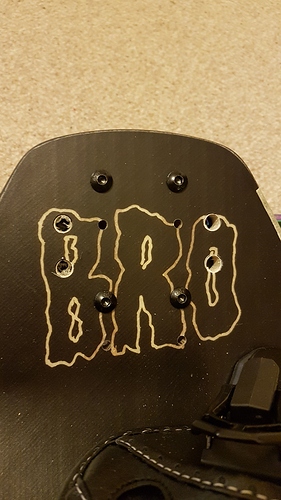

Fuck. No cable tunnel kills my Davega.:sob:
This is the supposed place of my davega.

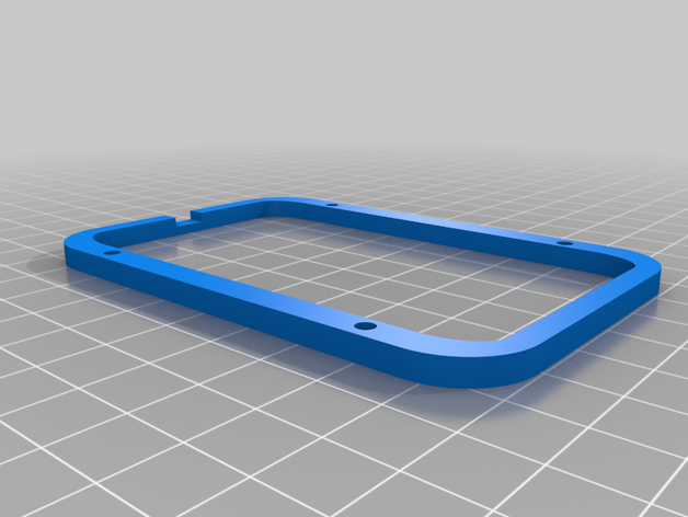

Print the spacer I made and route the cable underneath the board.
Thank you so much. I slice it tomorrow and print it with PLA.
No problem! I had that same problem and that’s what I ended up doing :slight_smile:
You will need longer screws however.

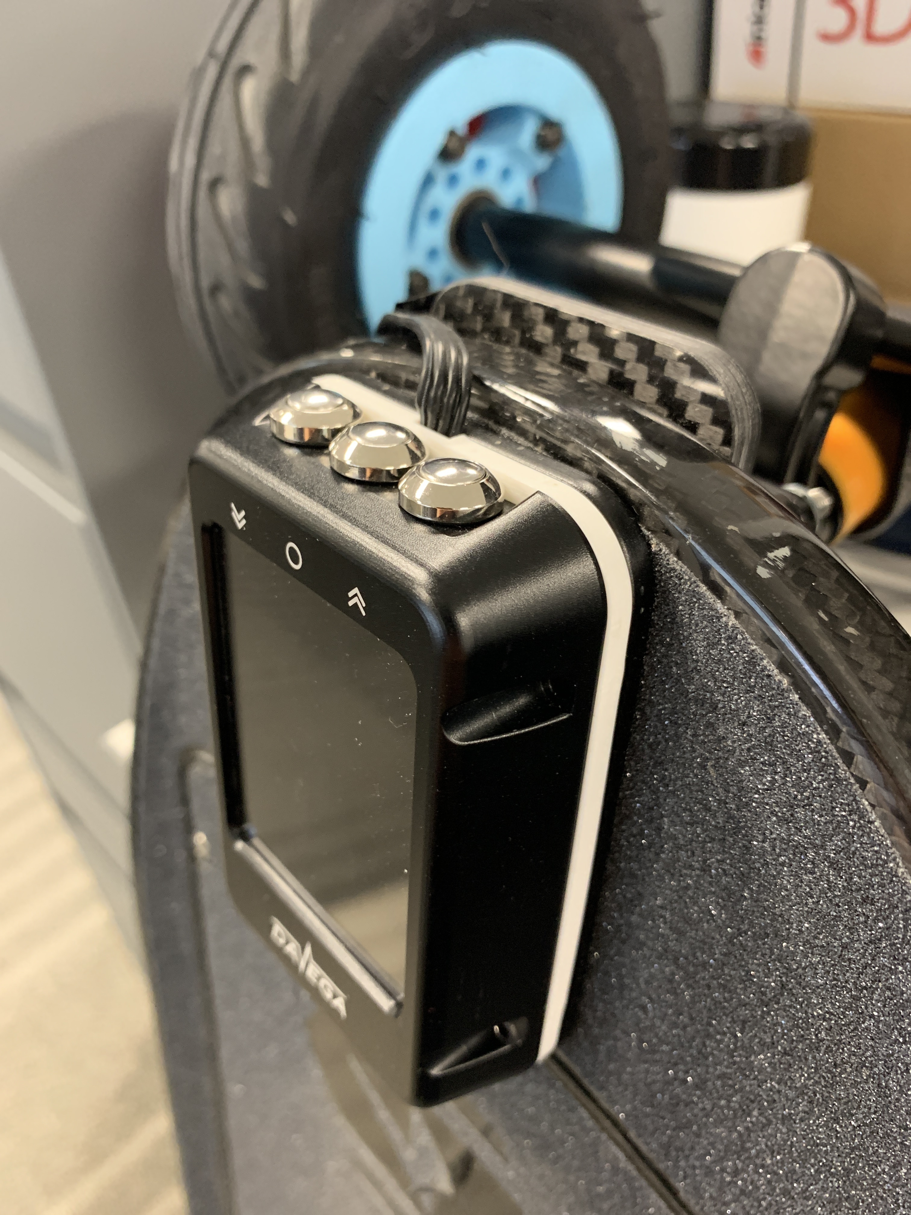

I have mine routed forward but if you have a top box style, you should be able to just reverse it and it should work.
I also created another one but with flashlight mounts on the side. You’ll probably have to modify it slightly to fit your specific flashlight.
