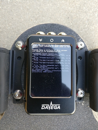

Separate issue:
Here is one of the pic of my buddy’s DavegaX.
I have also noticed that changing battery capacity from like 90% to 100%, it freezes. Same results w changing the mAh. This is on version 1.3. I thought somehow when we downloaded the update, it got corrupted. I deleted v1.3 after we got back from our ride, redownloaded it and same results. Power cycled in between.
Factory reset and reset settings didn’t help. I’ll post more findings when I get a chance.

I know of memory problems and I’m working on it. In fact, I already have a bootloader 2.0 implemented where the problems have been addressed. I want to do more testing on it before I make it public but if you (or your buddy) didn’t mind being a guinea pig for it please let me know. (You can always easily downgrade without loosing the data if something is not working as expected.)
BTW, did that memory error happen while riding? I haven’t seen that happen while riding. Only when doing things in menu.
Freezing or does it throw an error? If the latter, please send the error details. I have had this reported before. I thought I have fixed it. Maybe not.
Nah, that shouldn’t happen. It’s more like the 1.3.0 is more demanding on memory so the memory errors are more likely to happen than in the previous versions.

Yes, it happened a few times while riding. In fact, we got annoyed power cycling it every single time so we just left it like that until we were done w our ride.
It gave me an error of “I apologize for the inconvenience. Take pic and send.” Somewhere along those lines.

Right, makes sense. If you can reproduce the problem, would you please send me the pic. Thanks!
