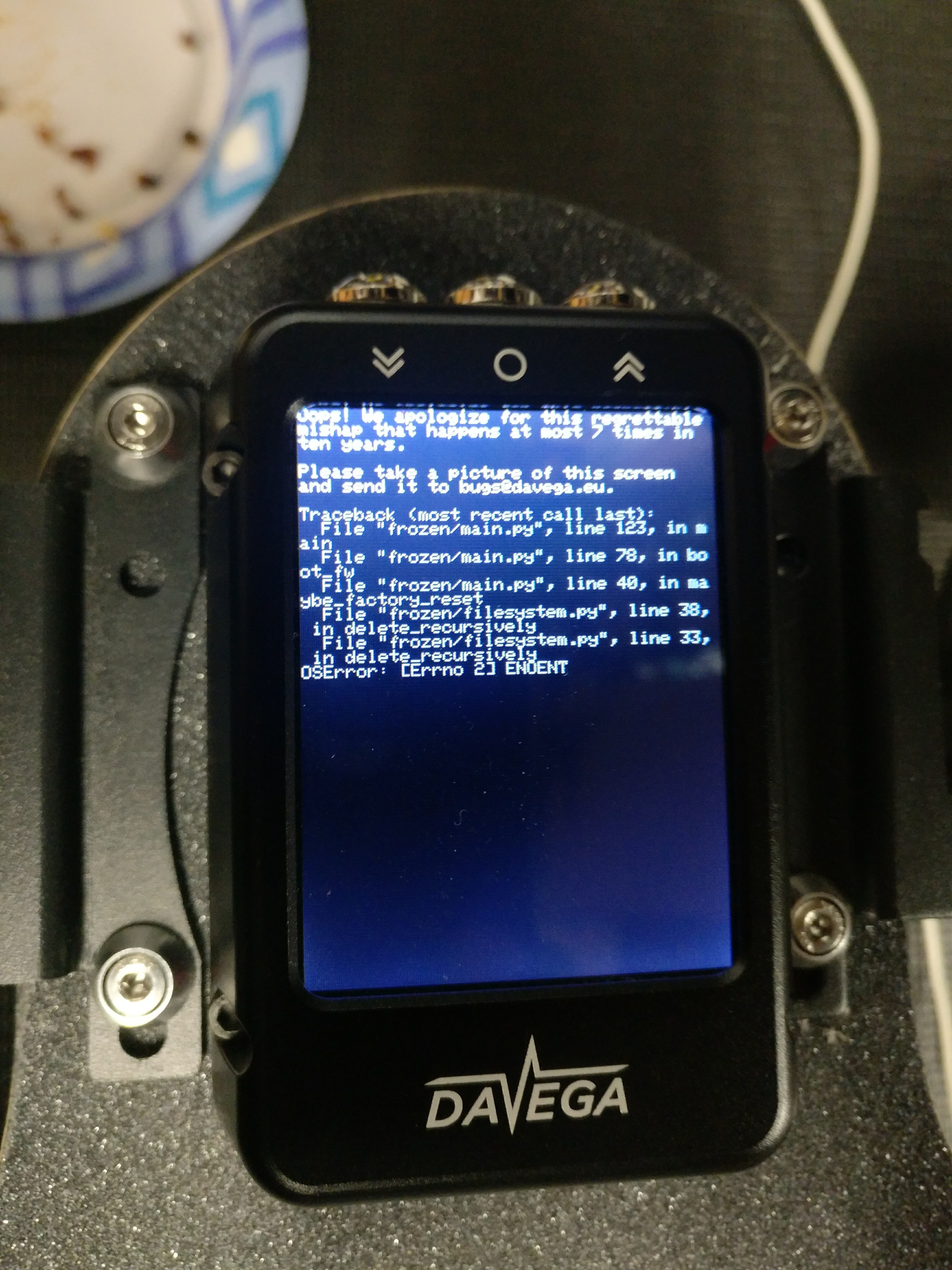

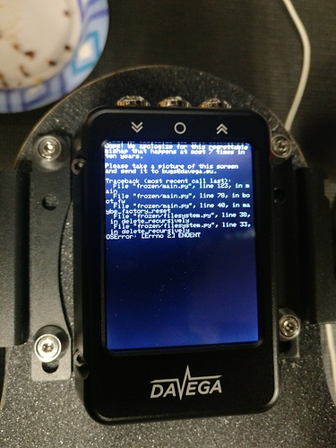

Errors I got from trying to update my buddy’s unit. Factory reset and “middle button” method didn’t work.

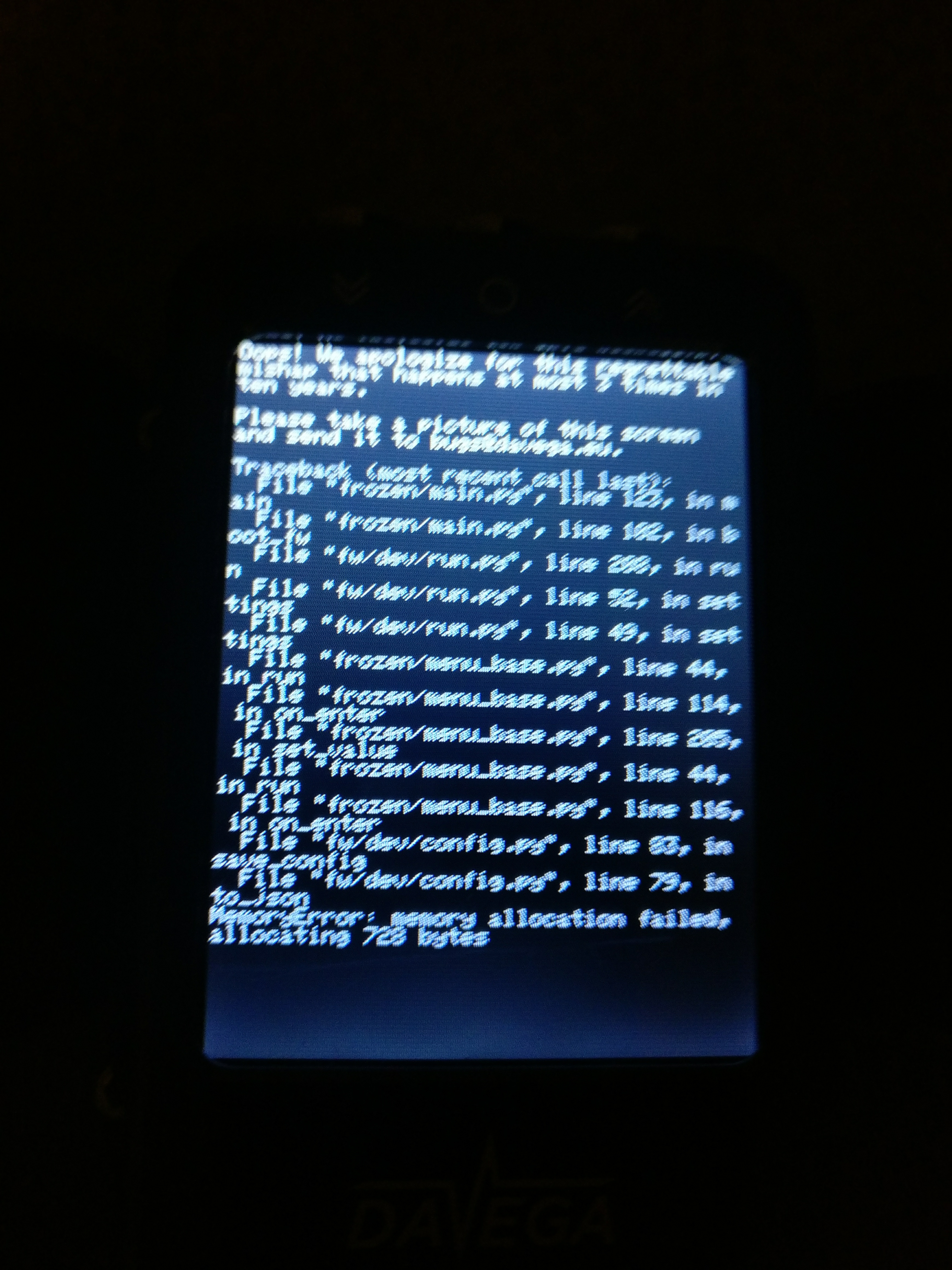

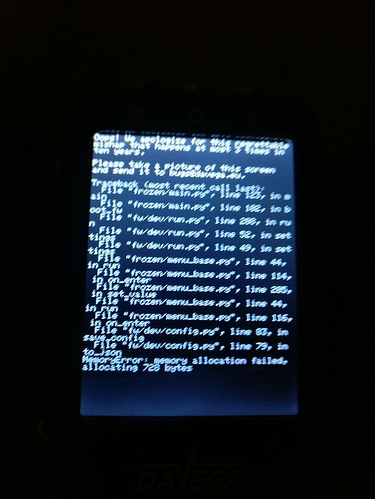

Here is 1.3.1 when I tried to set my battery capacity (my unit):
Sorry for shitty pics. I was tired.
That’s bad. It may be a bad unit. Let’s do a complete reinstall first. I’ll PM you the instructions. If he keeps having trouble with it after the reinstall, I’ll replace it.
Thanks for the report. That’s a memory error. Not really a bug. Just poor memory management. I have significantly improved it already. I’m preparing FW v2.0.0, which should no longer throw any memory errors. It will also have DieBieMS support (and hopefully FlexiBMS support as well once the CAN communication is implemented for it). I’m almost there. Just need to spend a few more hours on it to address some minor issues. Sorry about the trouble.

Update:
Everything is working well so far ever since I wiped and reinstalled everything from scratch on my buddy’s unit. Thanks for the help @janpom

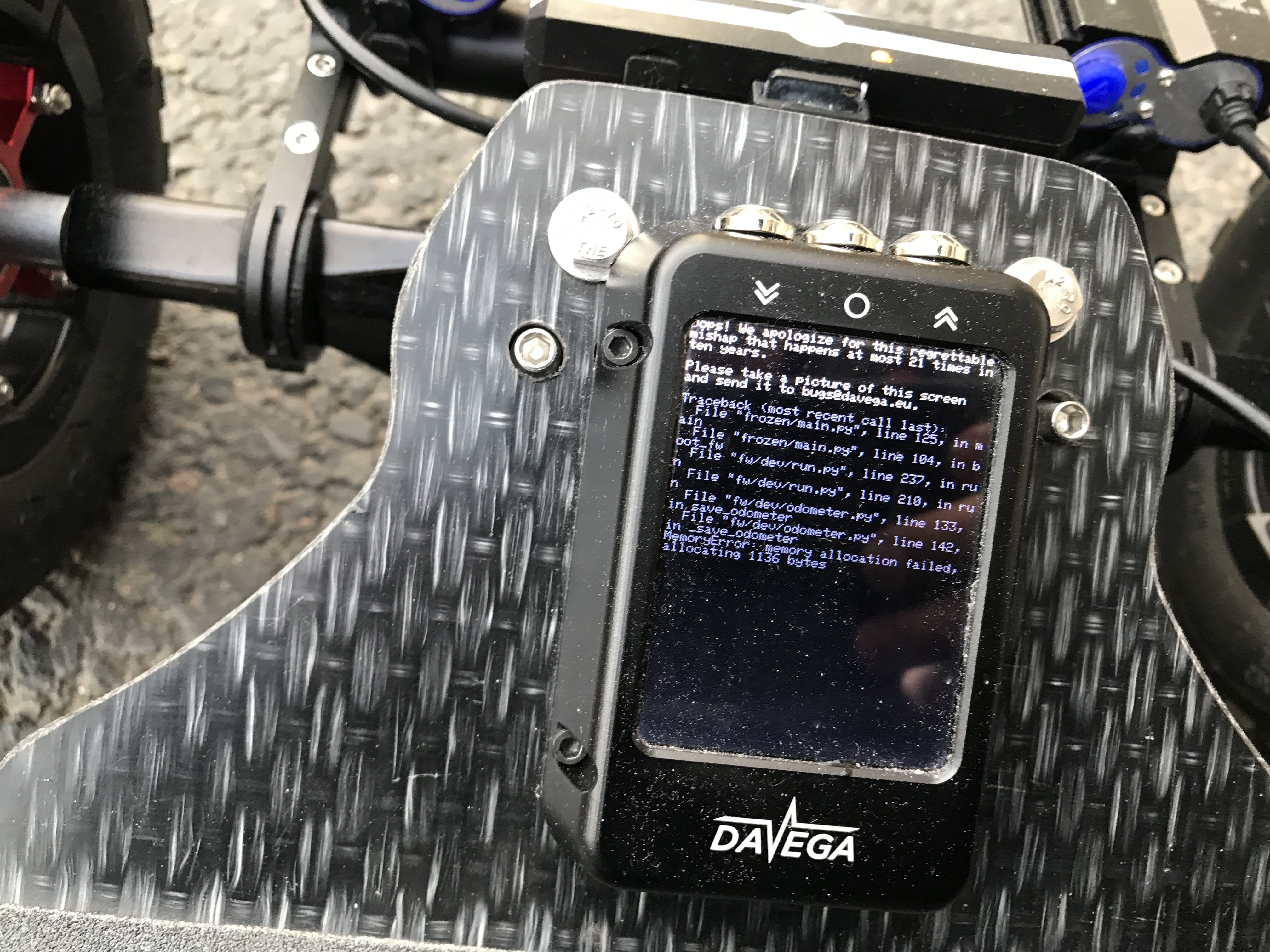

Unfortunately ran into this problem today:
With version 2.0.1
Hi, was that when riding?
Yeah, it was while riding.
I don’t know why (maybe it’s my esc).
But while riding, the davega screen turned into a black menu screen. I kept riding, the device rebooted itself a few times and then showed this error.
After updating my focboxes to 3.65, I haven’t had any problems yet, until today where I had my davega constantly going to a black menu screen.
It maybe shows a loss of uart connection.

That sounds more like hardware problem to me. Please double-check the connectors are properly plugged-in both DAVEGA side and VESC side and there’s no loose wire (occasionally a wire may come out of the JST housing). If you’re running dual FOCBOXes you could also try plugging DAVEGA into the other one. Removing the usplit temporarily is also worth a shot. I hope any of that helps. If the problems persist, you can send the unit back and I’ll either fix it or send you a replacement piece (provisioned with the same data).
I would say it’s probably a hardware problem from my esc, not from the davega.
Thanks for the help.
Seems like I had this same issue before on 3.62, tried to update to 3.65 didn’t see any issue for a few km but I had all the bugs today.
