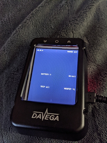

First real issue I haven’t been able to solve or figure out. I’ve reflashed firmware, tried rebooting, reverting to prior firmware doesn’t work, ect… Haven’t used my board in a few days and it was working perfectly before. But now it just gets stuck at this screen. Any idea what I should try?
Yeah, this has unfortunately been reported a few times. I don’t know why it happens. Must be a micropython bug.
The solution is to use the davega tool and make a full backup. Then erase flash, reinstall the bootloader and restore the backup. I hope that helps. Sorry about this. Hopefully it doesn’t happen too often.

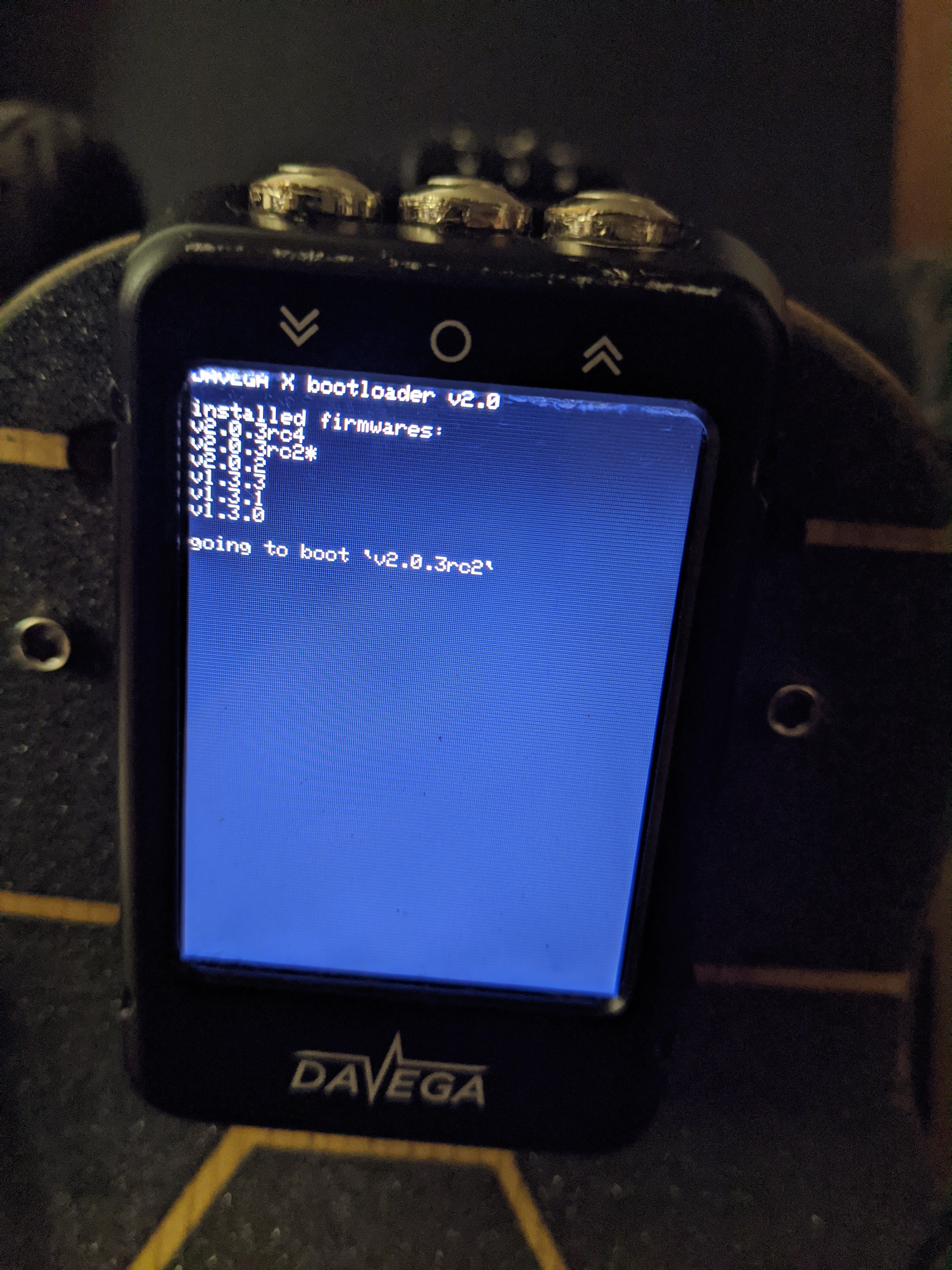

Got this yesterday while riding, DAVEga X is running through uSplit. Constantly repeating.
That looks as a bad contact on the MOSI pin of the display. DAVEGA thinks the display has restarted and it re-initializes it. This is fixable in software. I can add a preference for disabling the display re-initialization. Will try to do it later on today and will send you the update to test out.
You are still able to access the menu, right?
Yeah it worked fine again after a restart, no hurries.
Oh, so it was just a one-off? I thought you were getting it all the time. If it just happened once, probably the display somehow got into a weird state and didn’t communicate back over SPI as expected. Please let me know if it happens again.
Yeah it happened just once. I will report back if it does it again.
