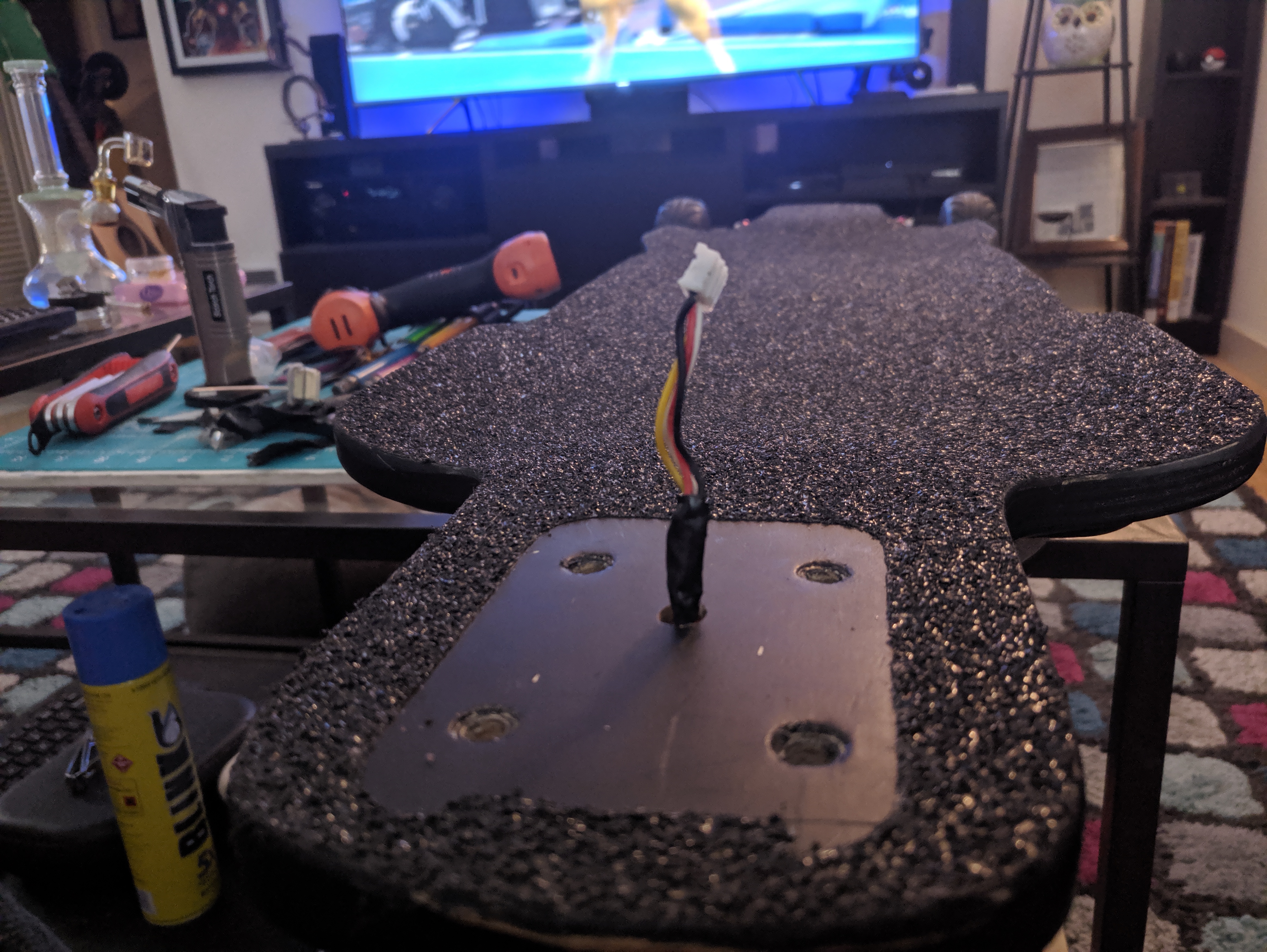

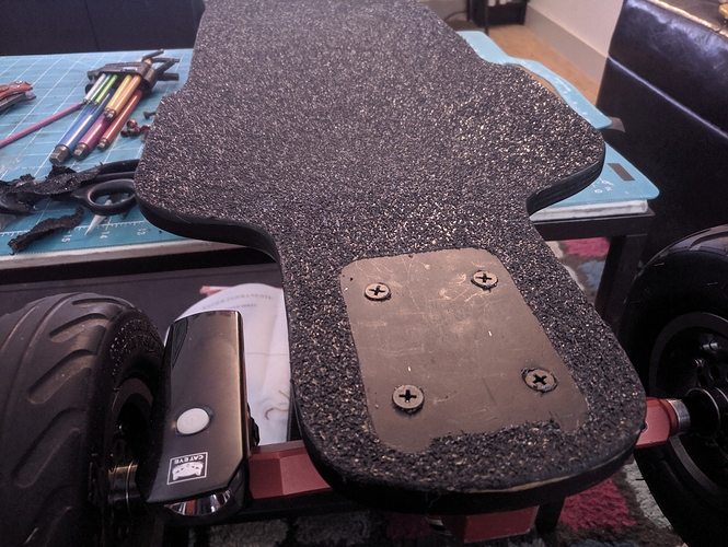

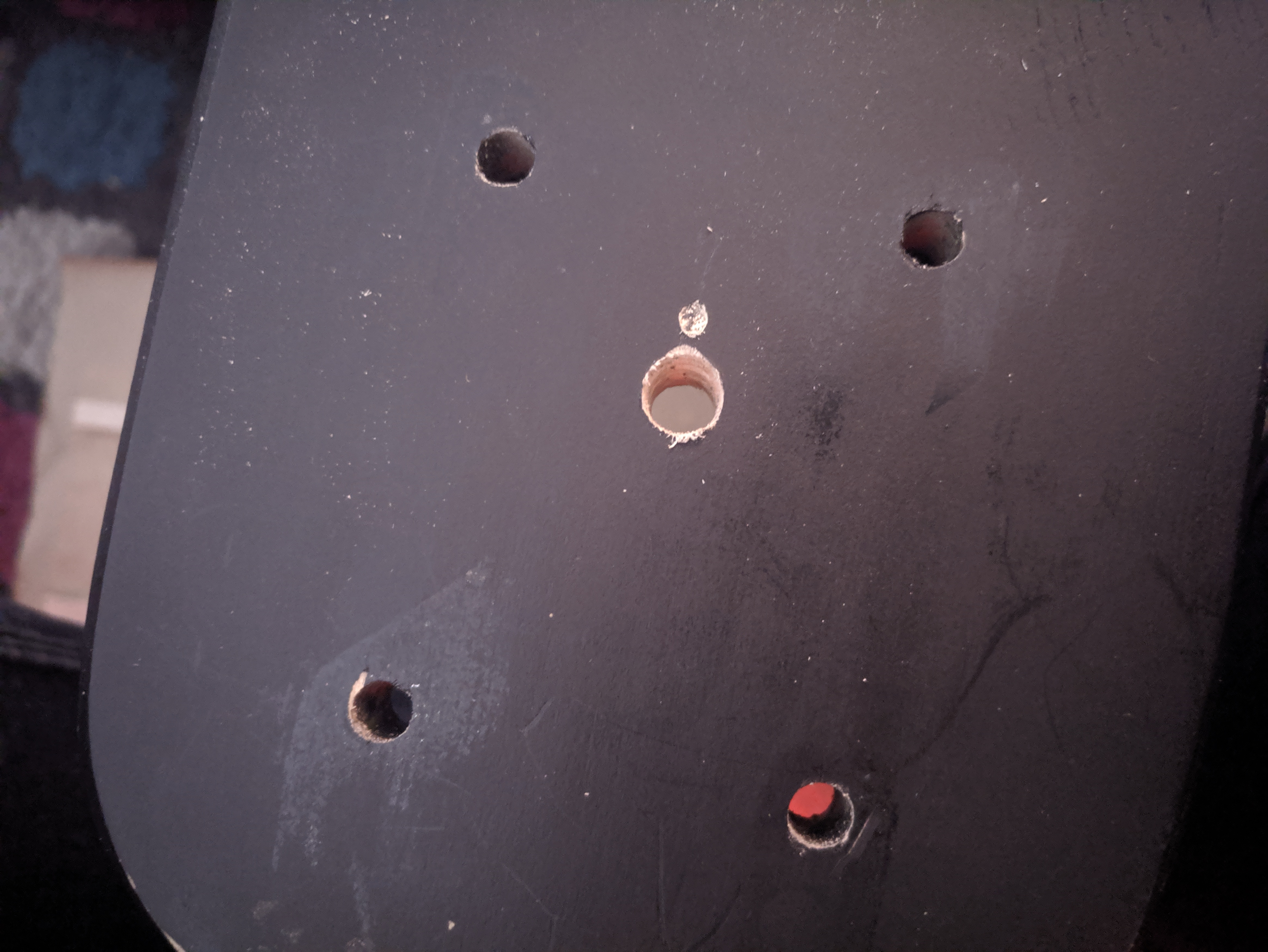

Yea but the base plate is countersunk
If you dont want to drill through you could always use some strong double sided tape like this one:

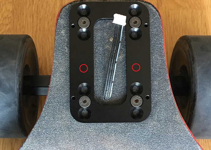

I am seeking for the option to drill two holes here
so it would match my bottom screws without interfering with the top ones.
But then the issue, and I am wondering would not countersink screws work with this device as it does have a bit of space between the plate and the PCB.
But then the head of my screws might be too big for it :/…
Wes drilling would work, if you get some countersunk screws it should be fine. I used 4 countersunk screws now.

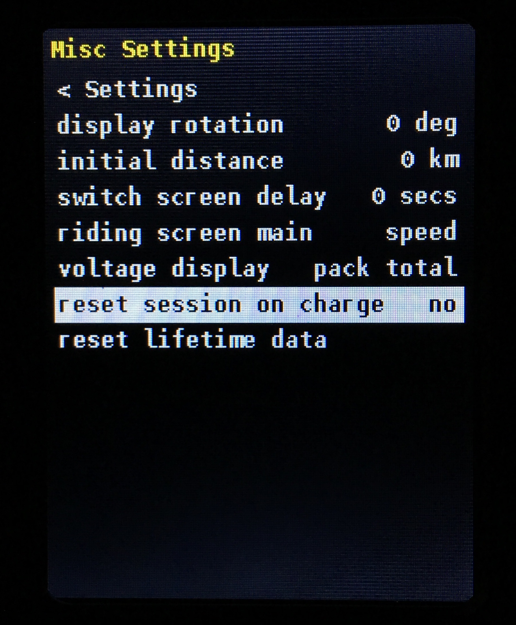

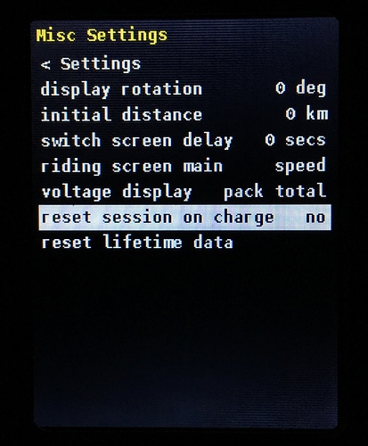

It’s not too exciting. I added a preference for “reset session on charge”. It’s in the Misc settings. Someone wanted it. I can’t find the post now.

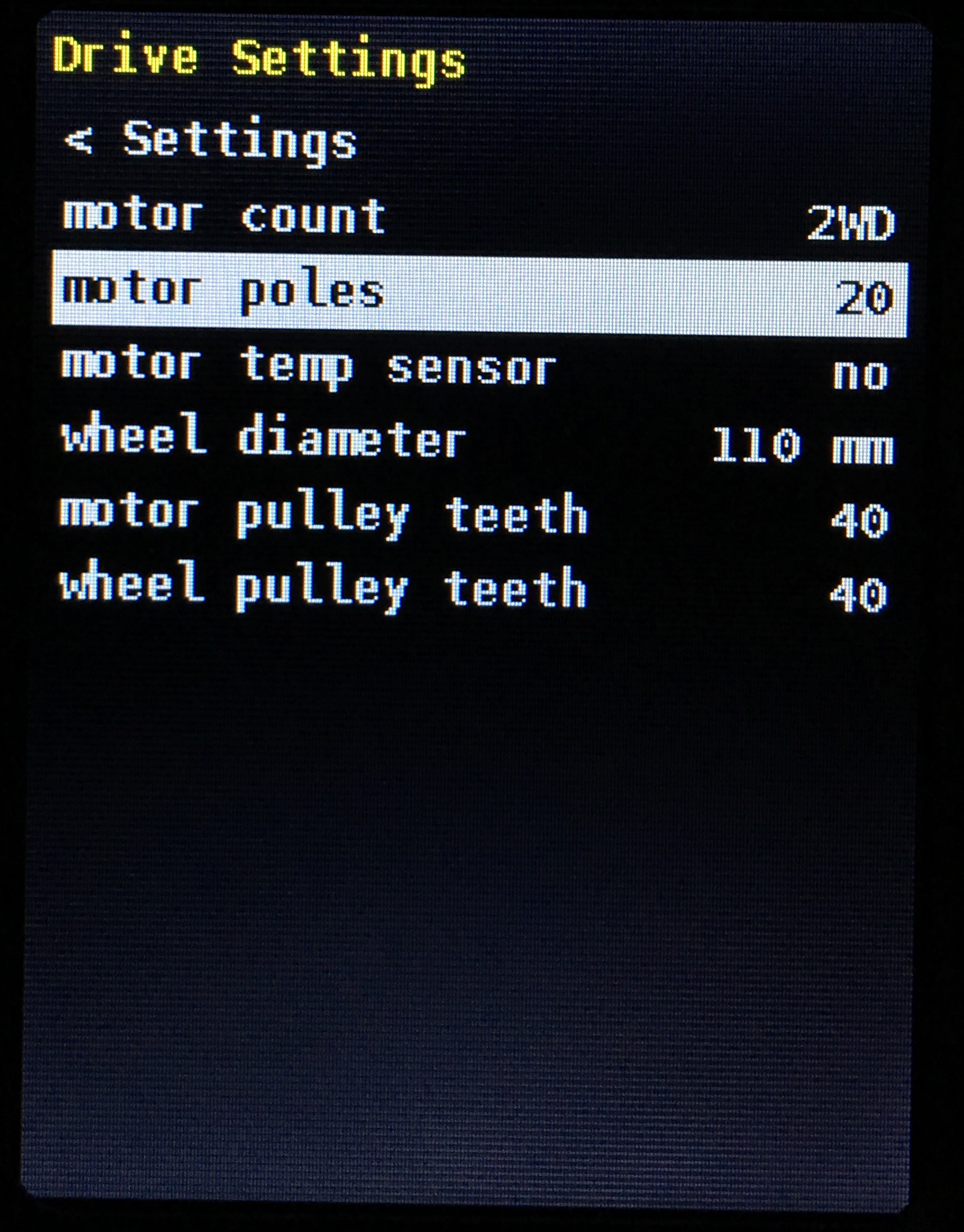

I also changed the “motor pole pairs” setting to “motor poles” since people kept putting the number of poles. :slight_smile: Now putting the number of poles is the correct thing to do. Only even numbers can be entered. Your settings automatically change when you upgrade.

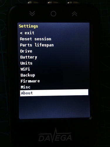

There’s a new “About” screen that will tell you your current bootloader and FW version as well as your VESC FW version.
