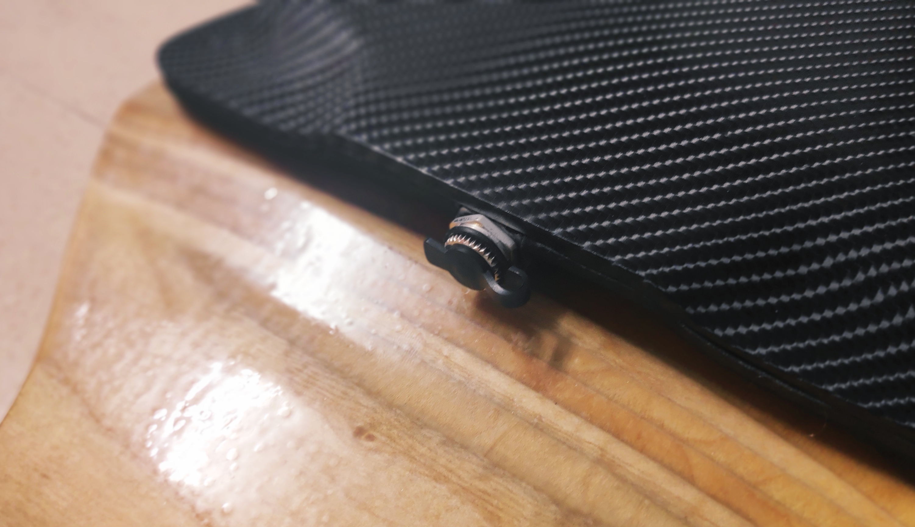

@rey8801 @Lobap Do you mind sharing the pictures of the details of where you placed the charge port, loop key and on-off switch?
I still having doubts on this
Thanks!
Mine you can see it in the Thanos’ thread. I CAD it and milled out of aluminium for the charge port and unity switch.
Thanks, I’m going to reread that entire thread
You don’t need it. For the charge port there is not that much more to see. It’s really simple. There is a bit of routing to do it but I like the final effect
And dont you have problems with water or dust having the power button on top of the deck?
I really like how It looks in your board.
Ah I don’t ride in the rain anyway. But both the charger and switched are fully sealed underneath. The top of the switch is the classic one. Even if you have it below the deck will take water anyway in case of rain.
Thanks @rey8801 I would probably do the same
Cool! I hope it works out
I did that:
I did not want to ruin @rey8801 nor @BigBen pieces of art with some creepy holes :slight_smile: :slight_smile:

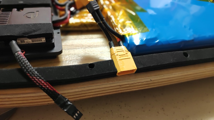

Anyhow all the decks for EU folks are hipped and the US are on their way @Sender with the enclosures from @BigBen. Great collab for sure :blush:
I tried a 36" Evo a while back on a sweet build, and realized I need a minimum amount of real estate to feel planted.
Not much… the neoprene compresses when I tight the enclosure bolts but I needed some space to fit the focbox dual heatsink…
True but you should get the thickness of the xt90 at least. Those mm are gold in some occasions.
