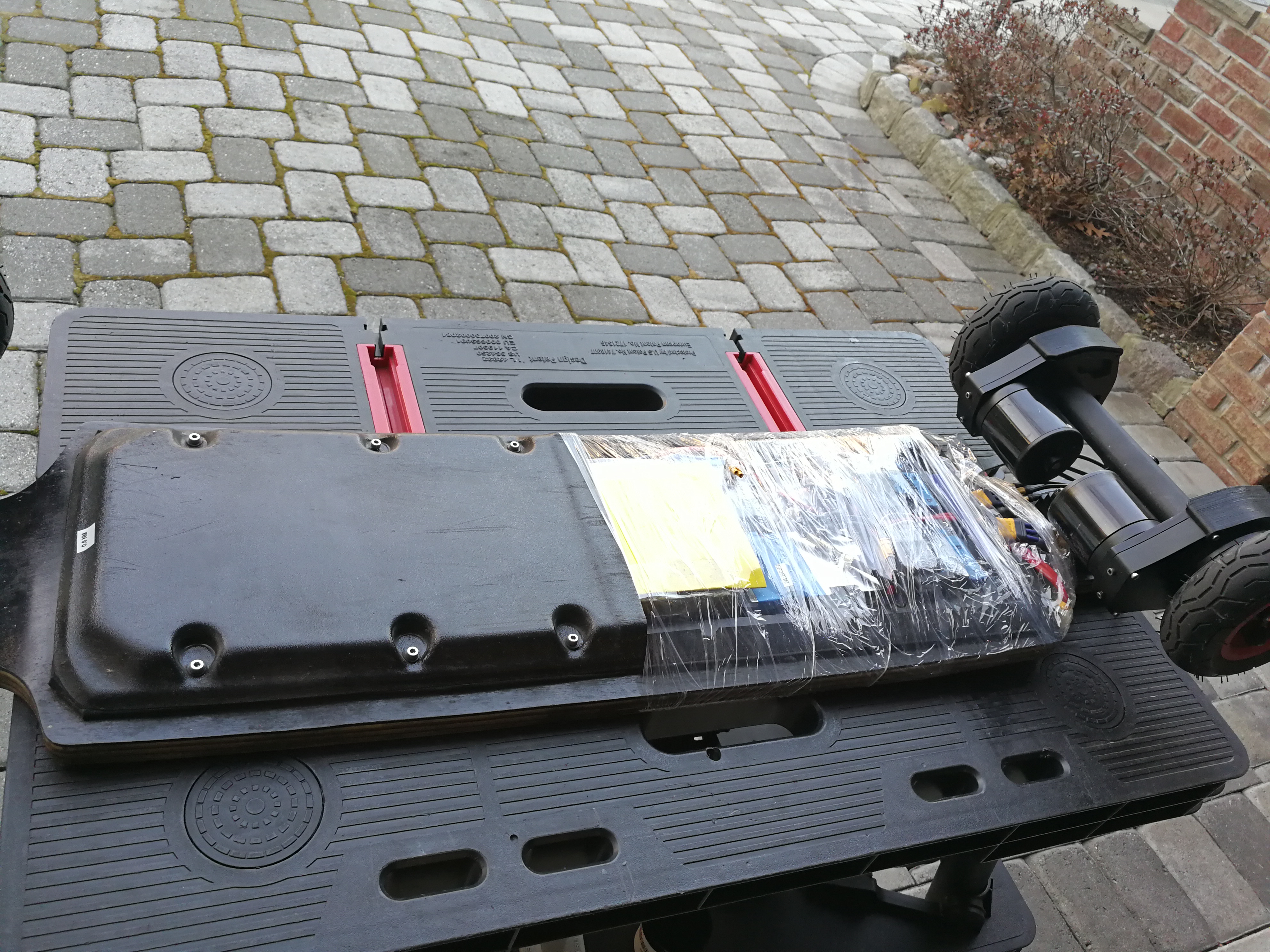

Added LG HG6 to the table. On crazy sale at $2/cell. 20650, so 20mm, which fits 9 wide in 180mm. Probably more like 20.1mm, which is 180.9mm at 9x. Should be easy 12s3p or 13s3p. Same/similar wh as 30Q but 90A vs 60A.

I bought 13s2p worth of P42A, which has more capacity than 13s3p of these guys, and 60A should be enough. But… Maybe the 1mm height difference makes a difference?
Mr. @Sender do you think 21700 or 20650 will fit in the cavity?

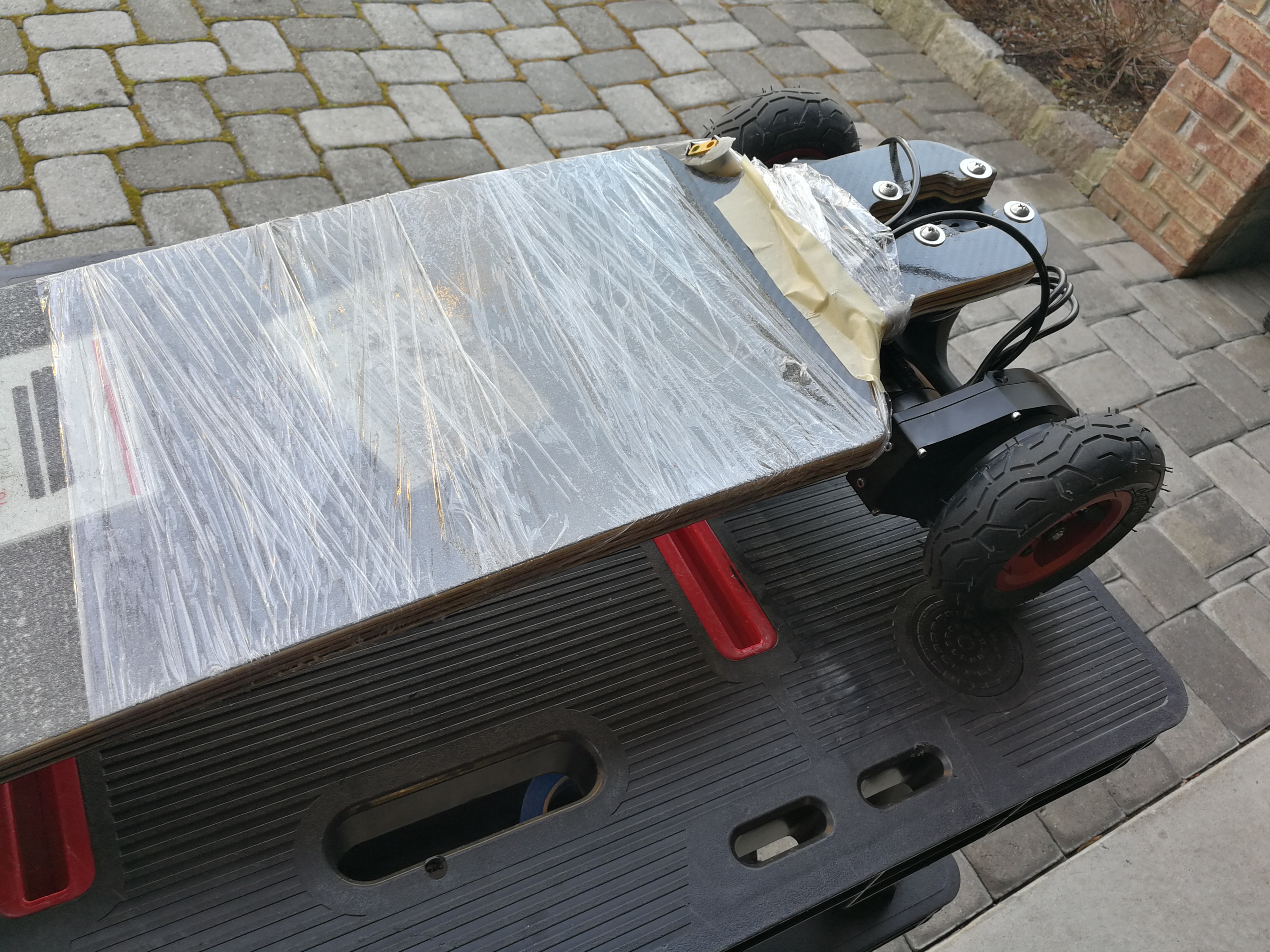

I finally chopped up my hummie build and did a test. Avio mk1 AT with bergs, and the 15s2p A123 M1A pack. I charged it full, 220wh went in. vesc cutoffs kicked in at 178wh drained, 6 miles. 29wh/mile. 6 miles is not great lol.
So it’s gonna be one of these
How is it these 2 packs have almost identical watt-hour… Most likely the HG6 if it isn’t too hard to fit.
Let’s see, I got 178wh usable out of 220wh, so 81%. For the 393wh packs, 80% is 314wh, which is just over 10 miles estimated. Acceptable.

20650 sooooo cloooose. A little shave and 13s3p easy. The lid closes flush! (@BigBen @Sn4Pz)
