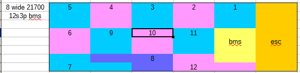

Revisiting this. Mostly organizing and tracking my thoughts.
For 21700, 21x9 == 189 which means 4.5mm relief on each side. The cells are cylindrical so we could route it at an angle or even curved. Lengthwise, 70x5 = 350 which leaves 80mm for esc and allows 13s3p.
I want nummies for this if at all possible. Don’t have a lot of personal experience, but expectations are needing more torque due to diameter, and wh/mile increasing 1.5-2x? So need both discharge-amps and capacity? Lol.
For me, I don’t need big top speed or huge range with this build.

Nothing jumping out as a clear winner. Well maybe VTC5A 13s3p… I have 30Q on hand, and that’s a strong argument. But I can see arguments for 30T and 40T.

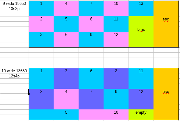

Like, VTC5A or 40T looks good unless 75A is not enough (unlikely), in which case it’s gotta be 30T. Can’t really fit 4p 18650 unless 11s.
Would prefer to keep it EASY.

Added LG HG6 to the table. On crazy sale at $2/cell. 20650, so 20mm, which fits 9 wide in 180mm. Probably more like 20.1mm, which is 180.9mm at 9x. Should be easy 12s3p or 13s3p. Same/similar wh as 30Q but 90A vs 60A.
