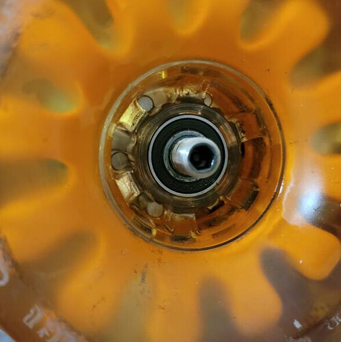

My pins are stuck in my cloud wheels can’t pull them out, any suggestions?
Cloud wheels don’t use a standard abec core, so fitment may be an issue. Can you send a pic?
get a flathead screwdriver, jam it between pulley flange and wheel, starts prying, go around the edge, should pop off easily
Try something similar to this maybe
@Antguy
I would imagine it to be the plastic core expanding with moisture.
If you can’t get it out with force, instead of hacking it to pieces it might be worth a try to put in in the oven at like 50° for a good few hours, door slightly open and fan on check the temp! if nothing else works
