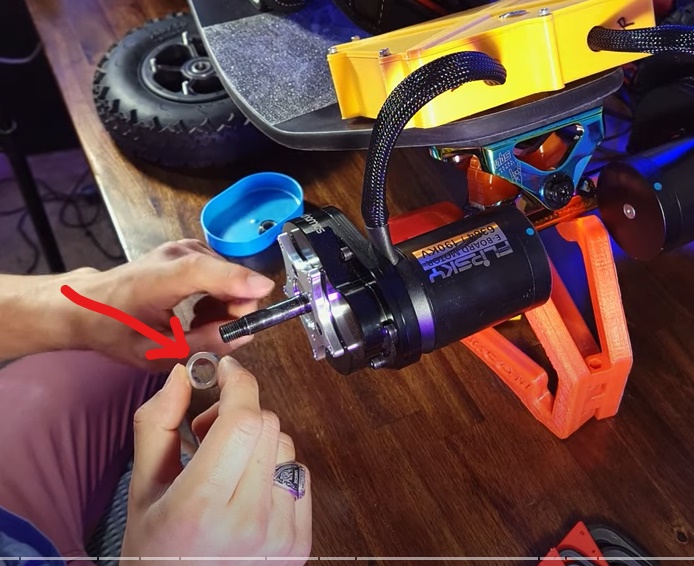

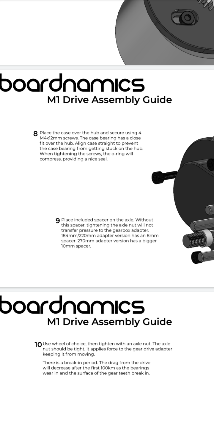

Do you know the mesures of the spacer that goes between the wheel and the gear?
8mm i think.
Hmmm that’s a Kevin question I think, but @cfelzien might be right. Without disassembling, anyways.
Thanks for the help :+1:
@cfelzien 's always right.
Any chance you know if the M1 street geardrive uses the same 8mm spacer (but 8mm bore) or 6mm? I lost both of mine like a moron.
Wouldn’t be a 6mm…
There are two different sizes of spacer for the m1 street depending on what hanger size you’re using(I’m pretty sure the actual determining factor is axel length tho), 8mm or 10mm. That’s length not diameter; I have both sizes of spacer for mine.

how did you go with this ? I had a similar issue and found it to be a different sized spacer between the 2 wheel bearings. Changed it out then eliminated the slop.
Just ended up tightening the wheel a bit more. No rattling nor slop after that.
