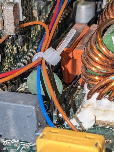

It’s possible I’m just being too gentle but I’m pretty confident it’s soldered in.

That definitely looks like it should work, right size and current rating
If you can get a picture from an angle of where the fuse meets the board it might be easier to tell if it’s socketed. Some barbarians do solder blade fuses directly to the board, but it’s not exactly ideal. The fuses aren’t usually very straight and upright. If you’re OK with soldering it’s not the worst job in the world, but it’s not great for the fuses to push that much heat into them
Also, have you been able to check if there’s any other damage to the charger? There are a small number of other components that could reasonably be killed by plugging in the wrong polarity. If you see anything marked TVS or “D [number]” near where the output connector is, those are top suspects. Reverse polarity could kill basically anything on the board, but the TVS or reverse polarity diodes are more likely
This was the best that I could do without removing the PCB (which I think I will have to do anyways to replace the fuse)
Nothing else seems visibly popped or burnt like the fuse does.
Nothing I can see currently, I’m going to spend some more time trying to get it the rest of the way apart, I wanna take that slow to make sure I don’t break it more while trying to fix it. Once I get the PCB out from the case (hopefully it isn’t epoxied or adhered or anything) I should be able to get a better look at how the fuse is attached and if anything else is burnt.

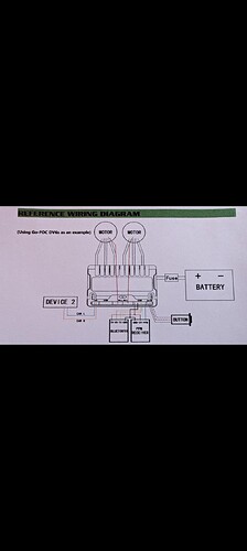

In the process of making my can cable for a 4wd setup. Do I need to do all 4 pins or just the 2 signal lines and leave out the power and ground like this diagram shows
Yeah no power wires needed. Only can-powered devices like davega and stuff need them.
:pray: thanks
