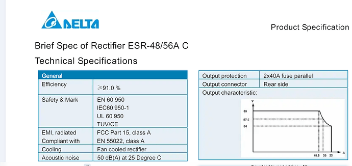

@Egtscs: Those are blade fuses, that side view shows everything clearly which is awesome. I’ve been dealing with so much family and work drama lately i just haven’t been in the head space to actually work on anything but today is a beautiful day. :slight_smile:
digikey 40a fuse
looks exactly like what is on the board… Obsolete…
my friend at the parts house looked up the equivalent current model and its an Optifuse. its a bit lower profile but the blade dimensions are the same and it should just drop in. looked around a smidge to see if there was a fuse holder that would drop in but nothing looks easy to make work or modify.
those solder lines on the board are iirc there to increase either the ampacity of the trace or help transport the heat to the surface (to do the same thing lol) the only thing that made me pause is that this rectifier has been so heavily modified. I thought from my conversation with Ningning (or whoever is running the telegram) that these fuses are in parallel so they should be connected electrically. one fuse is obviously popped - the second is less obvious but clearly indicated its blown also.
Side Quest
By the way, Ningning is not the engineer who designed this or the other modified Rectifiers/chargers. or at least the person i was talking to telegram. They are a smart EUC enthusiast with good connections and some decent business sense. they were going back and forth between me and someone else to get my calibration issues resolved.
also fairly confident that these are the output protection fuses which would make sense them blowing when you had reversed the polarity. the manual for the base inverter (Delta ESR-48/56A c REV 10) is a pita the get for some reason and seems to only be hosted on paywalled sites but one site didn’t do a very good job and i was able to grab a few pages and specs:
“output protection 2x40a fuse parallel” is about as much conformation as i could hope for.
Tldr: grab some new fuses (your caps just showed up btw) and you should be gtg. when you solder the fuse in - eliminate that solder blob or don’t - it doesn’t help or hurt anything. cleaning up the excess flux is a good idea -
