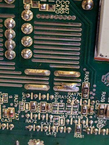

Solder sucker would be my first port of call, followed by maybe copper wick if you can’t get a sucker. Heat up one side, yoink the solder off, rinse repeat
Edit: I do actually mean to repeat it a few times. You won’t get all the solder off on the first go round and pulling on the fuse might just tear up the PCB. Alternate sides and do each a few times
Which bit on here is a fuse?
@Egtscs
These contacts:
The fuse has through holes for the leads that are soldered directly to the PCB.

This has been pretty effective but progress seems to have stopped here:
I have removed fuses like this by elevating the board upside down, and using needle nose vicegrips, as a clamping hanging weight, then two soldering irons, one on each tab, and it drops right out.
I have found a pair of welding gloves at my solder station are worth their weight in gold
I think getting enough heat in both sides at the same time is the hard part.
Maybe a wide tip if you have one too

What flavour of soldering iron are you using, and could you post a pic of the tip? With reasonable technique and iron I’d expect more of a result than that
It looks like the solder wasn’t flowing very well so it couldn’t be removed effectively. More flux is almost always good and it’s definitely worth trying here (old solder joints oxidise, the oxide is harder to melt and remove, the flux removes oxidation). Failing that, if the iron tip isn’t clean and in good condition it won’t transfer heat well. You may also actually need to add a little solder, fresh stuff can help with getting it going
And yup the two irons or wide tip suggestions sounds good to me too. As a last resort you could turn up the temperature on the iron, but that’s not ideal and more likely to damage the board

Alright, after quite a bit of fuss I was able to get the old fuses out.
It seems the leads have been clipped on the old fuses, I should probably do the same for the new ones right?
No need to clip them unless the board has a clearance issue where it’s mounted. More metal = more theremal mass = better current carrying capability.
Doesn’t matter much for a fuse though.
If there is space you should solder on a fuse holder or socket so the next time one blows it’s easily replaceable.
Yeah, what TS said. It seems extremely unlikely there’s room for a fuse holder but if there is then why not.
I also assume they wouldn’t clip them if they didn’t have to, so there’s probably not enough space behind. Reassemble the PCB into the enclosure, then poke the fuses through the holes and see if they have space. If you are trimming them, I’d go slowly so you don’t overdo it
