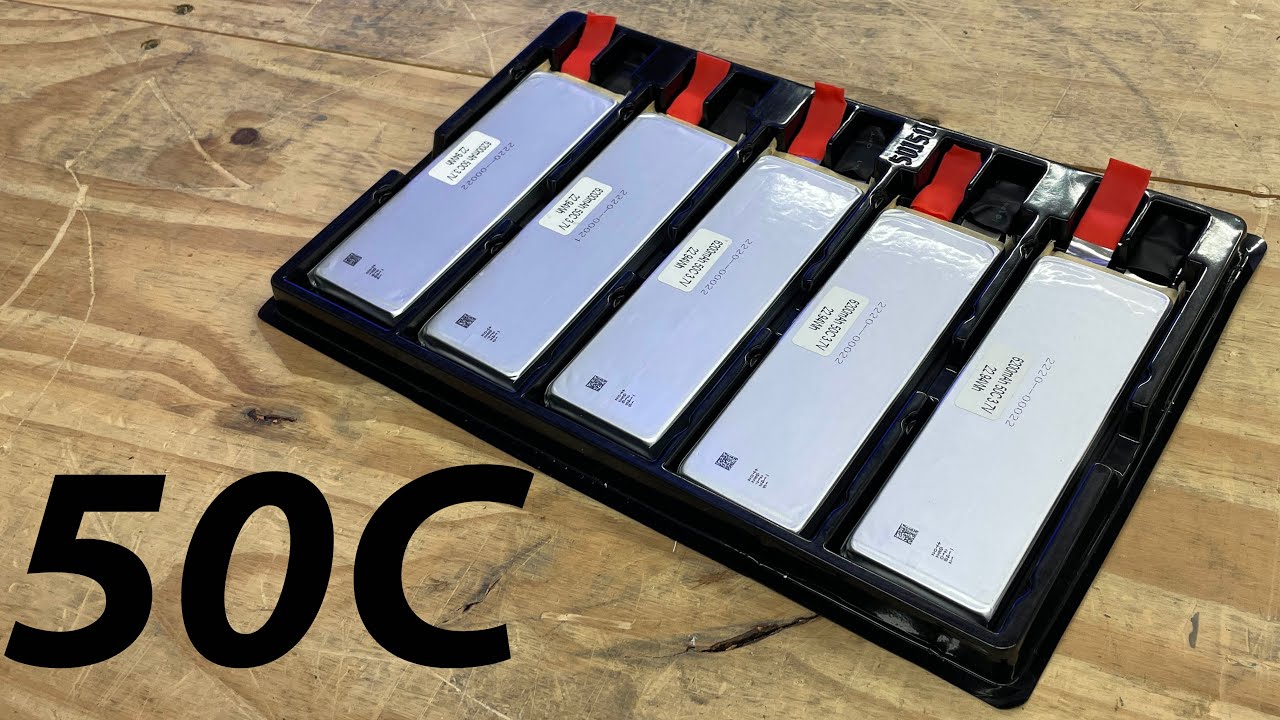

200A discharge 3.7V 8AH flat pouch lithium ion cells
I made some guides for using the TE foil crimps here, just select to show only my posts you will see.
Thanks for the link, that circuit board will hopefully be a good way to use these cells.
50C is over 300A and, IMO, is a spectacularly exaggerated rating but you can probably pulse them pretty darn hard and not have to deal with too much voltage sag and heating.
Would love to know what their cycle life is. LOL…no one ever seems to care about that. I guess as long as the pack runs for a while it’s not a big issue for the price. Personally, I rather pay more and not need to replace the pack for years but I think I am in the minority regarding that. …end whining…

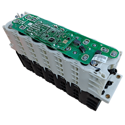

Hey yall.
Soooo… if some random Duck happened to get his hands on like 50+ Hoyt 10s1p Samsung 25r battery modules in various states of disrepair, and wanted to sell them off for really really cheap, would anyone be interested?
Just, you know, hypothetically speaking :wink:

hypothetically, what is really really cheap? like cheaper than building my own 6 10s3p packs cheap? x)
I would think he wants locals to take some. I would be interested in practicing my teardown skills
if u get those a123 cells from me I’ll cut the cost. Cheaper than if u get them yourself and have to disassemble them from the packs.
I’ve torn them all down already. They show 97.5% capacity.
now thats interesting! i was just gonna grab up 200 p26a and sell off the leftovers. im bothering my investment guy today to hurry tf up putting my money in my bank so i can get to actual purchasing phase, but i could probably swing that this check even if he does take forever xD ill message ya!
