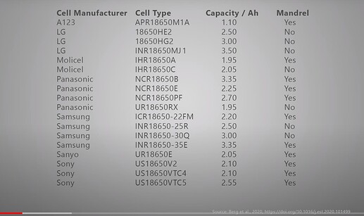

This is some really good info on the effects of vibrations, it’s got me looking into mandrels and stuff. Here’s a screenshot of a youtube video, and it’s got a source in the bottom right corner that might have more data on which cells have mandrels.
Youtube video
The A123 battery model listed there is not one of the 2 listed for sale on the a123batteries website. I’m not sure if they’re built the same way, but maybe it’s a good idea to lay them horizontally when building packs?
Unfortunately that source is a purchase-only paper. :pensive:
I’m confused by that screen-captured table as every HG2 I’ve seen opened up has had a mandrel. Perhaps they don’t anymore.

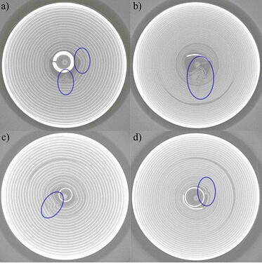

I poked around it a little bit, and it confirms that “The axial direction is the most severe.” (Axial is vertical when the can is standing up.) “The six cells which were reported to show more than 200% rise in ohmic resistance…”
For that info they actually cited the study Hummieee linked above.
It also says “the mandrel has been the most critical component in [the study Hummieee linked], causing damage in the jelly roll and of the negative current collector tab.”
But then check this out:
“All four cell types show jelly roll deformations, most prominently in the Samsung INR18650-25R in Fig. 3b due to the absence of an inner mandrel”
So idk if mandrel good or bad, but it seems like all cells would be better off not vibrated vertically. Then again, Tesla packs all have vertically-oriented cans…
