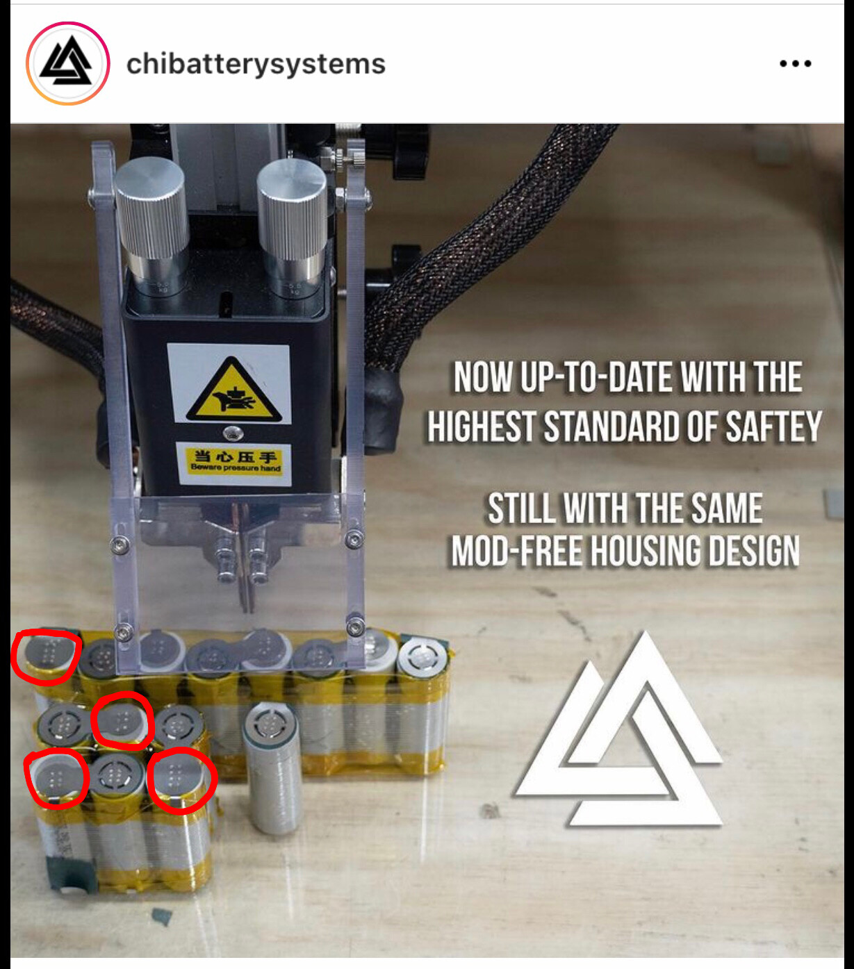

IMO cell level fusing is not a bad idea if done correctly.
But there’s a fine line when making a fuse. Y want it so that that it won’t blow during heavy load but will blow during a short. For esk8 packs those numbers are quite close together.
In cars or ebike this is easy when cells are rated to only 5-10A per cell.
The old original Kaly packs with cell fuses were good. I once shorted a pack and it blew all the fuses for a whole P group. Probably saved the pack in the process.
We have to go back and ask why is cell-level fusing being done?
If it is for marketing reasons and they are not claiming any increased safety then as long as the fuses don’t decrease the safety of the pack or add new failure modes then they’re fine.
If they claim that their cell-level fusing increases pack safety then we have to ask what failure modes/mechanisms does this fusing protect the pack from that wasn’t already being addressed? Is the BMS not reliable? Are the cells not UN38.3 and EN/IEC62133 tested? Are cells being found with a higher than acceptable internal failure rate? Basically, for what safety reasons were these fuses added? What other safety issues still exist?
Cell level fusing…a good concept that needs to be properly applied to be effective, which is not easy at all. There is a significant amount of testing that needs to be done before approving this for a product.
If only three out of the four links blow does that leave the fourth link hot enough to eventually burn through the tape or shrink wrap during normal or heavy use of the pack?
Can any of the fuse links, when blowing, ignite the fishpaper rings? This is molten nickel we’re taking about here.
Have the links been tested under a wide enough range of environmental conditions? Do the links retain their original properties after hundreds of km of vibration and shock? Are the links properly sized for the cells they are using? If they are using more than one type of cell then do they have different size fuses?
I’m not dissing cell-level fusing. I would use it in any esk8 pack I built. But it needs to be done properly and not just tossed in, assuming it always increases the safety of the pack.
Lastly, I’m actually more concerned about the second image of the three in that Instagram posting. The one that shows them spot welding in the center of the bottoms of those cells.
This is where the internal spot weld is made between the metal can and the negative tab from the roll of battery materials. All of the manufacturers say to not weld in the center of the negative terminal of the cell, presumably because it can damage the internal weld. This is being done by a company that, on the same image, claims the “highest standard of safety”?
Things that make you go hmm…:thinking:

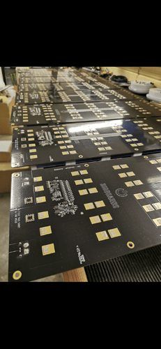

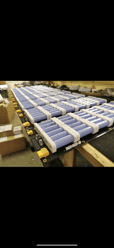

We tested fused nickel for our battery pcb that already have charge fuse and discharge fuse and bms inside the pcb so no balance wires. Also space between all cells.
Problem with cell level fusing with nickeltab is that it could melt and drop down on pcb and make a permanent short.

I think I know why they started cell-level fusing. (Or at least one of the reasons they kinda fasttracked it)
The Onewheel packs are an extremely tight fit. FM uses bolts with several different lengths in the Onewheels and some Chi customers swapped some bolts during installation.
You can kinda see where this is going but on some places longer bolts will go inside the battery compartment. There have been (I think) two instances where bolts have punctured cells which caused fires.
