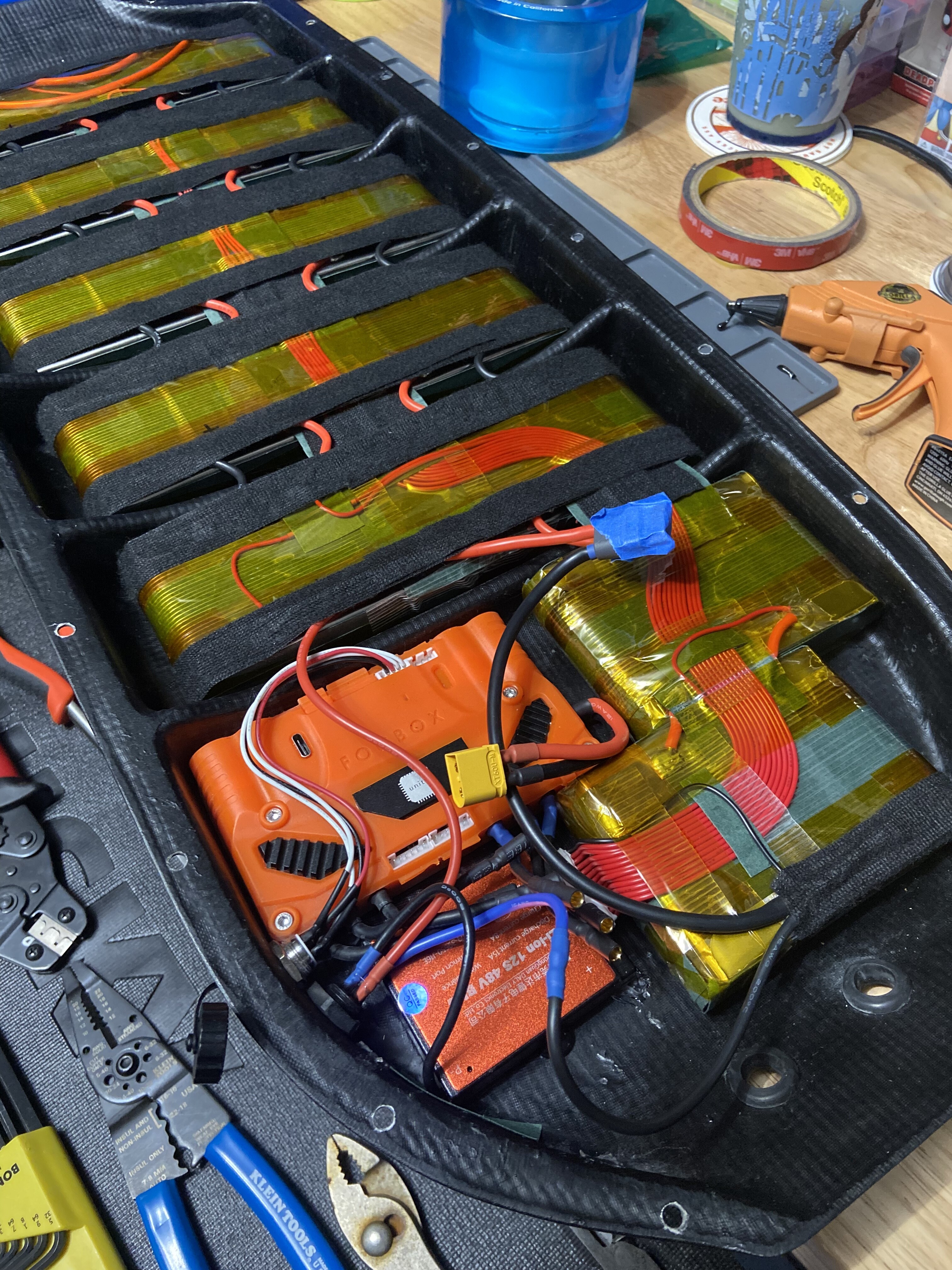

I use Teflon/PTFE wire for all the Onewheel batteries I make. It’s a bit harder to strip, but I use a special wire stripper and it makes it easier.
In terms of durability, it’s the best I’ve used.
Silicone wires squish more easily, but I can strip them with my thumbnail easily.
PVC wire melts easily and deforms with heat, but I cannot strip or tear it without tool assistance.
PTFE is very strong.
I’m not sure why there’s such a veneration of silicone balance wires, apart from them squishing before actually crushing apart. But it’s the least abrasion/sharp resistant from my use and tests.
Here’s a pack:
I think I did a decent job.
Here’s another:
Here’s a Onewheel pack I did with PTFE wire.
Historically (short history, but rife with numbers), wires being crossed without fish paper between them hasn’t led to failures using PTFE wires, even when these kinds of packs are compressed heavily on installation.
That’s not to say one shouldn’t consider doing that, but it’s worth having a realistic view of things.
Granted, it’s hard for me to have a realistic view of things myself since there’s much I don’t know and also have to balance anxieties with build completions.
