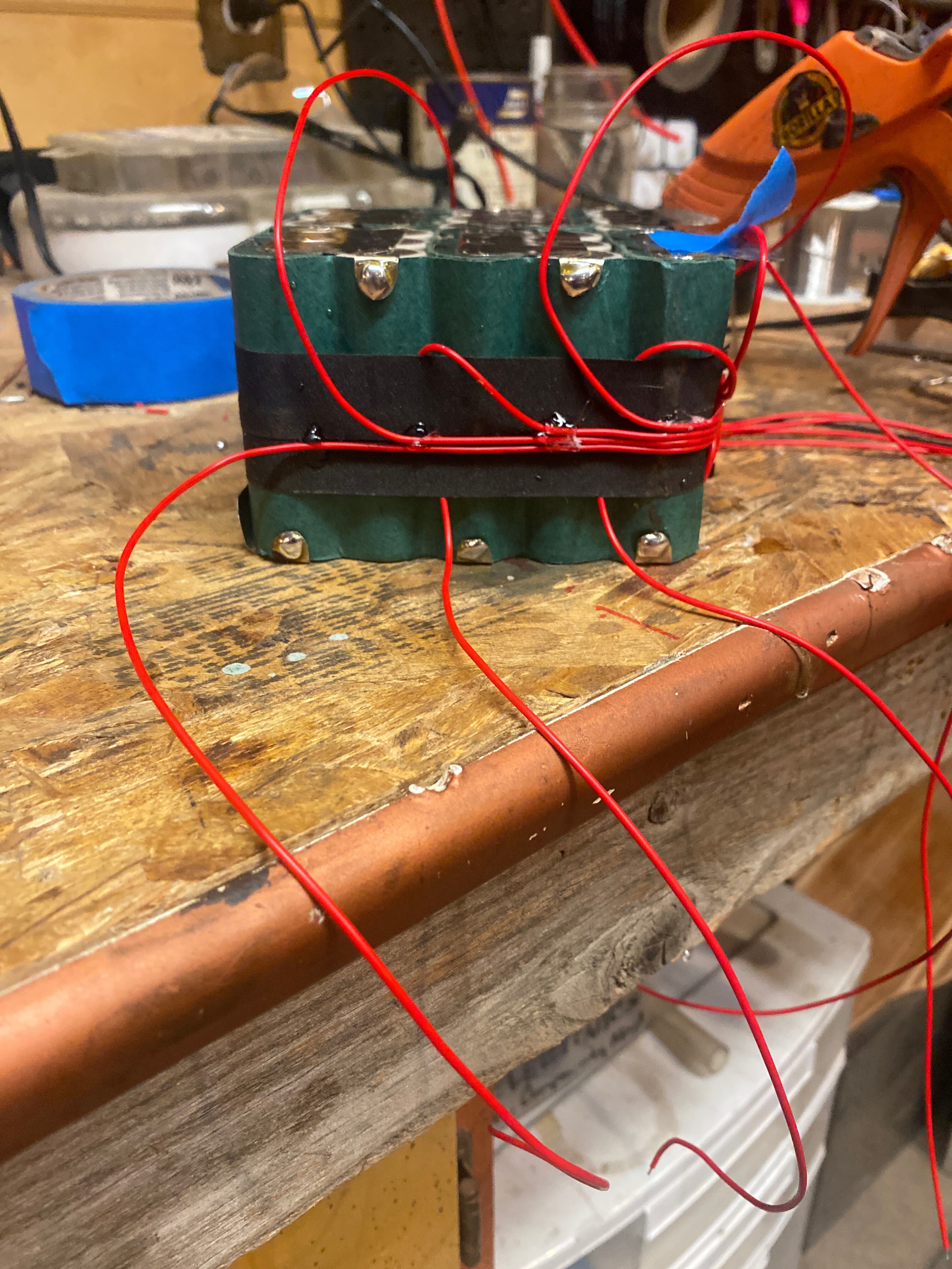

Jokes on me… I’m glad I thoroughly check balance voltages before connecting. One of these little buggers got twisted in the base and I mis soldered. Easy fix if you check things first.
I would be more concerned with the soldering on these then the routing of the balance wires…

What I was thinking is that A+ meant there was nothing you can possibly point out that is bad, basically flawless. Where there is ambiguity, I just tend to compare to the others I guess. IDK we will figure it out.

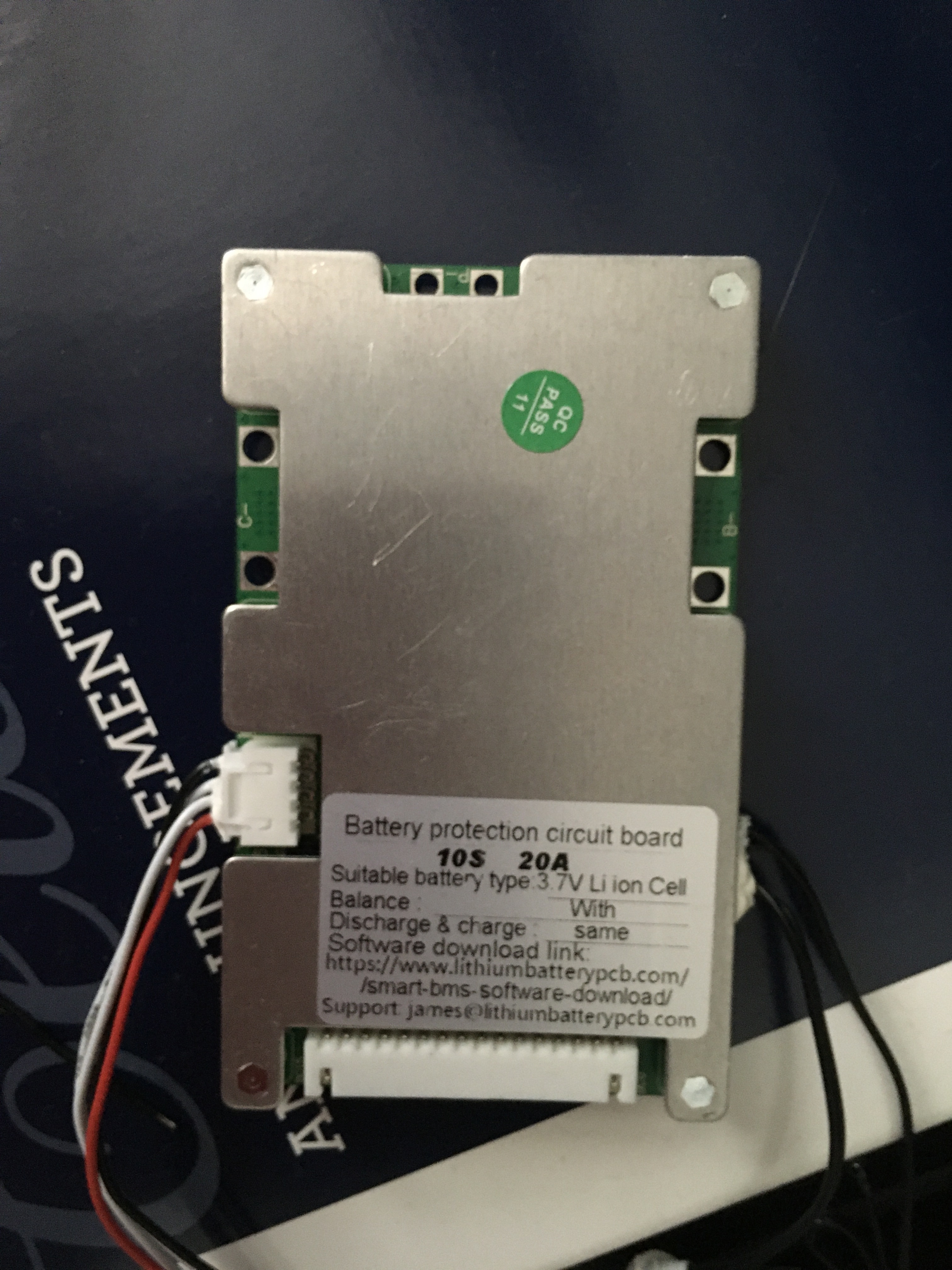

Anyone know if this lineup for the BMS balance wires are correct?

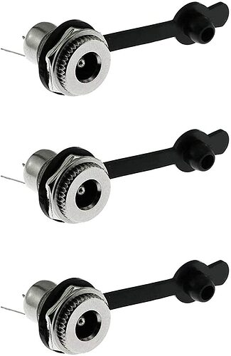

Also I have no idea how or where to solder the charge port to the BMS, help will be appreciated💯
try watching the video about bms wiring that LEE WRIGHT DIY ELECTRIC SKATEBOARD BUILDER made
Got a lin- never mind I watched the video. I don’t have a battery pack like his, mines are lipos. Soldering the balance wires are easy money, just need to know where the charge port goes
LIPO Charge only Smart BMS wiring Guide
charge port: batt pos, bms power neg. fused
Ok, its a DC port. Does it not matter where the wires go or it goes in a certain part?
Could I solder the positive to the battery harness main positive, add my fuse holder in between the negative wire to the BMS power?
You need to connect your charger to the balance port and determine which pin is which with a multimeter. That’s the only sure way of doing it.

Ah ok, couldn’t figure out your comment at first but now I know what you mean, wondering if this is how i wire the charge port. Just making sure before I start it this week so I can finish lol
I have the same charge port, middle should be + and outer -
