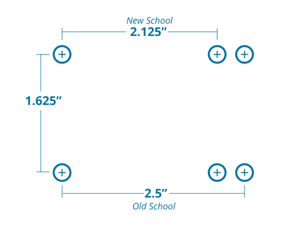

Also, i dont know if the trucks will fit my boards holes. I would dismount my default trucks but i dont know if the holes are matching for the new truck. Sadly i couldnt find info on the measurements of the truck holes. Is that always the same for longboard trucks? Also in the description on aliexpress they say its for a 9-10 inch board…but mine is 90cm or 35inch. Will it work fine anyways?

As for the truck mounting holes, most boards use either old school or new school layout:
description_image_longboard_mounting_holes_grande

The 9-10 inch deck measurement they’re talking about is deck width, not length.
I’m assuming you don’t have a 35" wide deck, you mean length

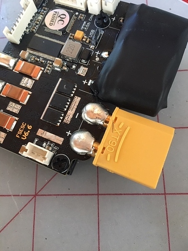

I just wanna make sure I don’t screw this up: what do you think is the best way to remove tis XT90 and replace with an XT60? Super simple job I just don’t have any wick–think I could just press a hot tip to the joint and remove it?
