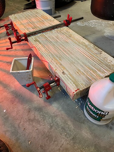

Learning from last glue-up, massive amount of glue is the way to go. Also upgraded from Titebond 2 to Titebond 3 (going pro).

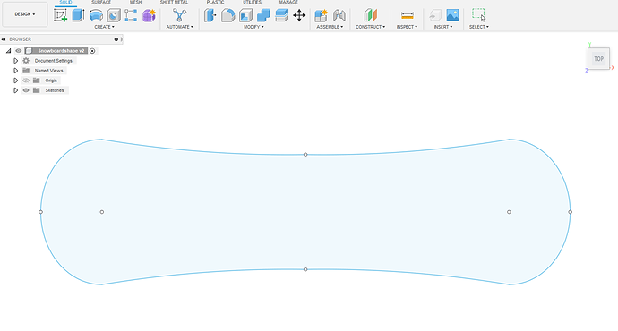

About the shape. Probably going to go with a classic snowboard shape even if I love my old custom TIOEMM Jones flagship shape.

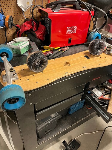

Hi gents, I’m new on this forum. Really interesting thread going on here… I’m working on a prototype to upgrade the casters to a 105mm wheel. I bought this SBX for cheap, it has a faulty ESC and battery. The project still needs a lot of work. I’ll make a post about it when it’s more complete and functioning OK.
Please show rocker pics lol. Looks like some part of the system needs biggened…
