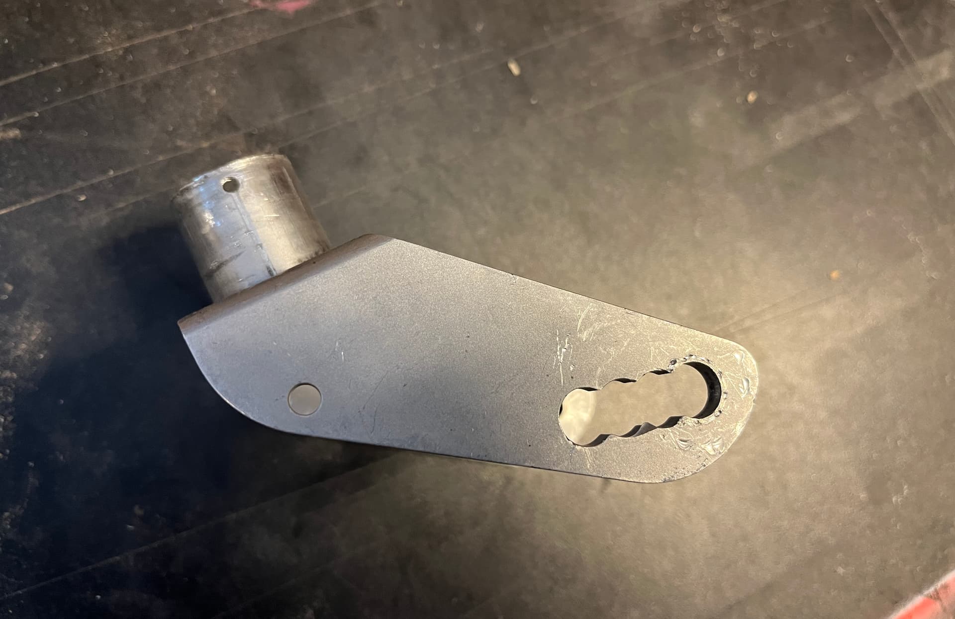

The second most important part (that also separates the e-freeboard from a standard esk8) is the two 360-degree rotating casters that makes the board slide and spin in any direction. These casters need to be really, really strong and be able to hold the load from riding the board. My last iteration (4 mm aluminum) was to week and started to bend after some extensive riding (jumps included).
Selecting material for the casters and finalize the shape is still something that I struggle with. On one hand I want a nice-looking caster, pretty much the one you see above but on the other hand it should also be multifaceted and support several different drive trains. The ultimate build should support interchangeable drivetrains. If you first want to use a belt drive you could easily switch to hub motors or later change it to a gear drive. In that sense I think function is more important than design.
When it comes to the material of the caster it should probably be steel that you could bend, drill and shape to a final caster to support the DIY aim of the build.
