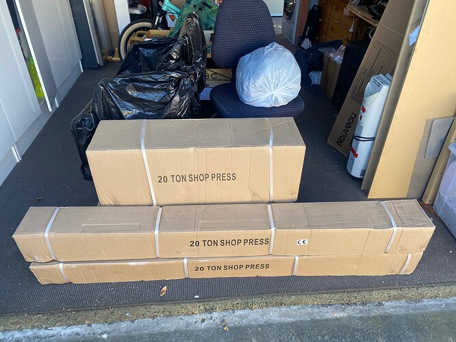

Just finished building a press here.
Still building mould.
Maybe consider pressing up, don’t need return springs?

Looks awesome! That’s a pro-press for real, love the red. I was considering pressing up but I was worrying about the bottle jacks would be messed up with all the glue. What kind of molds are you making now, wood, concrete, I saw you made wooden molds before?
Making a concrete mould to match with one of the wooden composite mould I made. Have made a plywood box formwork. Planning to pour the concrete over a dense foam layer over the timber mould to give me the right offset for the deck (if that makes sense)
Cool. Have the same idea but I’m a few steps behind obviously. Going to make a wooden mold to press my first blank then the plan is to make a concrete mold from that blank or I might use the wooden mold, we’ll see. But if I know myself I’m going to be satisfied with the wooden mold until it breaks.
