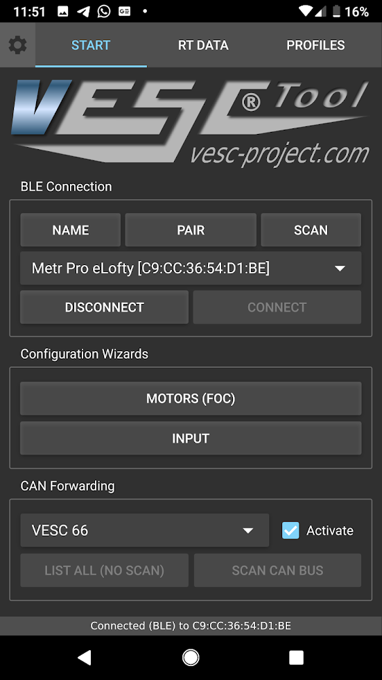

A guide in, mostly, pictures to configure a pair of VESCs/VESC based ESCs(connected over CAN bus) using the android app from app store(you should be able to get it from the vesc_tool webpage too). Let’s start.

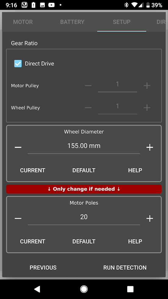

Search for your BLE connection, select and hit connect. Select the 750gram motor. Select override and enter the correct number of motor poles(number of magnets). For elofty it is 20. The max power loss is used along with winding resistance to determine safe values of motor current for you. We’ll set the motor current later so you can just leave the “Max Power Loss” at default value.

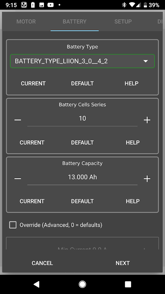

Then select number of cells in battery and the total capacity. Vesc uses this number to decide the battery ± Amps. You can change that later if you want.

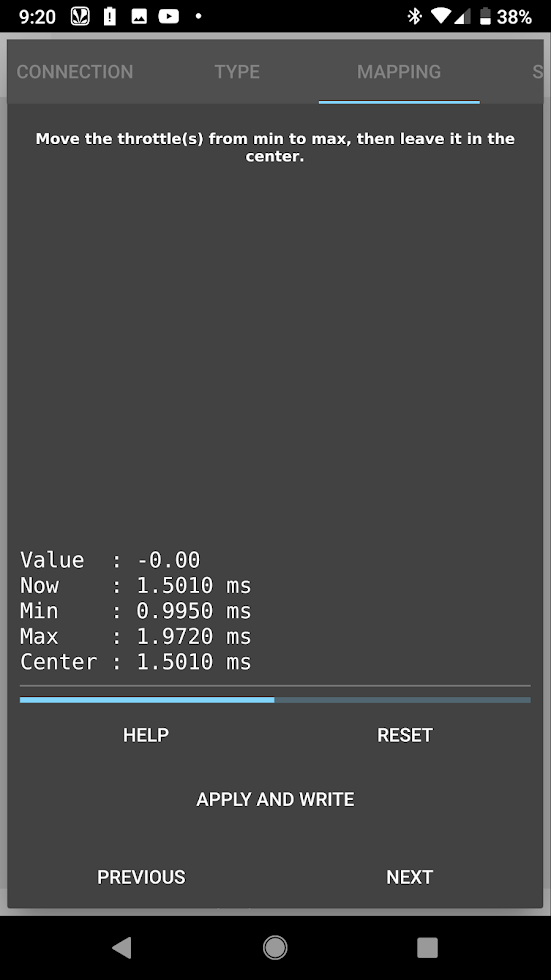

Now Click INPUT to configure your receiver, in my case it is a ppm receiver.
Notice that I have selected control type as “current”. This allows me to go in reverse direction. But I am using it to get much stronger brakes(active braking) with direct drive motors. However the problem is the once it stops, it will start to accelerate in reverse direction and you might fall. So we counter that by putting a limit on the reverse speed. You’ll see later. Also make sure to enable traction control. Also make sure to enable traction control

Do this for the second vesc too by clicking “scan can bus” first and then clicking “activate”
