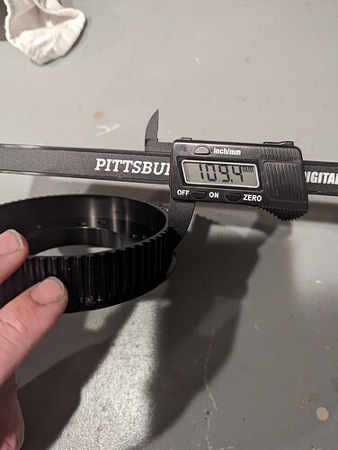

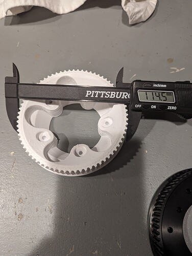

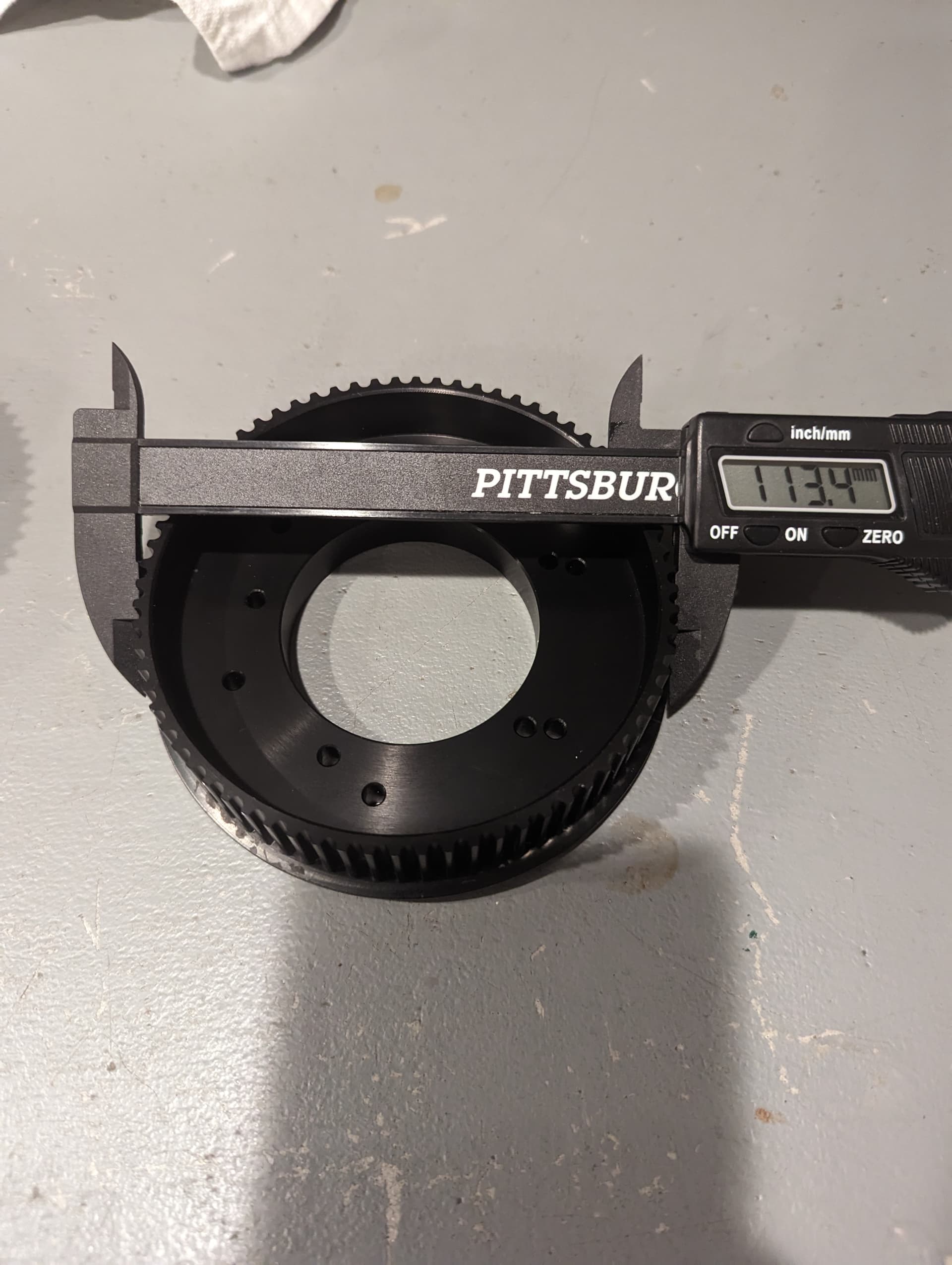

Just to follow up, I ordered some trampa pulleys, they were only 10$ each so it seemed worth it for aluminum.
So I compared the printed one to the aluminum, my printed pulleys are only 1% larger, hard to believe that little difference created so much interference.
Yeah well, when you’re talking about multiple tens of teeth, 0.1mm each tooth builds up pretty fast
I suppose, the 1mm in diameter added 4mm to the circumference, so in my mind that explains why about half way around the pulley it was almost a tooth off.
Note to self, print a slice, check proper fitment, a THEN print two full pulleys ![]()
I didn’t really think about it, never had a problem on my smaller pulleys, they fit perfectly.

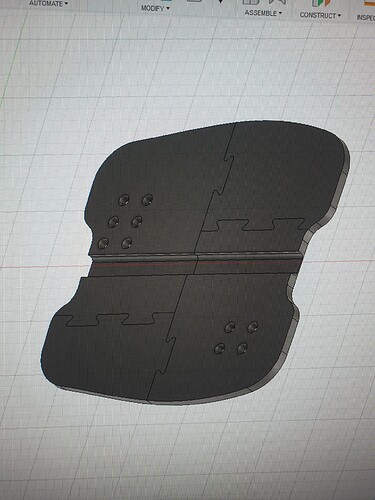

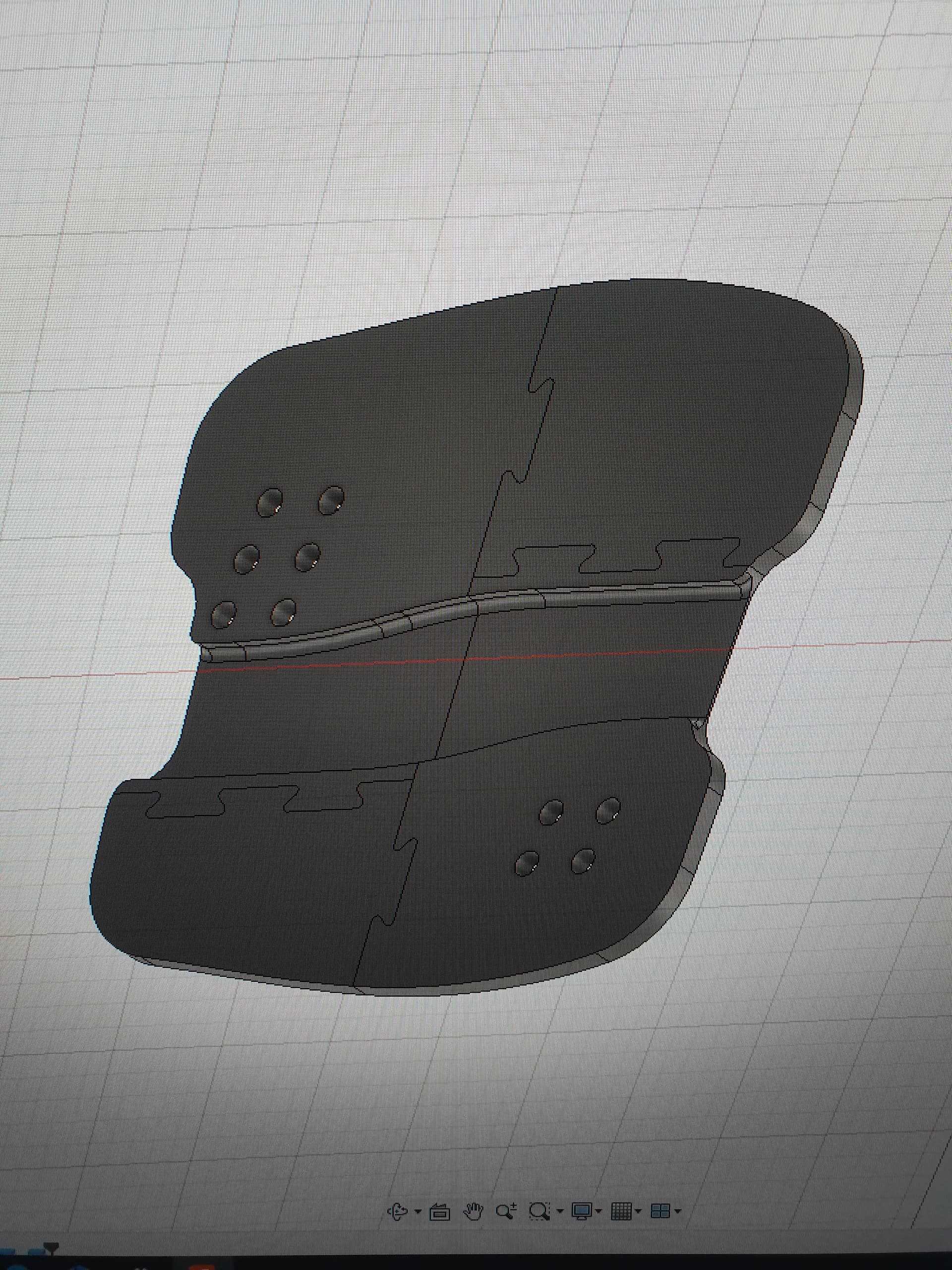

Made some stomp pads for the v2 haero that should be able to be printed on pretty much any size printer. I’m printerless at the moment but would be cool if someone could test! There is zero clearance between the pieces, so that could be problematic depending on how accurate your shit is.
I figure TPU is gonna be the best material, with a reasonably low infill for some cush!

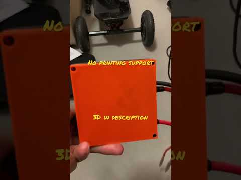

Hi. Not clear if Iam in correct thread. I designed Kweld upper case for no support print. Maybe it will help.
#electricskateboard #electricmountainboard #portablespotwelderThis is remix of original kWeld – 3D printed housing (version3) just for upper part. You nee...

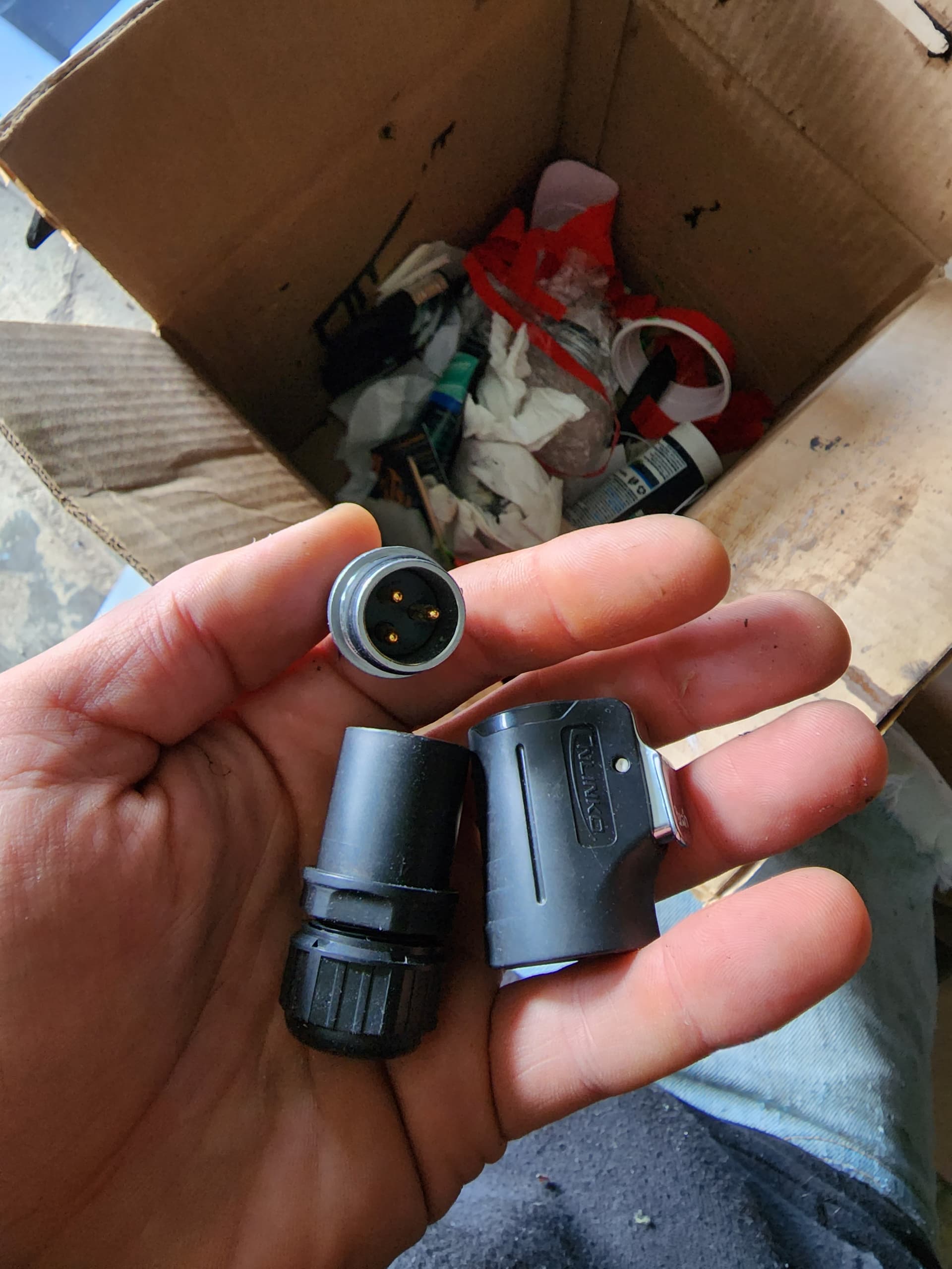

Anyone ever make a cover for the 2 pin circular Cnlinko charge port?
I forgot the rubber cap when installing, which is kind of fine since I’ve always thought the cap is insufficient anyways, it always slips off while riding.
I think there is one in the bin in my workshop… i could model one for you
