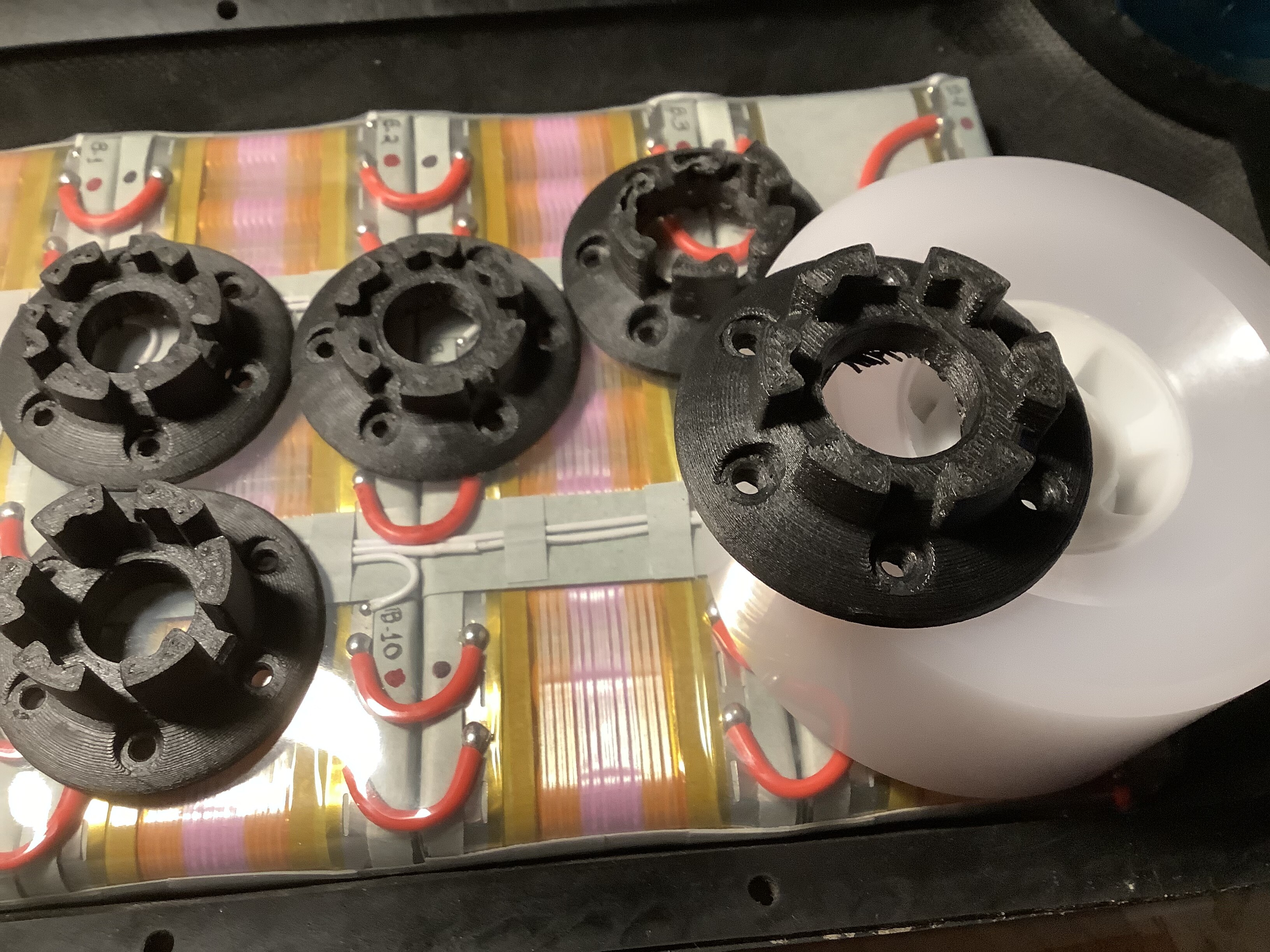

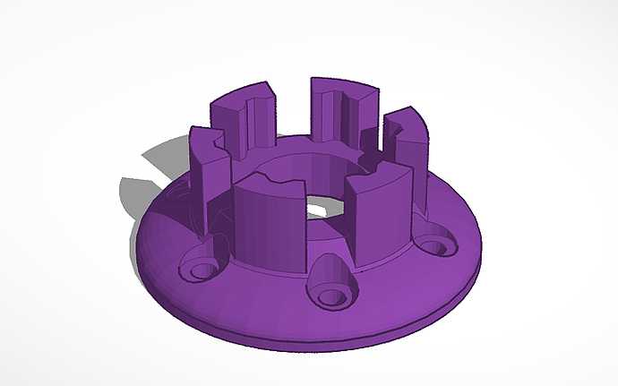

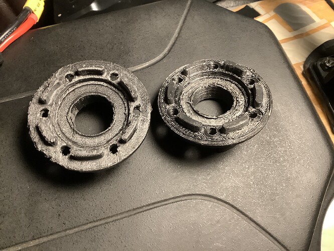

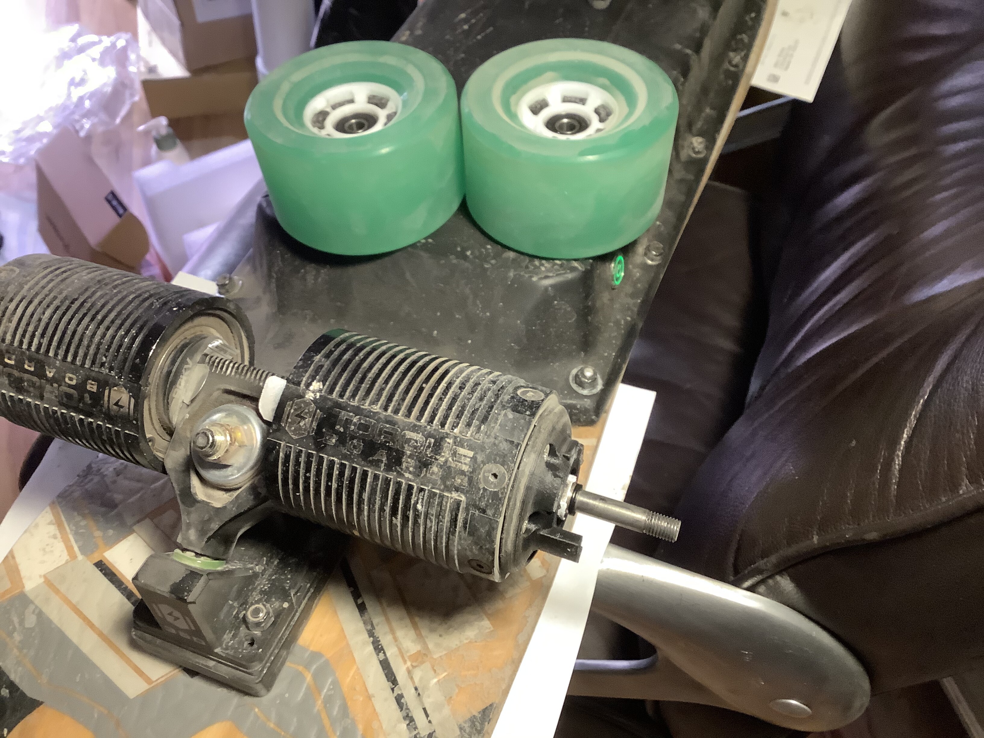

Finally done. Just printing the final now with extended forks. The bearing seat might be a bit deep but you can edit this. Oherwise fittment is awesome forks could be slightly wider. Printing with Prusa I3 mk2S Priline Carbon 255c nozzle 80c bed.
Also I didn’t add the teeth to the adapter like the tb does on the motor side of the adapter I might still add this so it doesn’t stress the screws as much.
Torqueboards Direct Drive Glow Wheel Adapter.stl (202.2 KB)
Here’s v2 wih the motor side prongs they needed a bit of tapping with a rubber hammer to get in or some filing. I think we are done here. Printed with 4 perimeters and build plate only supports.
Torqueboards Direct Drive Glow Wheel Adapter 2.stl (546.0 KB)

If you get a good print you can’t snap it by hand it at all but it’s stressful for the printer. 100% confident in my adapters not snapping, skatan
@SJReason yeah its meant for the glowwheels wih shallow cores specifically but you can modify that tinkercad link to easily extend it.
Guess they didn’t hold up :sweat_smile: how long did they last

Sorry didnt see this before, like 2 hours before the forks snap.

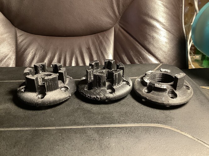

Ive printed them 90 degrees the other day with supports, but with the hanger bending issue I’ve been reluctant to put harder smaller wheels on. When its warmer I will test them again at night. They look a lot worse printed sideways which is why I avoided it :joy:. Some tuning would probably sort the quality, but they work reasonably well that I can do some testing again soon.
They may need some redesign with tapered edges somewhere if this doesn’t work.
The bearing support/spacer does come out a lot nicer though:

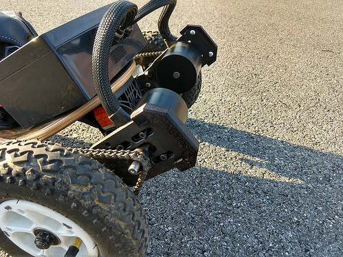

Made some very basic bumpers for the Boardnamics XL/Matrix II gen 2 motor mount. Mounts onto the mount with two 8-32x1/4" screws where the crossbar holes are, although I’ve included the STEP file if you want to customize it for different screws. Uses roughly 7g of plastic each, no supports required.
