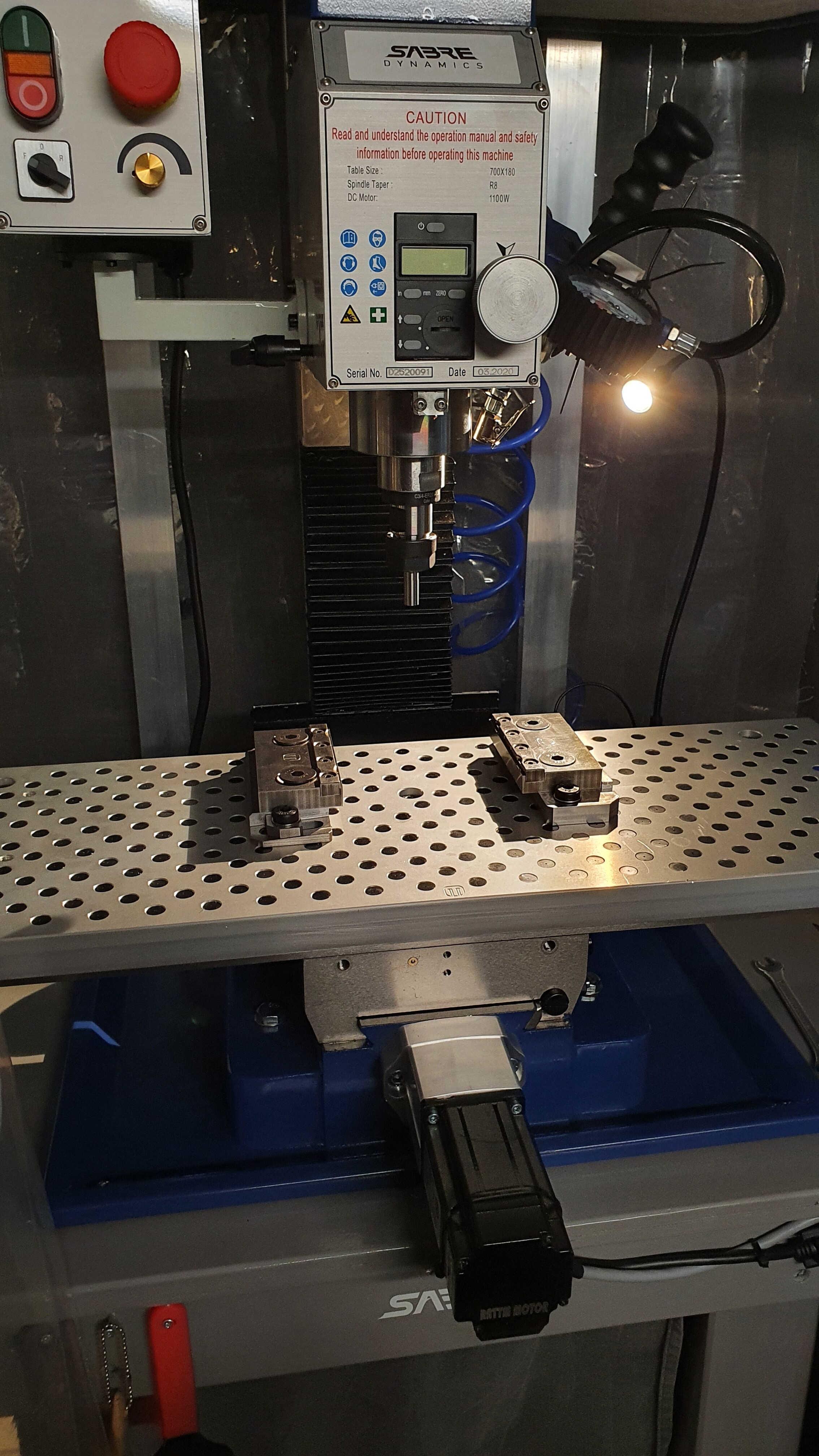

Do small manual mills exist? Back in college, I used to use a full size Bridgeport, but there’s no way I’m gonna be able to get one under $5k, let alone fit one in an apartment. It seems like all the desktop mills I can find are CNC, and I reckon a manual one should be cheaper if they even exist.
They do indeed. Sherline makes both a mini mill and a mini lathe, as well as a lot of the other machine sellers like Grizzly, Harbor Freight, Seig, and others.
You gotta set your expectations to a reasonable level though, such small machines are not very rigid or powerful, so you have to use them gently to avoid too much deflection.
I converted a smaller BF20/G0704/PM25 type manual mill to CNC for about 5k, im still working on the conversion and has taken me 6 months already (with lots of help from others). The process teaches you alot though. For parts you dont want to cut much in cost because you will have a bad time, I already noticed this with some cheaper components I got. Something like this would cost at least 4k taking into account tooling and assecoires necessary to get up and running. Your best bet is to buy a CNC converted mill second hand. You wont be able to make a new one cheaper and it can save you up to 2k.

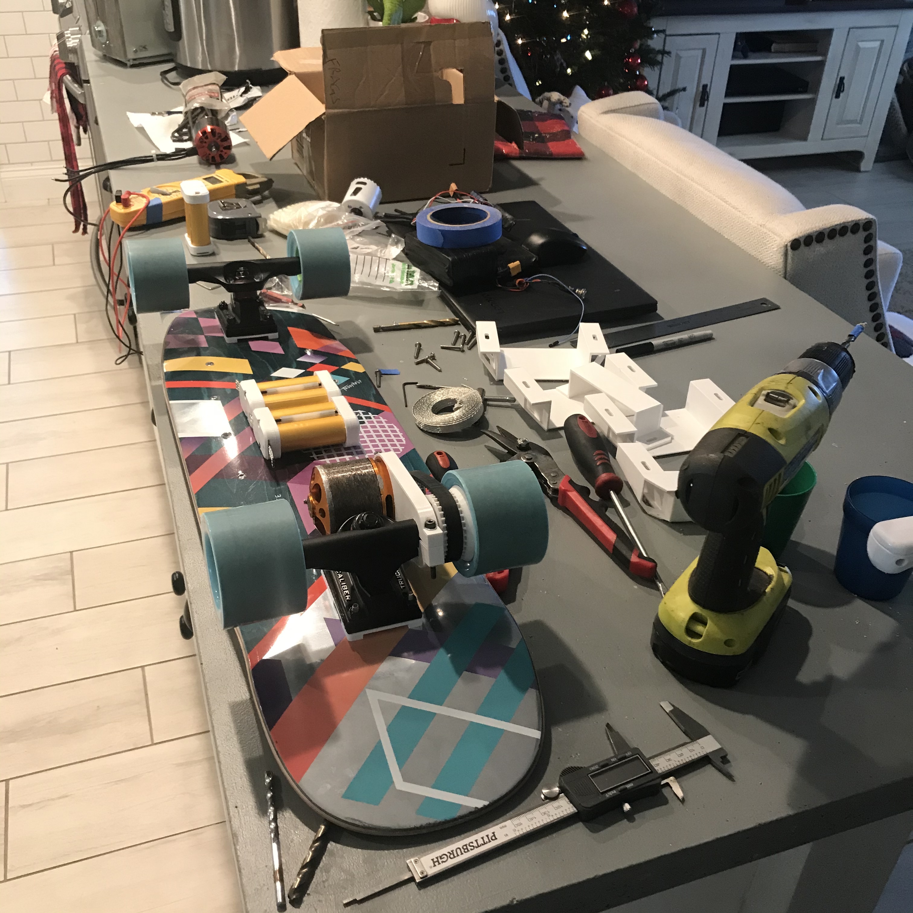

Assembling the printed compression pack!
Got my mount and wheel pulley on as well as the enclosure, man I love 3dprinting
Oh I wasn’t even thinking about converting it to CNC. I’m totally fine with manual milling so long as I have a DRO. It’s not going to be used for commercial purposes, so labor isn’t an issue, and I enjoy the machining process.
I have a Seig minimill…It should do the job, but tons of backlash, so go ver slow with them…unless it is automated and then it would be an easy job for the minimill…
