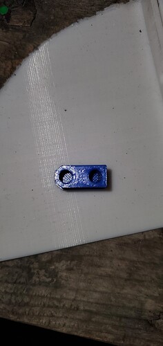

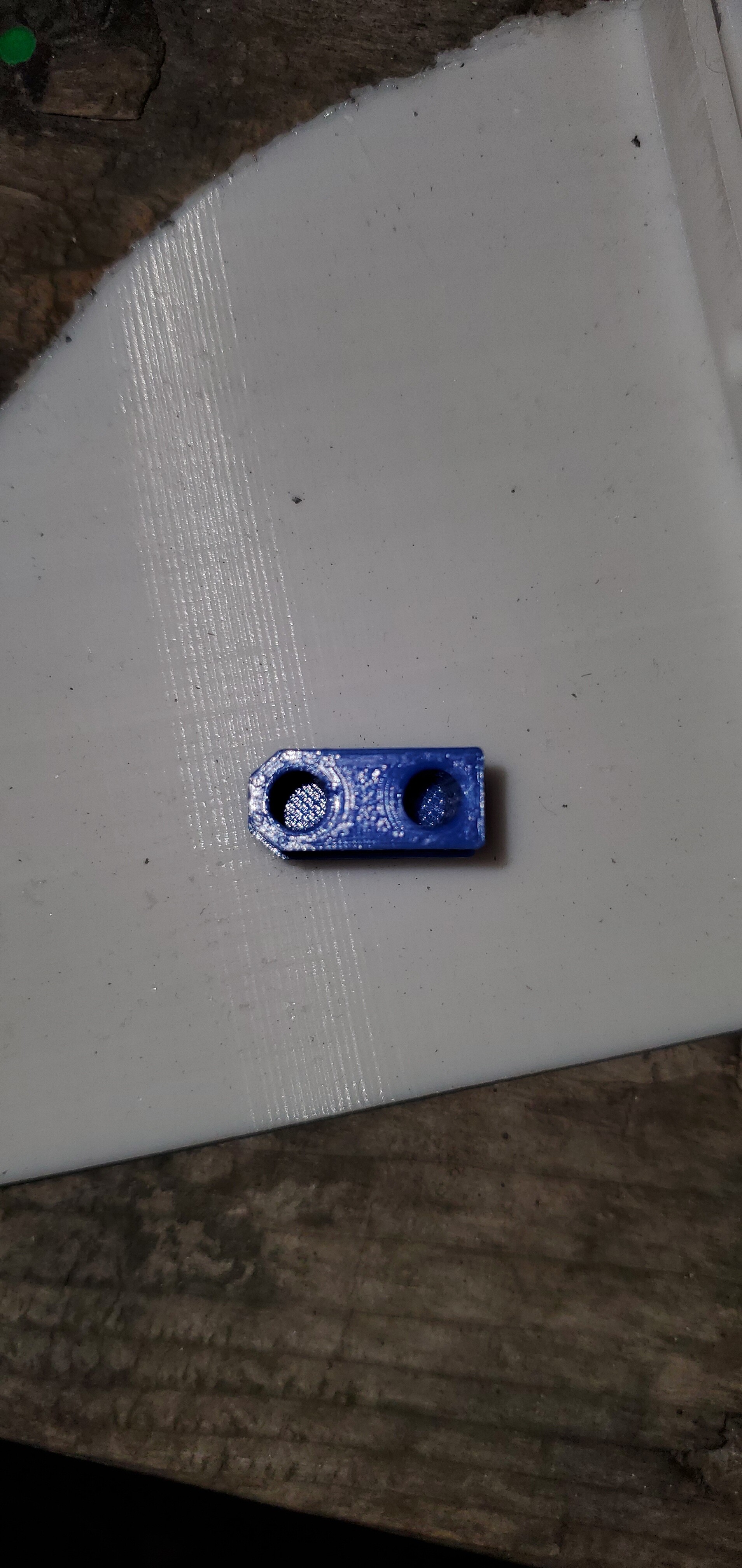

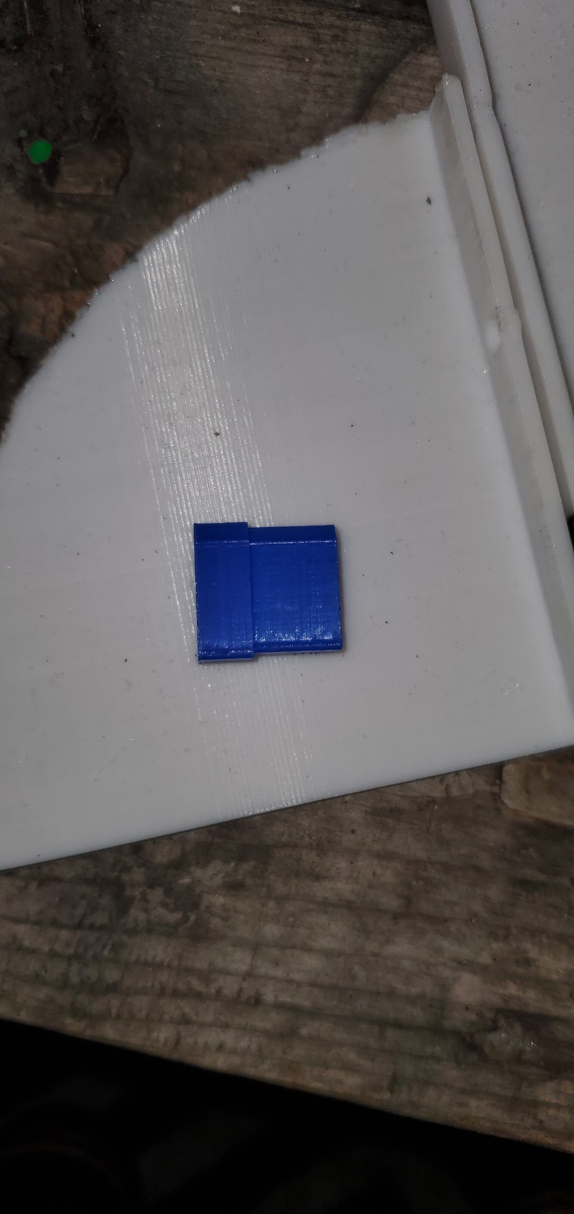

Anyone have a file for a plug for XT90 male connectors that doesn’t go outside the connector? I have a male end epoxied into my enclosure and would like something to prevent contact either between the two pins or the pins and something conductive. If not, I’ll make one and post it here
Do you mean male as in the bullets themselves, or male as in the housing itself?
Because they’re reversed. The male connector is the one with pins, and the female one is the one with holes. The shape of the connector body is the opposite.
I have a fake female?
You could probably bring it under bed level in the slicer to make it closer to flush?

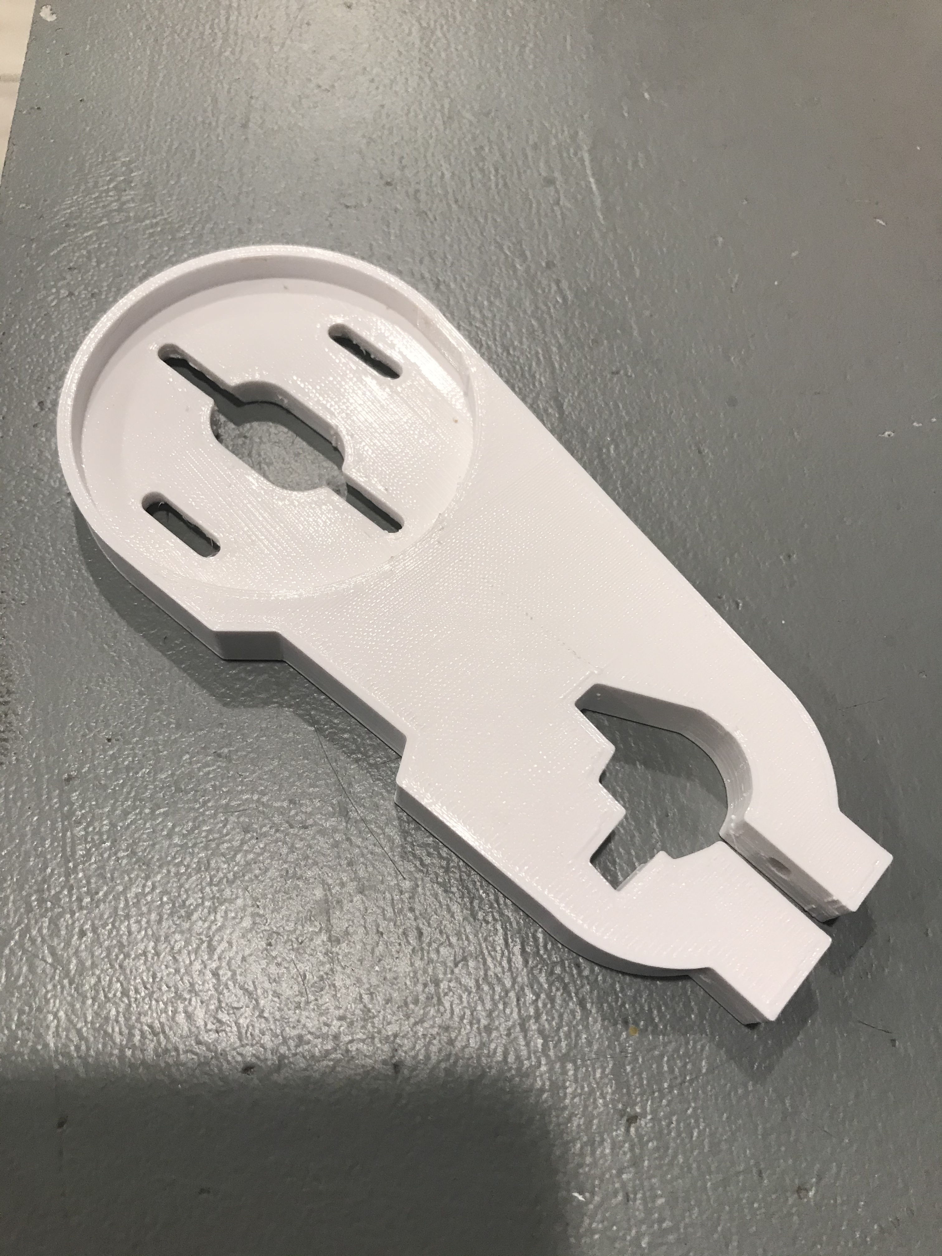

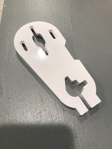

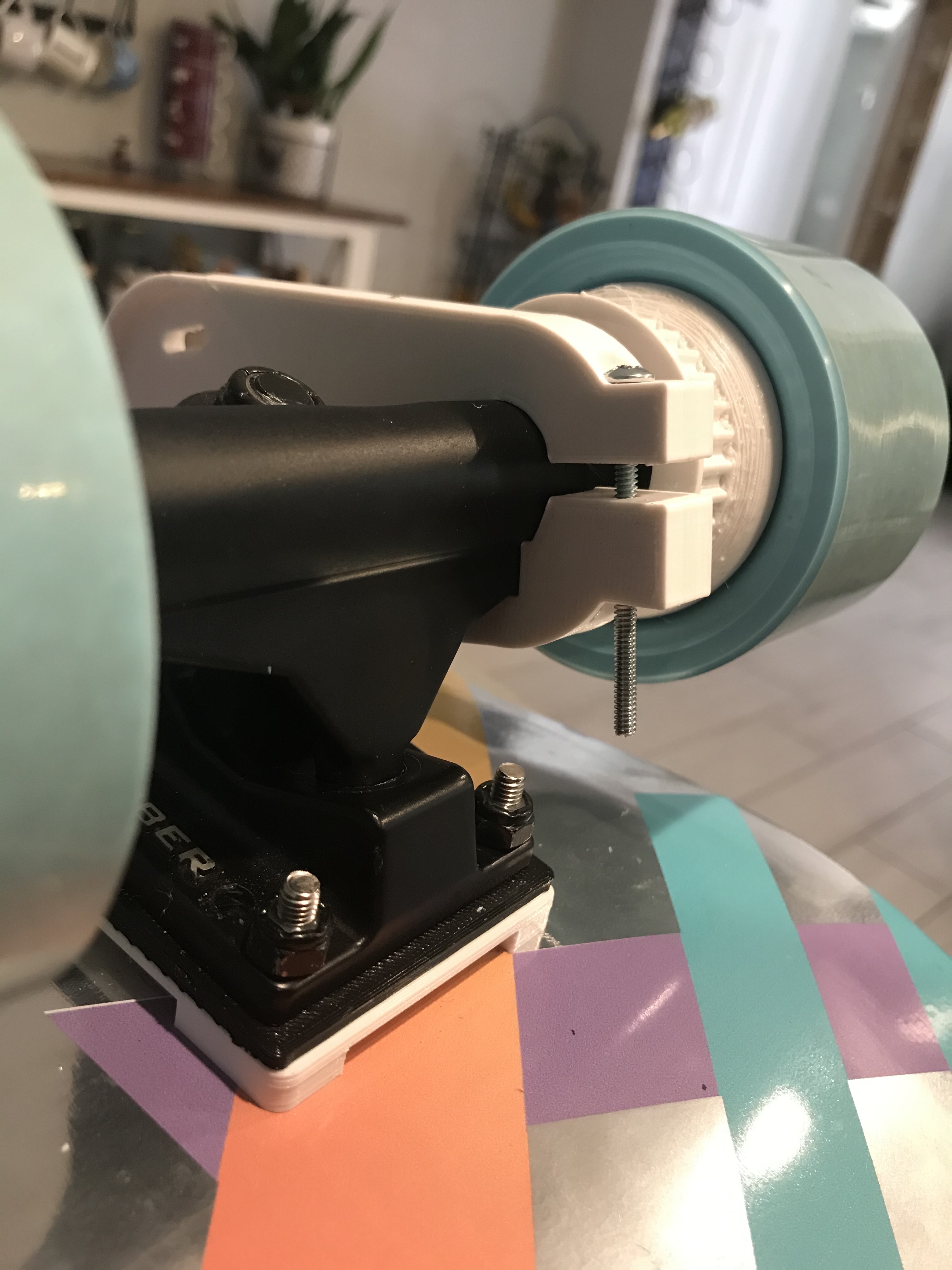

148mm caliber 1 motor mount I made. Solid bottom layers 12mm thick, I think it will hold up, testing soon.

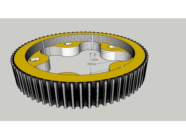

60T MBS Hub Gear .stl for Printing
I have a few more I’ll be posting as well, 70T, 72T, 66T, 63T and a few for Trampa hubs as well
Designed to work with Twistar, Rockstar Pro, Rockstar (that I know, likely will fit most) and takes 50-70mm bolts and m4 lock nuts fit into the spaces on the gear.
Depending on your setup and tire size you’ll likely want the 5mm standoff - its in the file on thingiverse.
Enjoy and let me know if you have questions!
66 tooth for MBS:
70 tooth for MBS:

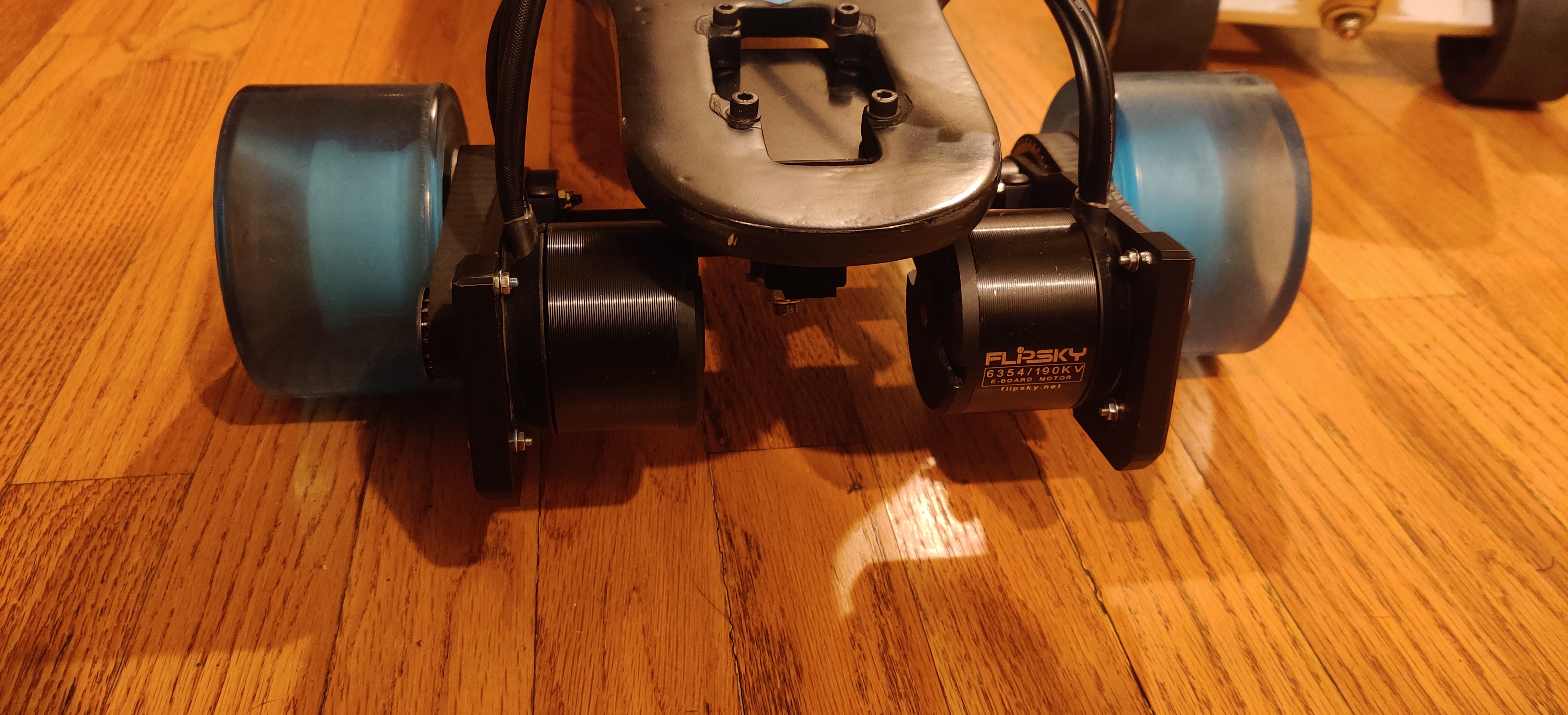

Finally finished, my BN (motor) Bumpies (ers)
I’m looking forward to the day someone can 3d print a reliable motor mount. I don’t think it will hold up but I hope to be proved wrong.
Which material did you use?
Pla? Petg? Neither of those will hold up for too long. Your motors are going to use that as a heatsink and malform easily. Not to mention heat from the sun.
Try some alloy 910 at the least.
I used petg. I’ll watch for deformation. With it being 100% solid the weakest part would be the area where the motor is recessed, in reality I’ll be cutting this mount from aluminum after the testing.
