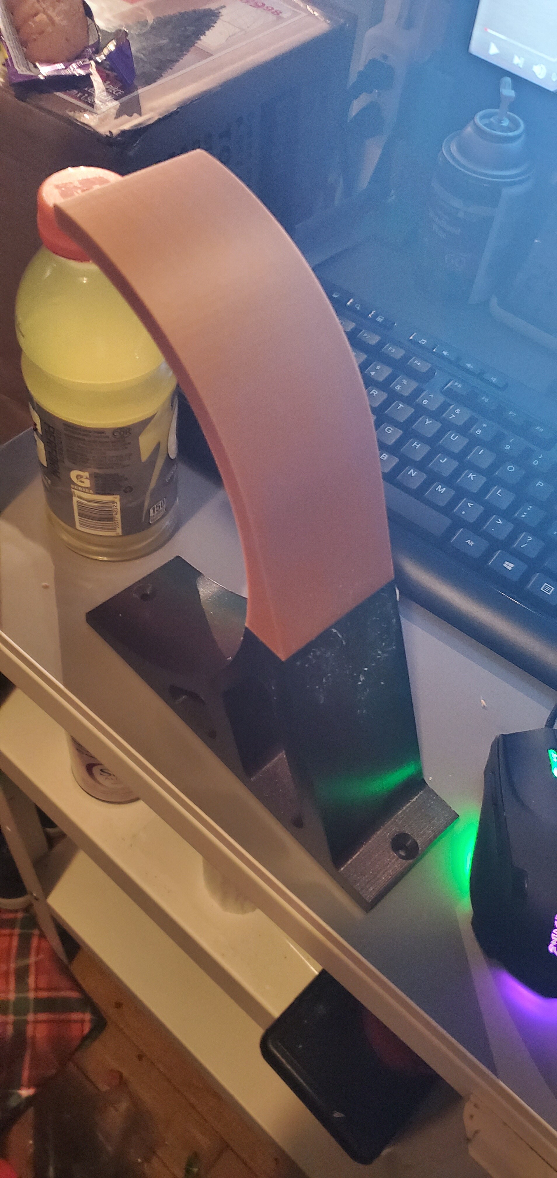

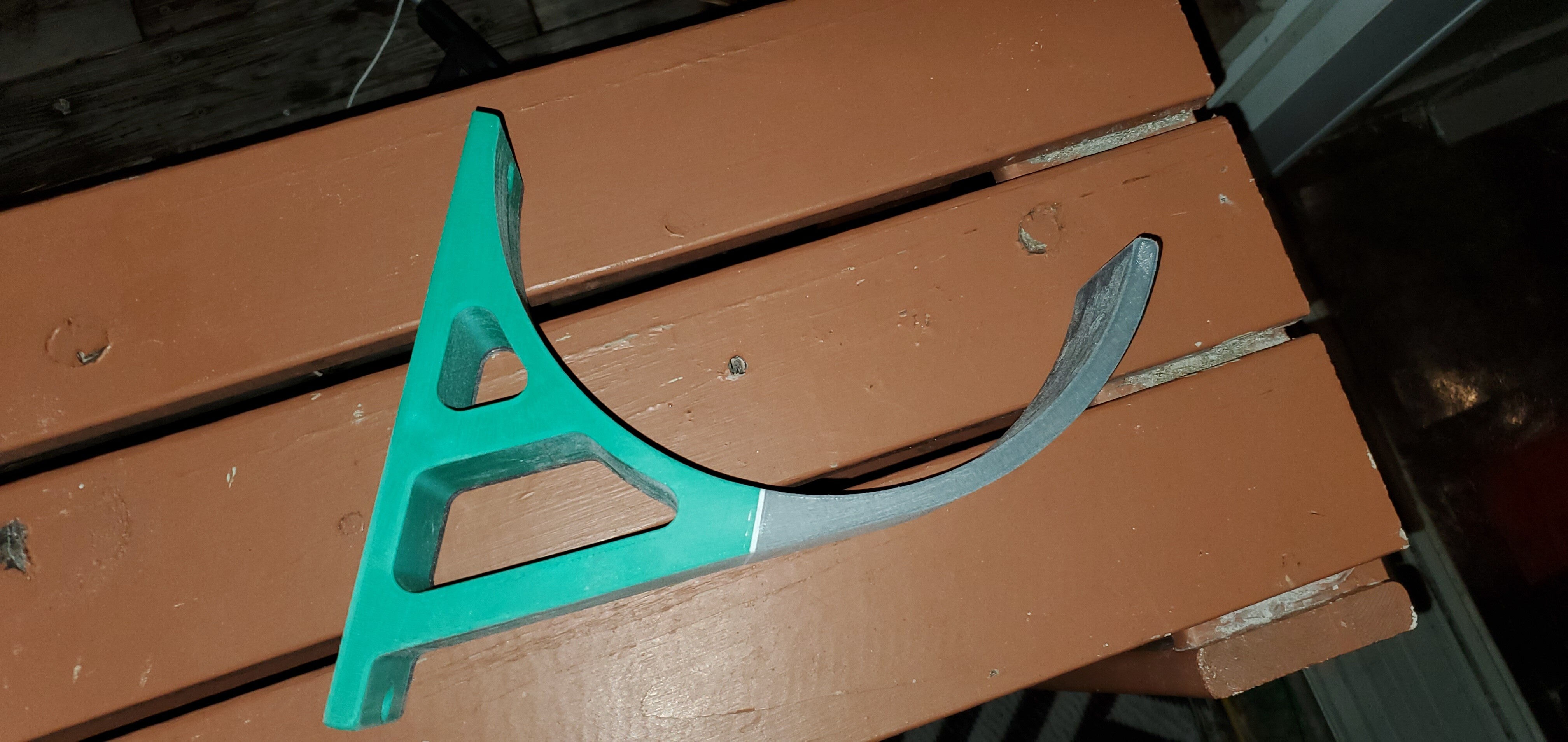

No as in the hook is sideways and needs to go through a small space. Therefore, you can’t add cross brackets to avoid snapping the hook in half
What if you just made them really thick? Or maybe even those bike hooks are an option.
Might as well not have a printer at that point :stuck_out_tongue_closed_eyes:
Just a little idea of finding solutions:
if you have a 3D printer, it doesn‘t mean you have to print all.
P.e. the hook system: you can print the base quite thick and in the print you‘re planning a hexagon and take a screw for the real hookup of the tires. For pretending of scratches you can use shrinkfoil or isolation tape
just an idea and I‘m not saying this is the way it is and I don’t wanna argue about - all easy
It’s all good. I just want it fully printed for my personal pleasure.

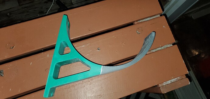

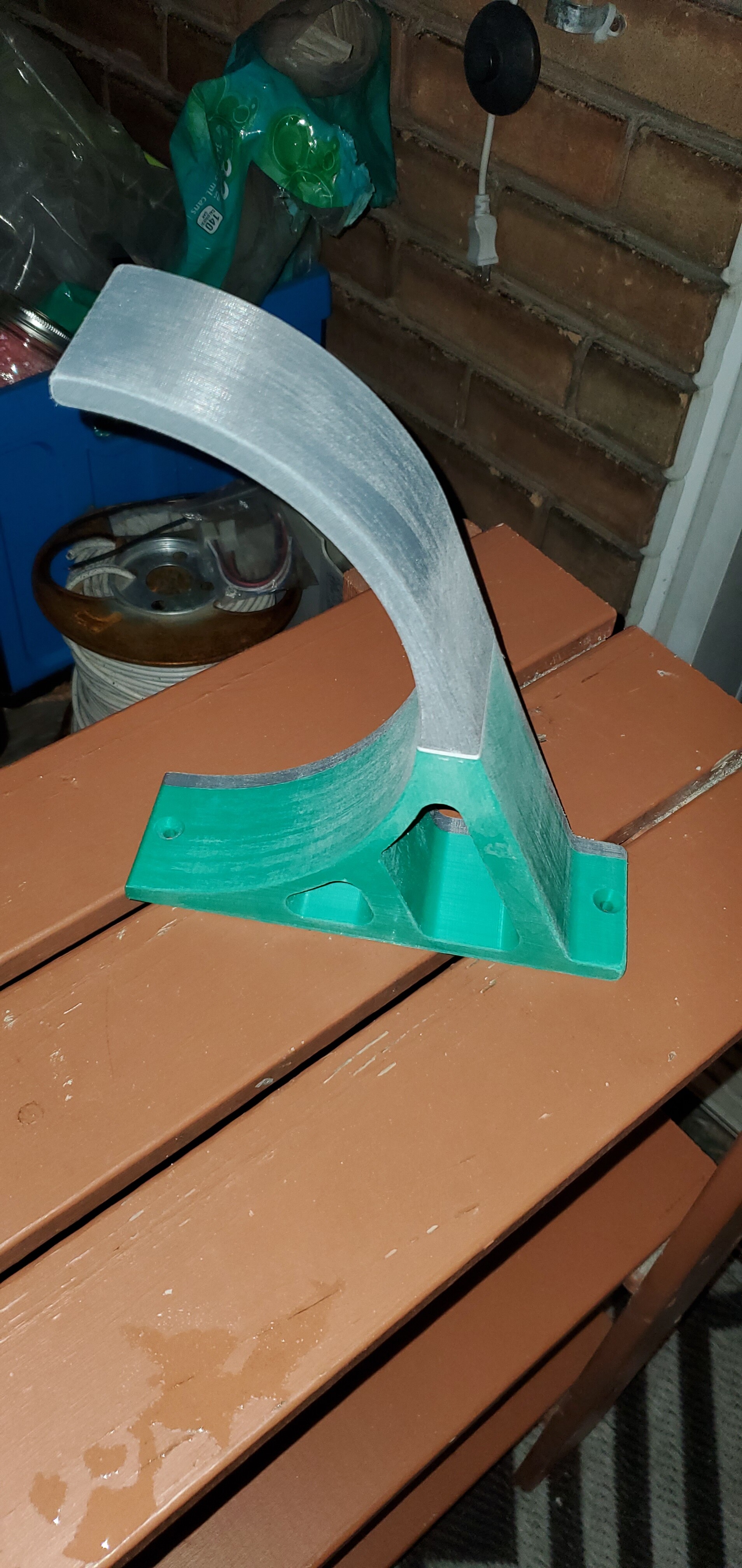

Looks pretty sweet. If that joint ends up being a problem, you could laminate a piece of something high-tensile (like CF or GF etc) on the inside surface to help put the whole joint in compression, rather than 50-50 compression/tension.
You’ve probably already thought of this though. :stuck_out_tongue:
I did yes. But for now my second version seems to wanna work wonders
I can push and pull on it and it doesn’t give
