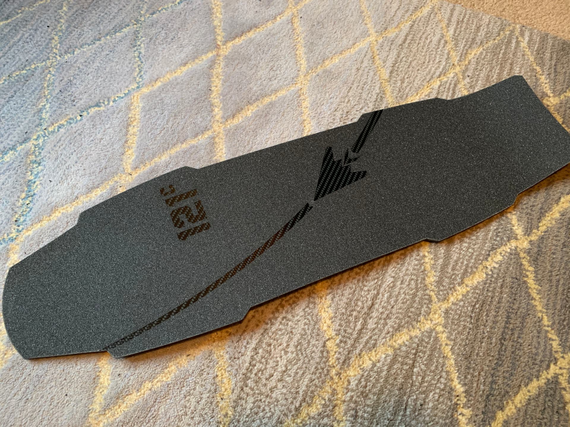

Got the orbiter:
Just if you didn’t know, you may need a special drill bit to drill thru well for the enclosure mounting
I already got some solid carbide bits for it :ok_hand:
