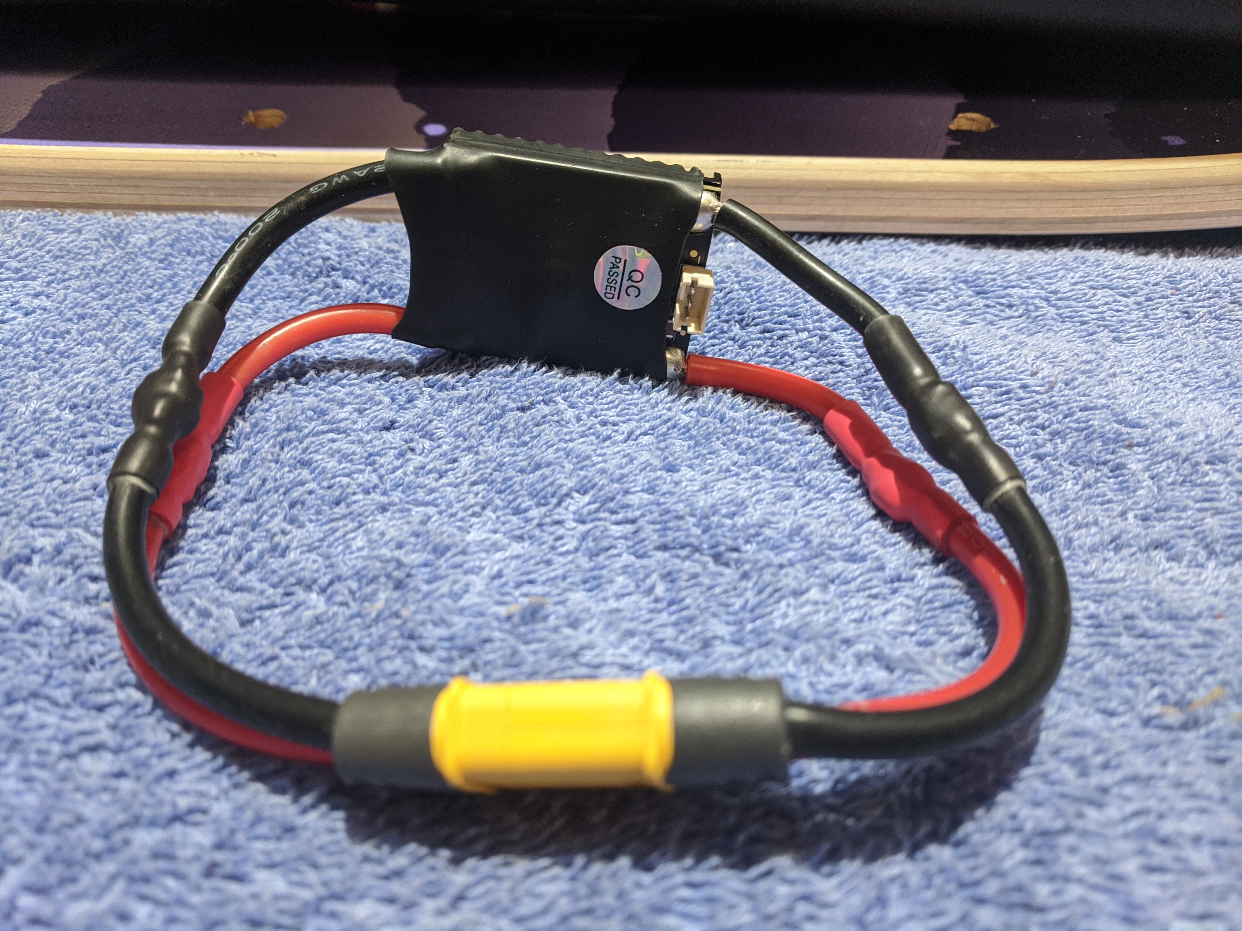

Antispark
This arrived and looks good. I’ve added XT60 connectors to each end, although I may shorten these leads depending on how bad the cable clutter gets.

Fuse the Battery Leads
I realized that in making the battery a removable component that I had failed to protect the pack when it was disconnected with the other hardware in the enclosure. After much research I landed on the BF1 fuses linked to above. The current plan is to integrate this fuse directly into the positive battery lead and then heat shrink for protection. This should give me a pack protected from shorts even when broken down to just the N.E.S.E. modules and the main leads.
For my 12s4p battery I need coverage to at least 50.4v, and these fuses work up to 58v. Additionally, they are available in multiple current ratings which should fit all variety of packs. In looking at the spec sheet I decided to go with 60A fuses since they last for 360,000s (or 100 hours) at 100% duty. Even if I were to hit that peak current every once in a while (I’m not going to run my 30Q cells to more than 15A each) it should give me a very long life. At 200% duty it takes 3s for this to pop, and at 300% duty it pops in 0.3s. So (if I have this spec’d right) this fuse should pop before the Antispark dies down stream and well before the cells hit thermal runaway.
An interesting thought occurred to me here: if you were REALLY paranoid you could use these fuses as replacements to the bus bars in an N.E.S.E. build where each P-group would be fused individually. Since the bus bars are 22mm for 18650 and 26mm for 21700 you would only need a little extra spacing between each P group to tie these fuses in directly.
